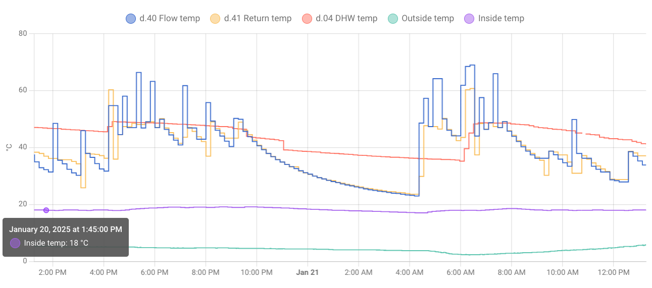

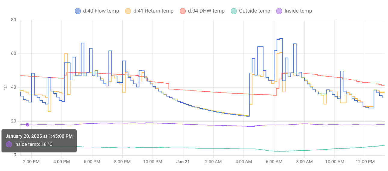

As another reference, I have a 4-bed detached, built around 1986 with a Vailant ecoTEC Plus 418 boiler and Vailant ebus controls (inc weather compensation). Dec 24 my gas usage was 1,393 kWh and so far in Jan it's been 1,264 kWh - The thermostats are set at 18-19c during the day with a setback temp of 17c at night.
The attached shows my boilers flow/return temps along with inside / outside temps in the last 24hrs.
