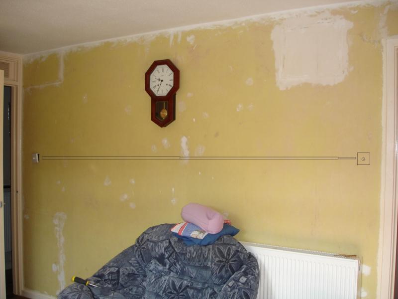

extending my light switch?
regarding "safe zones"...if i channeled out a line straight across to the new switch would this be ok?
i have some round plastic tubeing about 1.5-2cm diam, if i put this in the channel and plastered over it would that be ok?

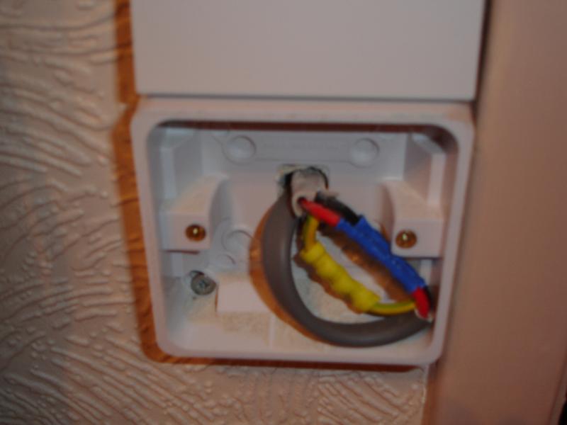

A friend of mine lives in an ex council flat, at some time they must have moved the light switch by the front door (directly into the lounge) as it looks as though the "handing" of the door was changed.
To one side (the original position) is a blanking plate, there is then mini trunking going up to the ceiling following the door frame to the other side to a surface mounted box, it looks awful (correctly installed but just looks wrong). I'm down there next week so will try to get a picture of it.
The door "handing" has been changed back so when the door opens it covers the new switch location. At some point when she gets a new door (another story) if it is handed the same as now I'll sort it all out - subject to fitting in with re-decorating!

That would be allowed.
It would be allowed BUT consider the future when memory of the cable being there has faded.
An electrician MIGHT consider it possible there was cable horizontal between the two switches and avoid the area. But the average handyman/decorator/etc is unlikely consider it possible that there is a cable there, they almost always assume the cables run vertically up or down from the switches. To them only power sockets use horizontal cables.
If you do run it horizontally then leave a permanent note ( with that picture ) at the consumer unit and ensure that anyone who might be needing to drill into that wall is aware of the cable.

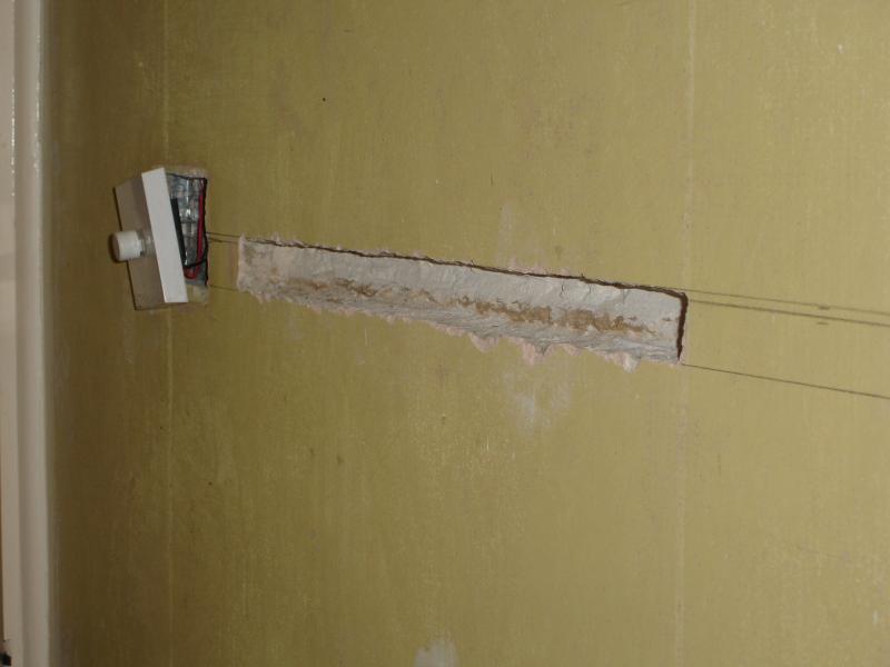

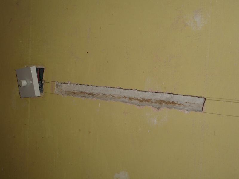

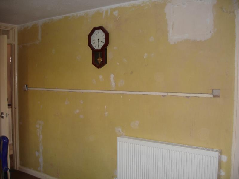

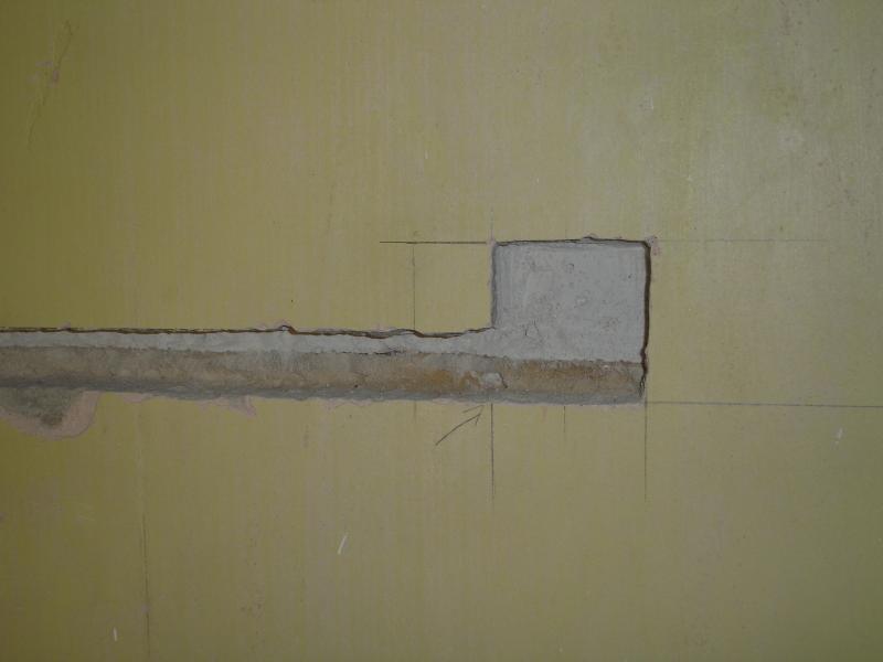

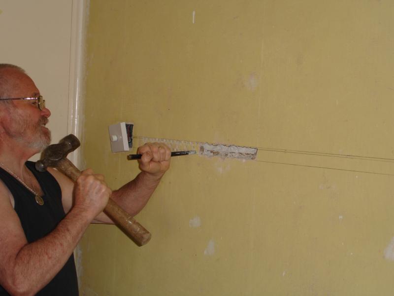

well today we decided to get going on the plan...so we started out by drawing some guide lines, and where the other switch will sit..

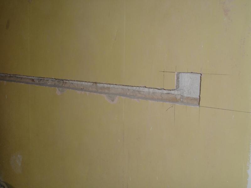

then we drill stiched to a certain depth across the wall and chilsed out the recess..
then did the hole for the new box/switch to about 25-30mm
and then put in the plastic conduit to see if it fitted ( i measured and drew well as it did 8-) )
only thing left to do now is get the back box and wire in the new switch..o and replaster over the plastic conduit.
thats a good idea about putting a picture and a note by the fuse board...might just do that.
Not required, but it won't hurt to heavily score the top of the conduit before plastering over, giving it a better surface to key too
