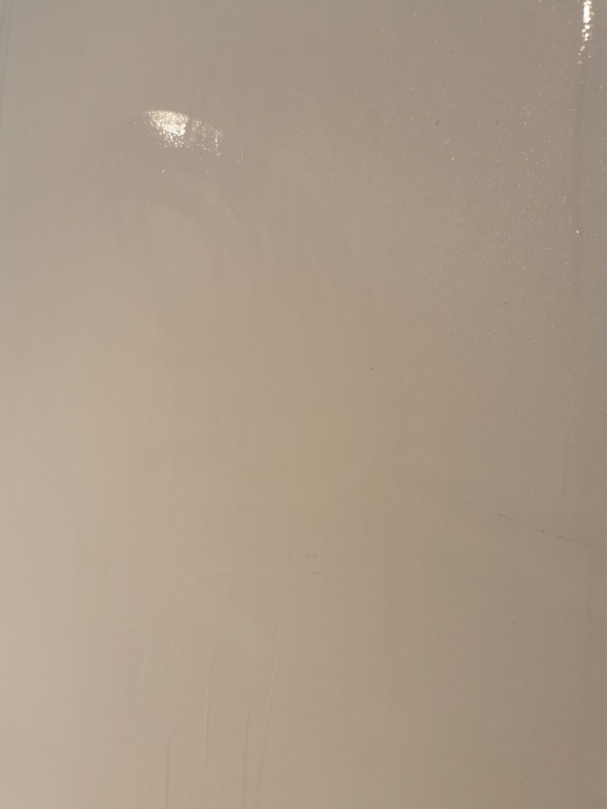

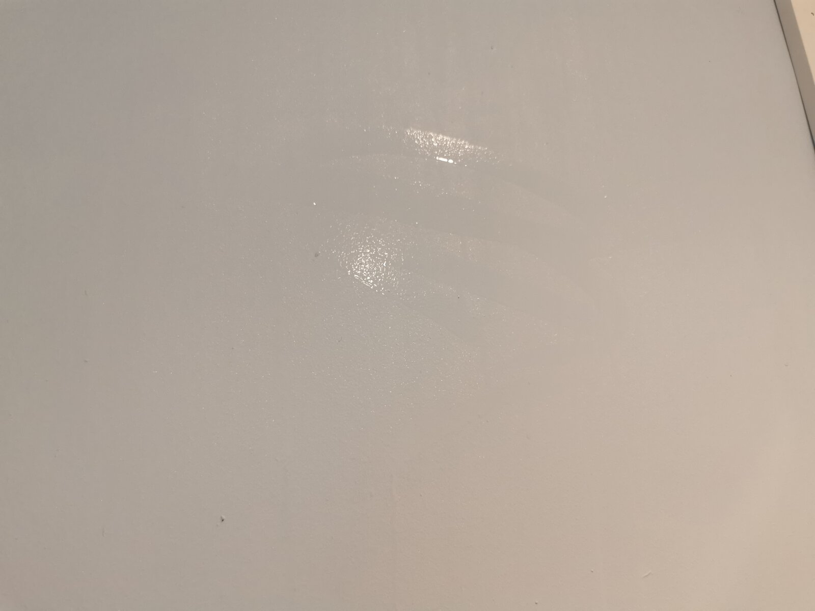

So i spoke the the electrician and said the issues i was having he came back out this morning and went onto the loft and said the ducting was all coiled up and someone had put some insulation over to
So we agreed to have him duct it all outside which he did and showed.me the pics.
Having just had a shower now, i still have eater droplets and a fair amount of condensation on the walls
£500 all up later i dont see any vast improvement on the original fan that was up
Perhaps you have an excessively humid house -
Too little ventilation
Several people and animals
Lots of cooking
Lots of plants
Washing drying indoors
Fish tank

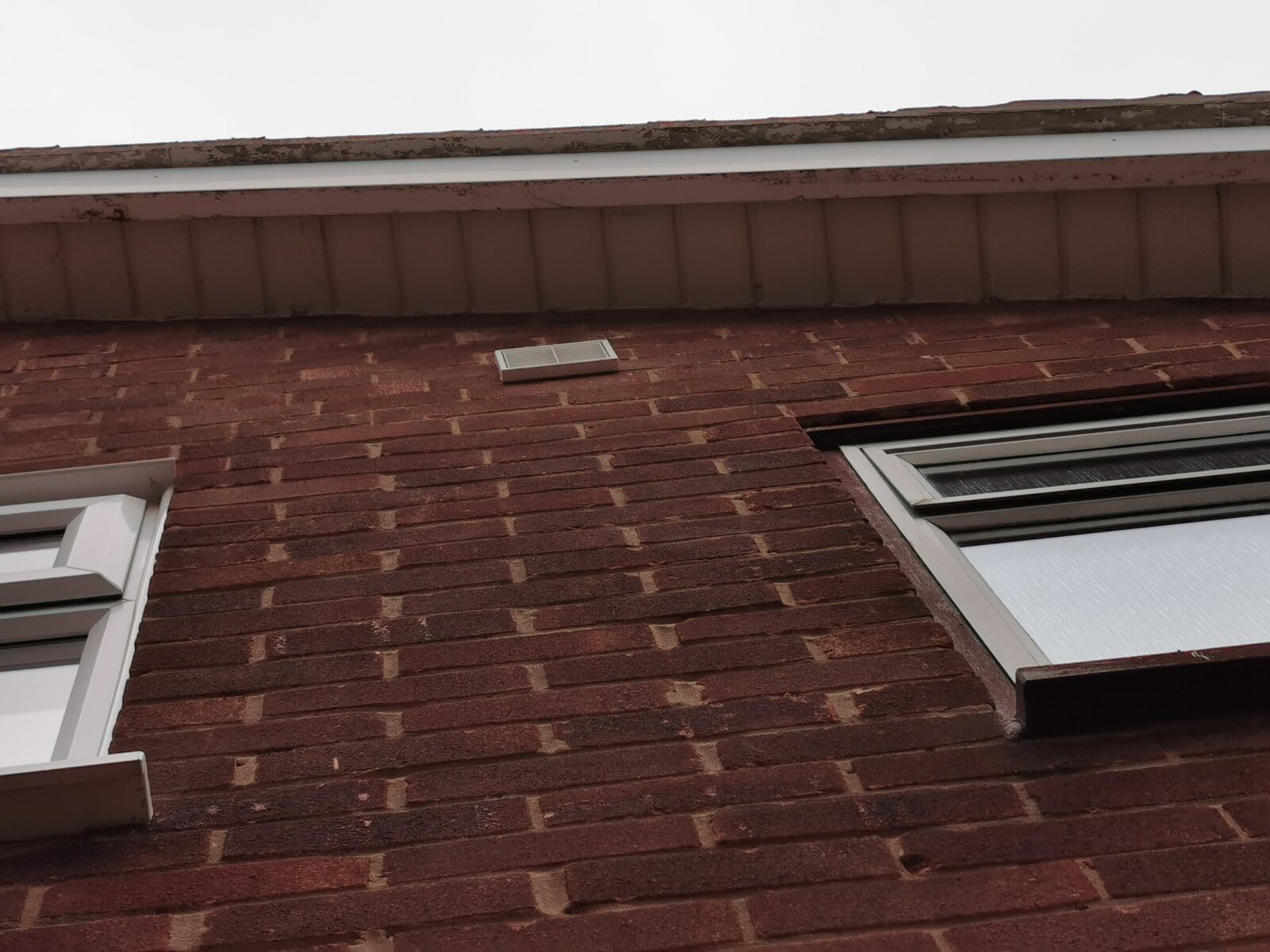

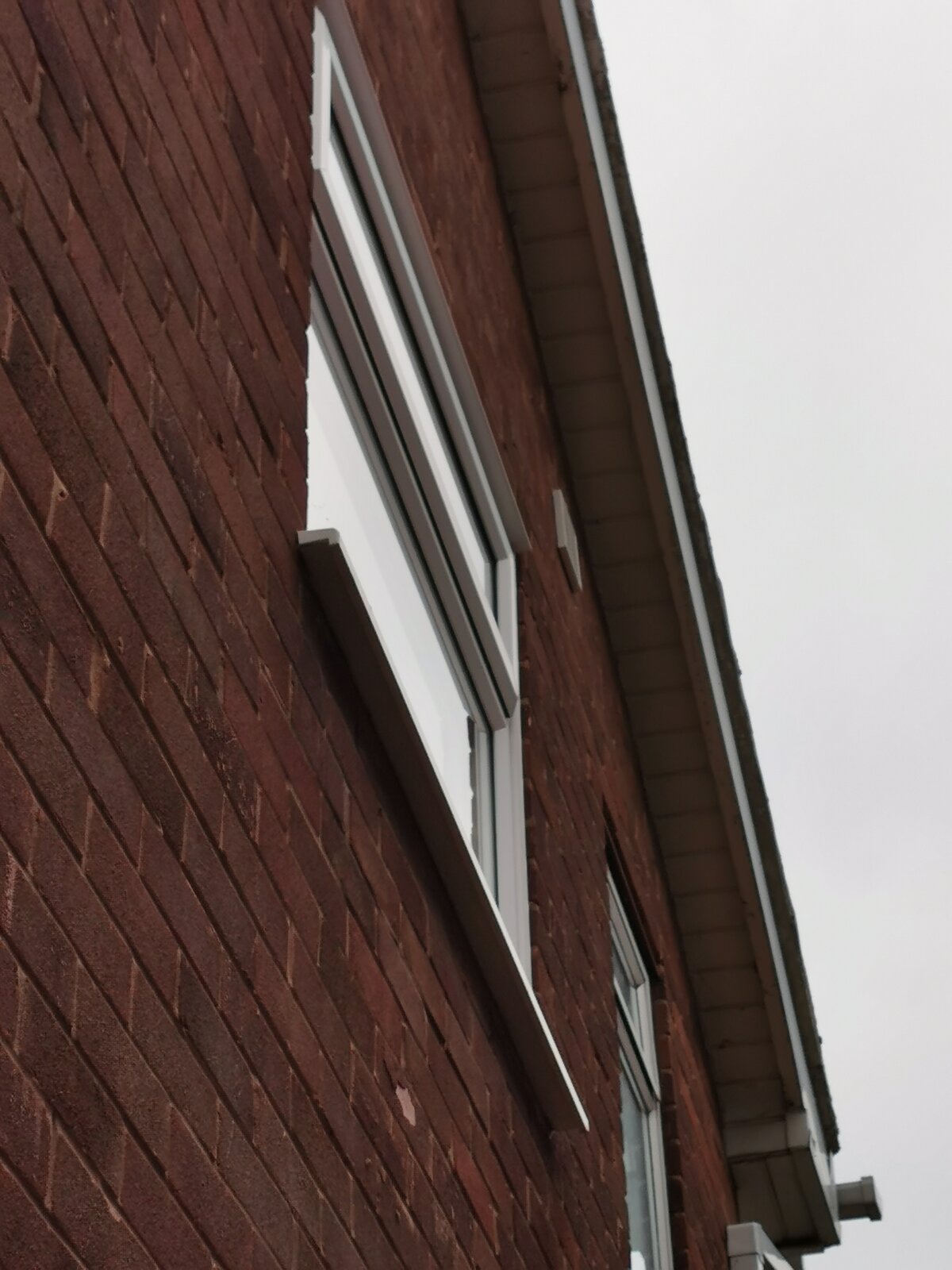

So had a look outside, i can see this vent in the pic attached
Regards to the house theres no plants, animals, 3 people live here (1 baby, 2 adults) we have a dehumidier running downstairs for our laundry
I cant get into the loft at the moment but ill try take a pic later of what i can see
There did seem to be less steam while showering, but still water droplets on the fan itself still
well that's interesting
it appears to be a vent cored through the wall, not poked through the eaves
which is good
though I can't see the flaps being pushed open by airflow (looking again I think it is a plain grille, which is OK). Was the wind blowing towards that wall?

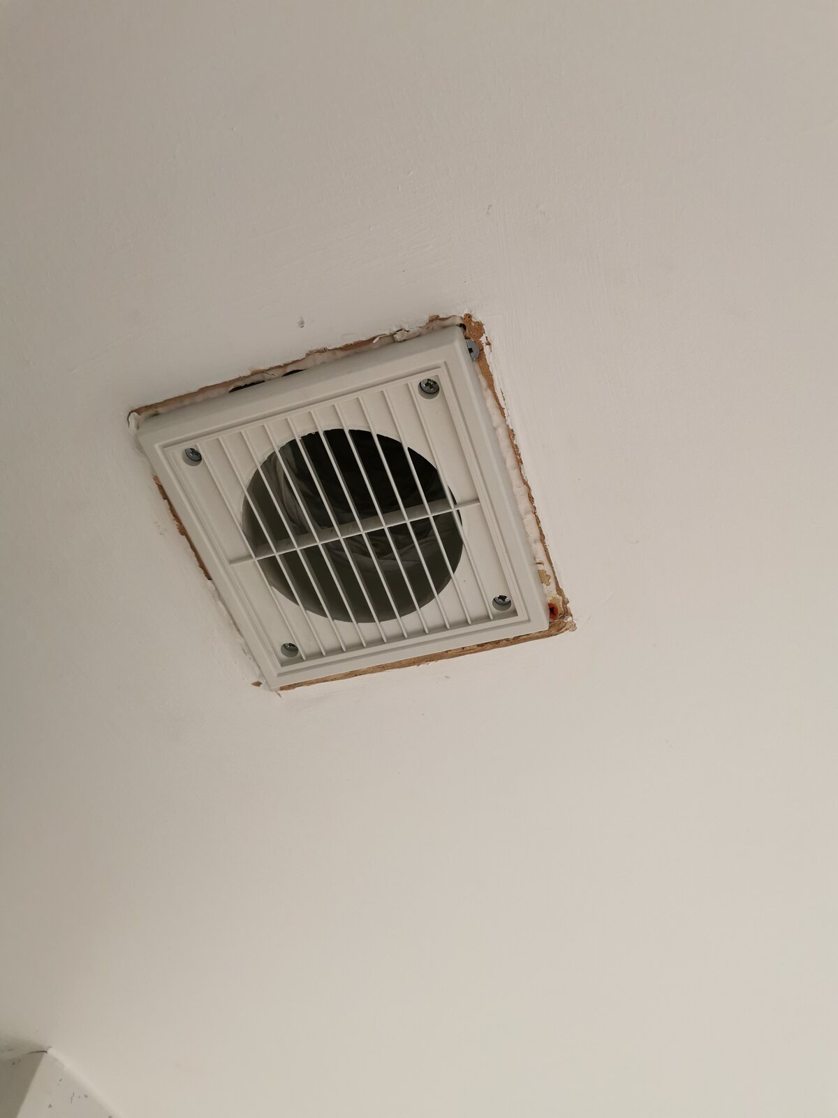

I emailed him after my shower and showed him the water on the fan again and the walls that were wet still
To his credit, he came out for the 3rd time today after that and installed an Inline fan, which he said is industrial strength. Free.of charge and replaced the last one he fitted
So will find out tomorrow when the bathrooms in use as to how that goes but it does seem more powerful and its set on fast speed so fingers crossed it will solve the issue have attached photo if it helps
