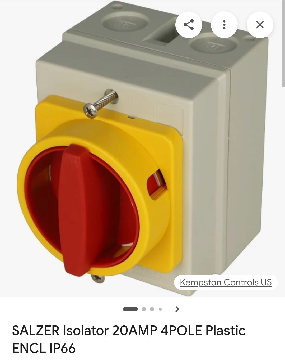

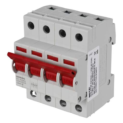

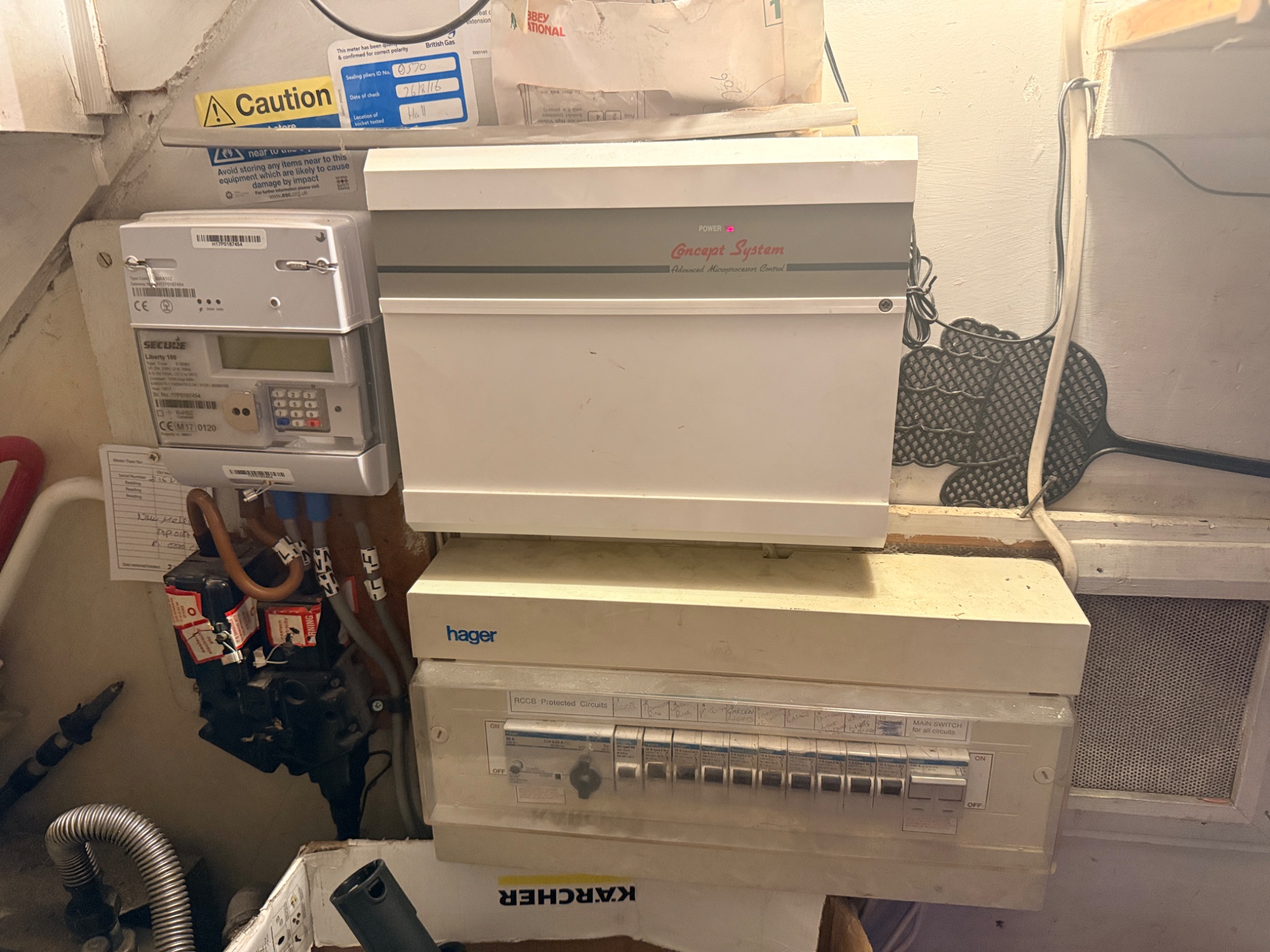

Fitting an isolator between meter and consumer unit.
Or this seems to be a switch.
Can anyone see any advantage in requiring an isolator to be encased in metal, when it is fitted alongside a plastic meter and a plastic service head all connected together by wires encased in plastic?
