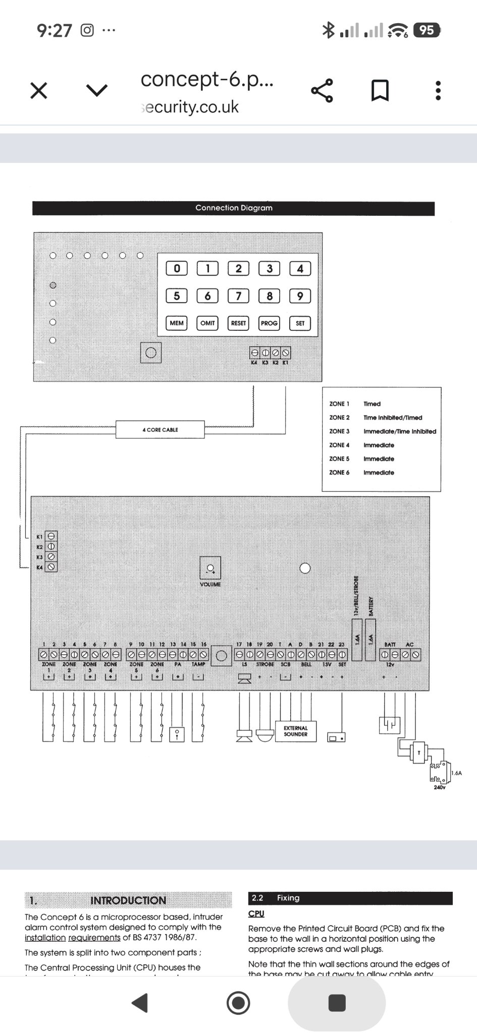

Instead of the now usual 6 core cable linking the panel to the keypad, this early system needed a 12 core.

I fitted that when we moved in here in 1990. Never given me any trouble apart from changing the battery 2 or 3 times! I have 4 x 4 cores going to the keypad.
I think the Concept was a model they were learning on WRT the keypad connection. You say yours had 16 cores, mine had 12.
But the instructions for this one has 4 cores, which is odd because as I understand it, latter day systems use 6: 2 for power, 2 for comms and 2 for tamper.
