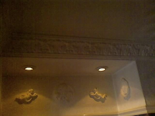

Fitting recessed downlights to some form of panel, help pls
The frame aprox 10ft x 2 ft would fix to the main joists supporting the roof.
The board 11 ft x 3ft would then fixed to that after , unless the roof joists are very thin the weight would be distributed.
The board would Overhang by 6inches all round
with a drop of about 2 inches from the ceiling

What i was trying to say, was fix a 4x2 wood frame securely to the ceiling,
as you said you did not want much of a drop, it will be 2inches.
Your board fits directly to that with enough screws to be secure.
This creates a false celing but with the overhang will make it look more of a feature
Providing you work within the frame size, you could cut the ceiling to locate the joists or fit the noggings as required once the frame is secure reinstate any holes to the same integrity of the old ceiling.
This will not be visible once the board is fitted to the frame , but should be done.
All the wires and lights will be contained then within that false box ceiling.

I did not want to cut my ceiling so i lowered a section just to fit the lights.
Rocky, so basically what I would be doing is building a frame out of 4x2 timbers which needs to be approx 6 inch shorter on each side in comparrison to the panel i need to hang up.
I fix the frame as best as I can even though I have no exact knowledge of the joists or noggings
Once i get the frame up I can cut appropriate hole(s) to establish where the joists and noggings are which will give me the ability to strengthen the frame further
Following this I fix the panel to the frame, cut the appropriate holes out (which can be done before fixing the panel up) and do the rest

Just one of many ways proberly.
What is suitable you need to decide as you are doing the work.
I can only give you ideas to consider.
The main thing is that it is structurally safe and secure and the fire and acoustic rating of the existing ceiling is not impaired.
Over a 10 foot length there is likely to be good fixings somewhere.
Using hooks and chain there is unlikely to be a good fixing where you need it to be.
As you know roughly where you want the board, you could cut an access to see what is above.
There must be something that the existing is fixed too.
What is up there may determine how big the support frame needs to be, as you need to fix that too it.
If the joists are 2 foot centres , then the frame would be 2 foot wide to fix to it, if the joists go the other way, then you should get at least 4 good fixings over a 10 foot length.
If the board overhangs the frame enough, then due to the height and only a 2 inch gap you proberly would not see the frame finish.
If you did then You could use a beading on it and paint it to make it neater.
Your fittings may require more room above due to the heat that you must decide.
Most of the ones we do in shops are dropped about 12 inches so there is not so much a problem with the heat,the ceilings are some 15 foot high though.
You seem unsure so it may be best to get advise on site from someone who can see the work .
A carpenter would advise you better, or make and install it for you.
Why not try here for some ideas. http://www.diynot.com/forums/viewforum.php?f=14
Most shopfitters and joiners have done similar I would have thought.
As for fixing the board, it depends on the finish you want, if painted then recess the screws ,fill and sand down.
