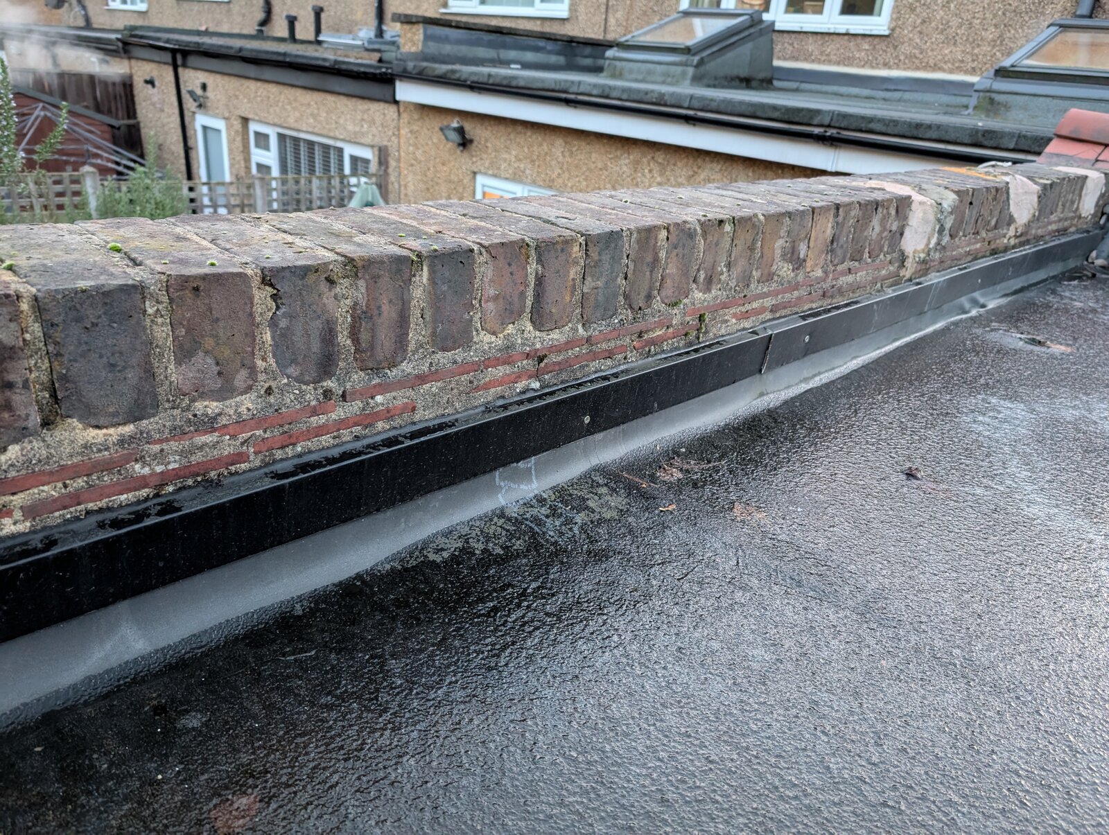

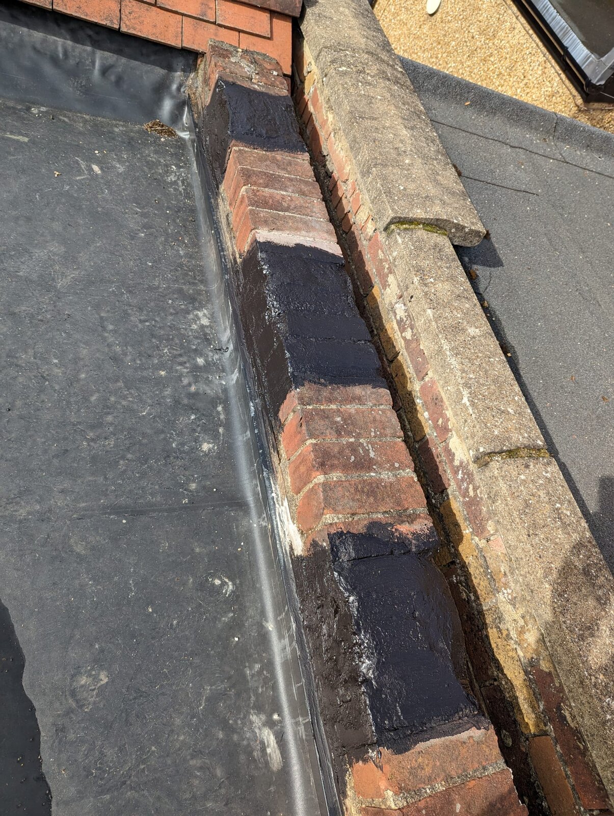

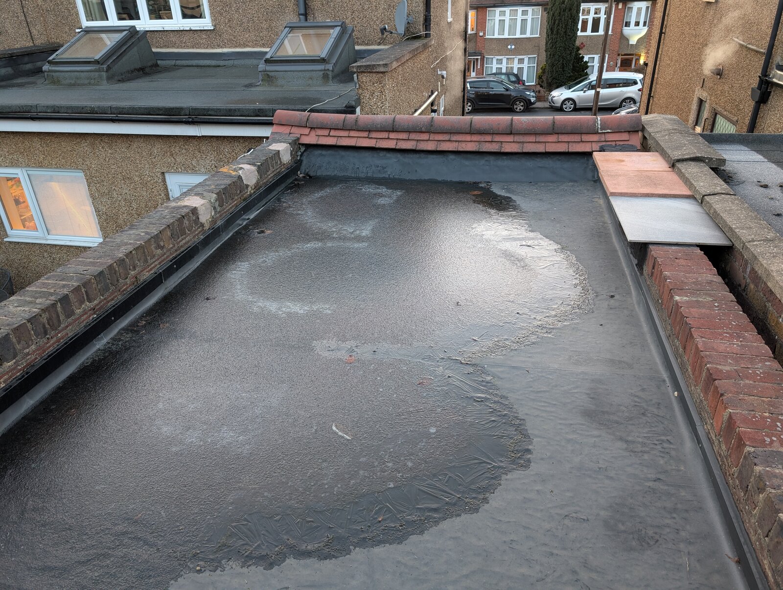

My garage has been leaking for a number of years after some roofers put on a rubber membrane layer on the existing chip board and then refused to rectify the problem when it was pointed out it was leaking and walked off the job.

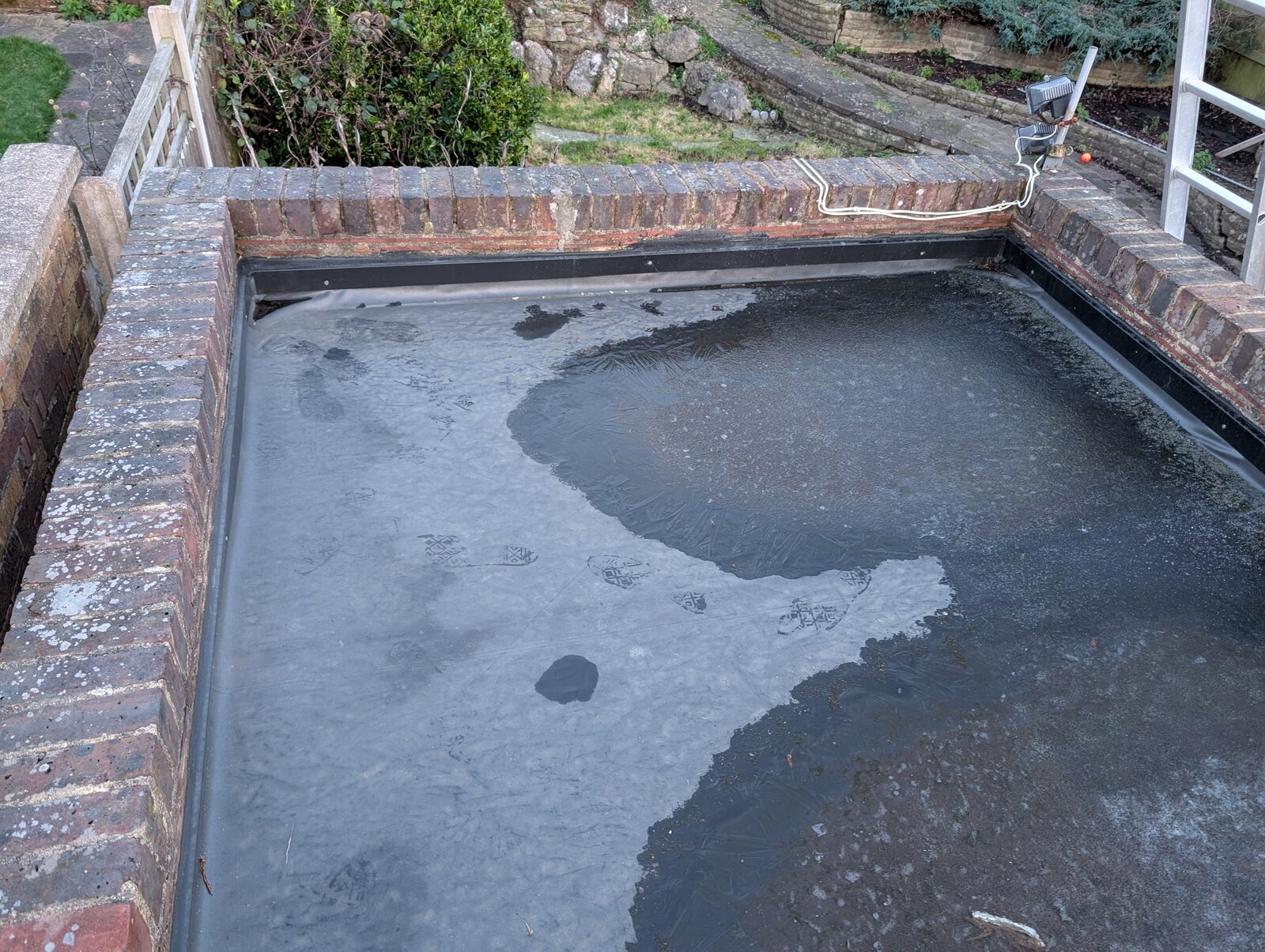

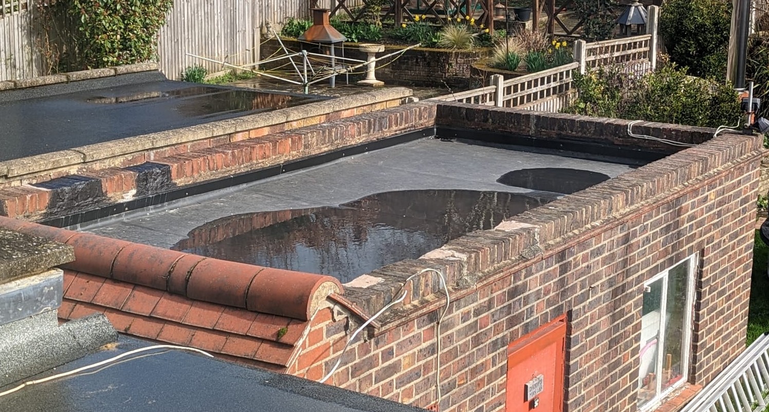

I've only now discovered where its leaking from, which appears to be where the rubber membrane goes horizontally up the roof and is screwed to the walls that rise up above the roof. I've attached a photo that shows the roof, it also pools water in the middle as the roofers didn't slope it towards the gutter.
I've attached a photo showing the membrane going up the wall forgive the black stripes, that was where I painted the wall with bitumen as I was told the wall might be porous and letting in water.

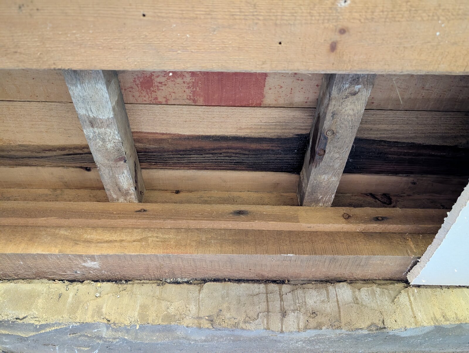

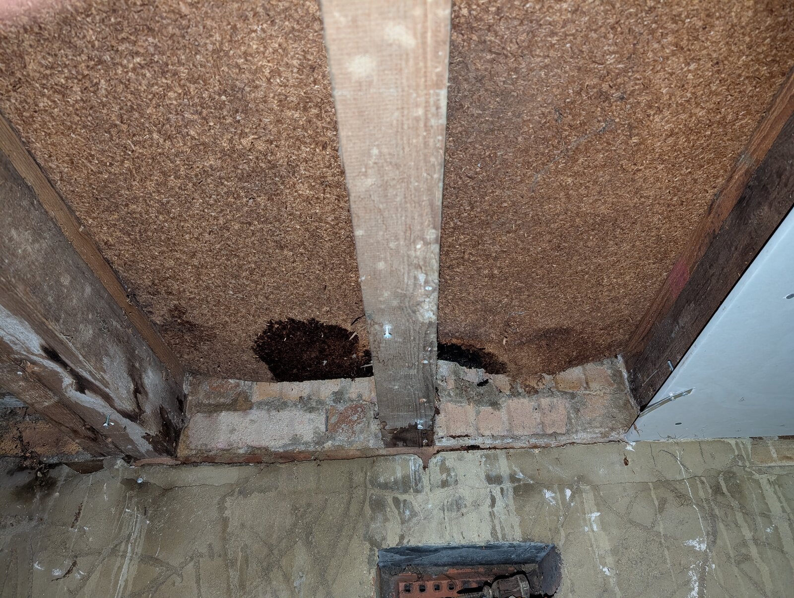

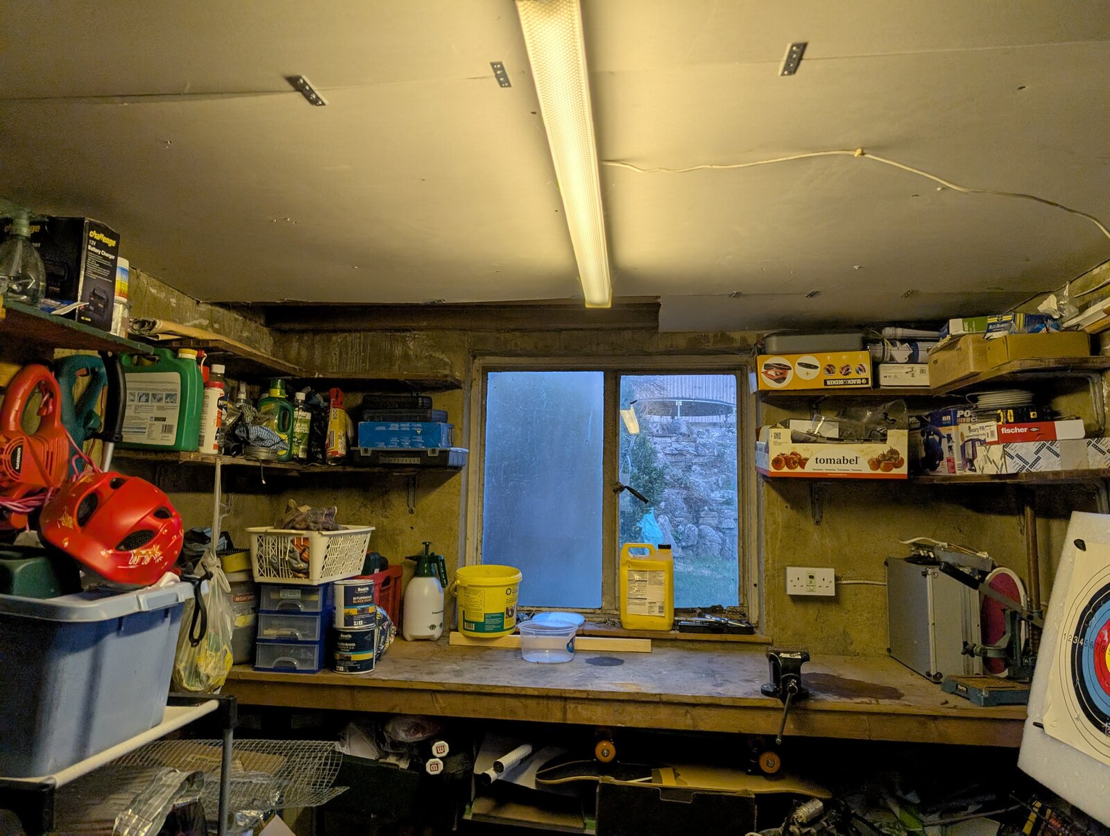

I've attached a few photos where I've removed the ceiling and you can see the water leaking in through the chipboard and wooden beams.

Some truly baffling details there. That small parapet wall should not be merging with the small faux pitched roof roof like that. And I cant see a (lead) cover flashing anywhere.
Anything is repairable, but getting it to last may be an issue there, given the way the walls and roof are thoughtlessly cobbled together.
So, looking at that first photo - is the water ingress, along that far wall, where you have painted the blackstruff, or where the standing water has collected, near the camera position?

The water ingress is along all the edges of the roof and seems to be directly below the rubber membrane section that buttes up against the parapet walls. The worst section was the bit that's painted. But it's also now really bad along the far end (not the section with the silly tiled pitched roof). These two bits are the sections I've photographed from the inside and show water on the boards.
I've been thinking a good way to test this theory would be to cover these sections. I have some concrete paving slabs that I'm going to rest at a 45 degree angle over the worst sections along with a tarp and see what happens when it rains.
I'll try and get some better photos but its night here ATM.
The standing water might be a red herring.

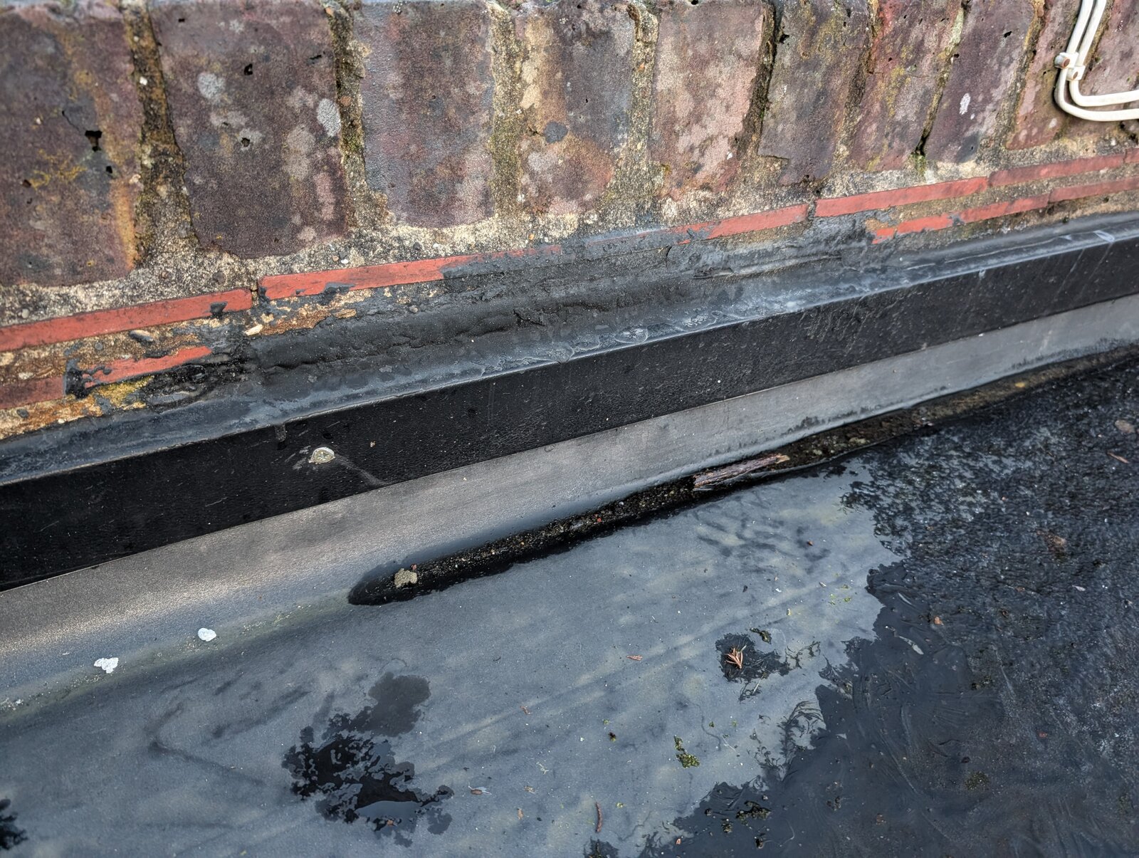

What's the detailing where the membrane goes up the wall, from the photo that looks like flashband over the joint (or is it lead?)
If this hasn't been chased into the wall then that's the most likely culprit.
I know someone who had a similar problem, the whole brickwork parapet was covered with roofing felt, which solved the problem but looked crap.

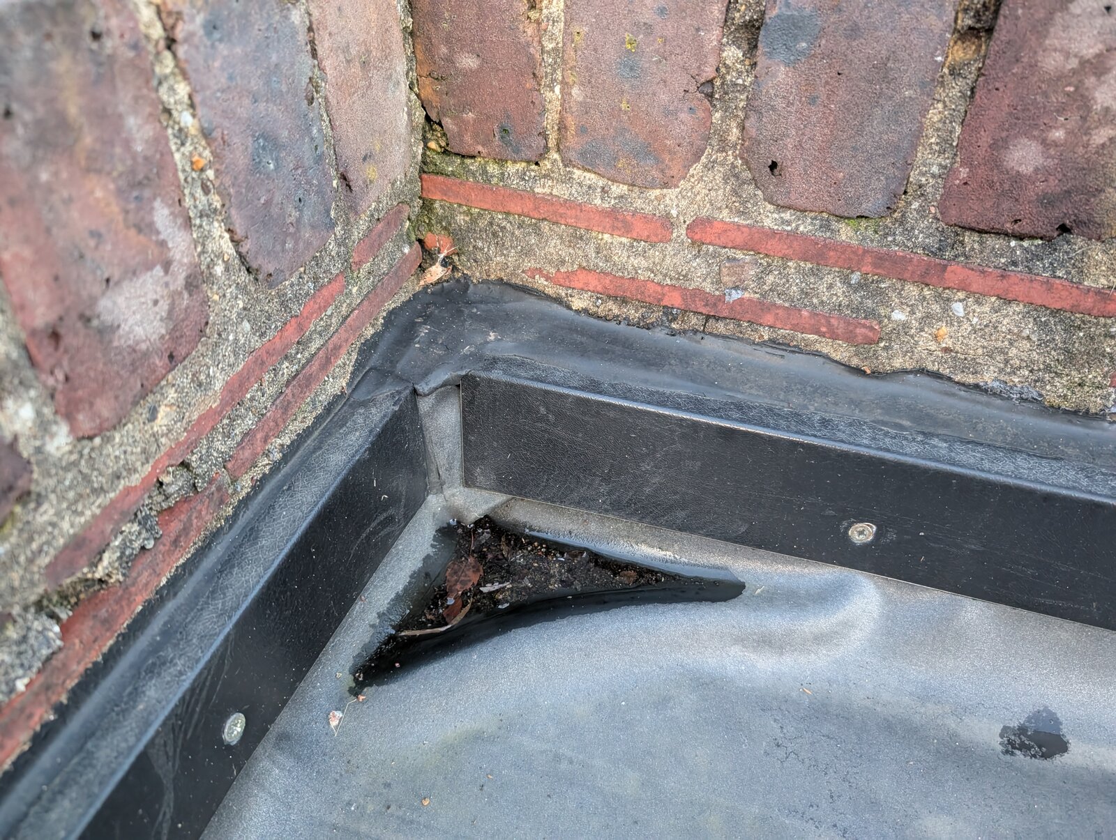

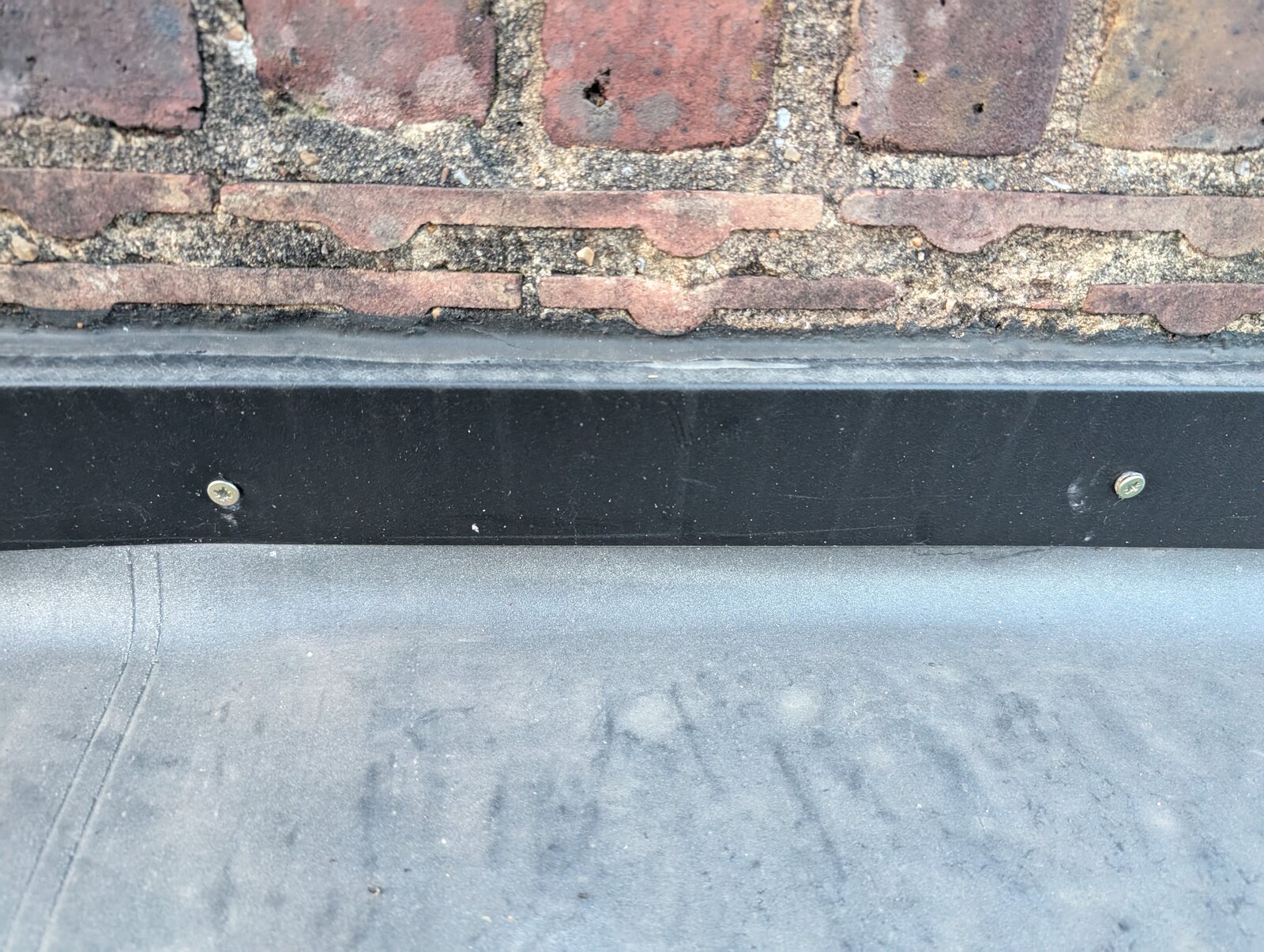

Its a bit of plastic boxing that the membrane goes into and then it's screwed to the wall. I've attached some photos of it, including corner sections which are wrinkled.

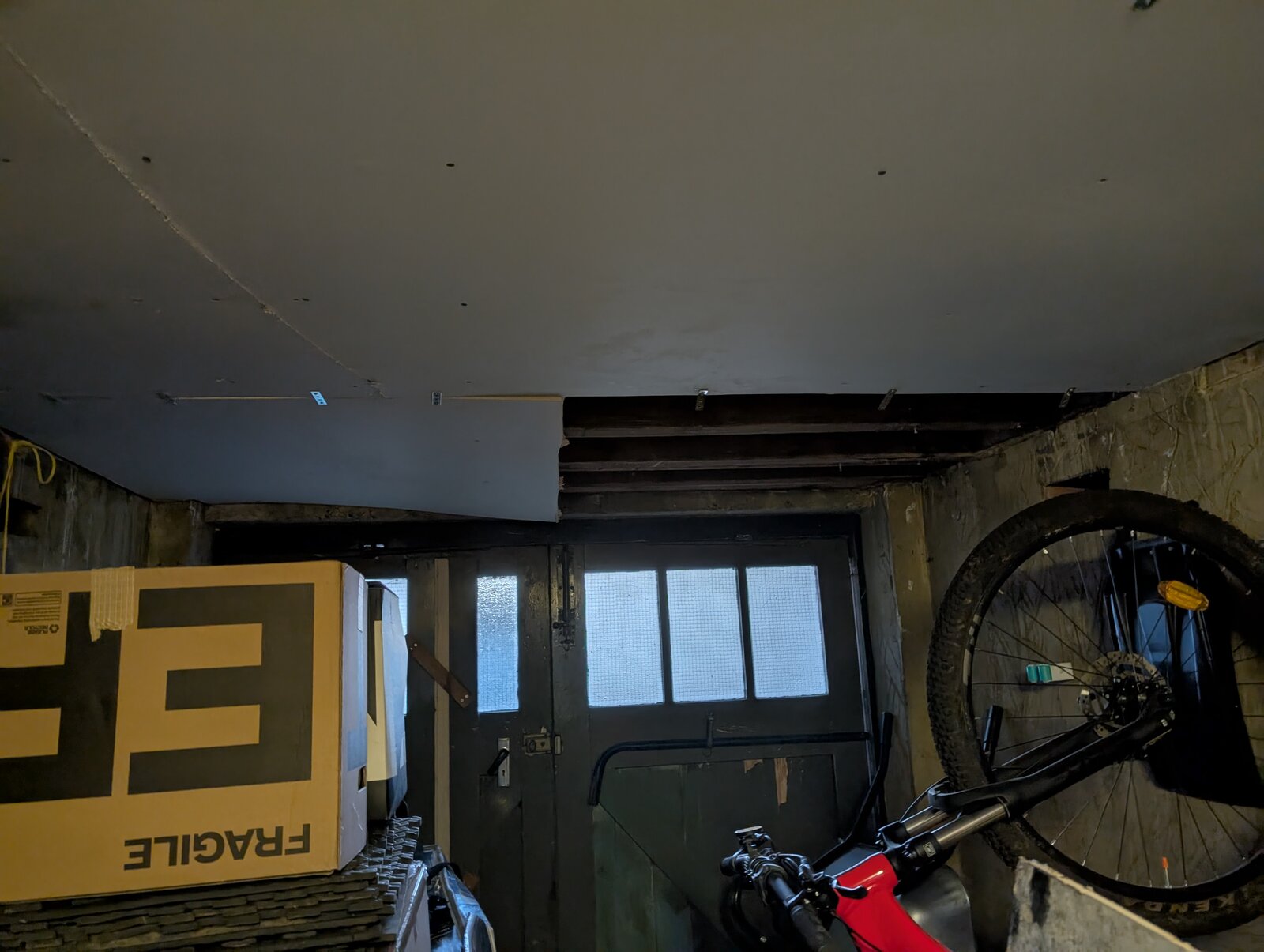

I've also put a couple of photos of the exterior and interior of the garage as someone was saying they were having trouble making it out.

I would start by unscrewing and taking off one of those trims and seeing what has been done
the only way to reliably weather seal an abutment to a vertical wall is with some form of flashing cut into the wall -normally lead flash of some sort
Parapet walls are difficult to detail as you have brickwork above that is external and fully exposed to the weather which then becomes an internal wall -however for a garage a proper flashing should be enough to stop rain, it might not stop a bit of damp though.
I would support Deluks suggestion, of water soaking down the parapet wall top. An easy test, would be a long, narrow strip of waterproof material, add some tied on weights to keep it in place, and put it over the top of the wall, so it sheds water directly onto the roof, keeping the wall dry.
Needs some angle flashing trim chasing 25mm into the wall below the creasing tiles and sealing in place with lead mate. You can get a 40mm x 100mm that might span over the incorrectly used trim, if not deep enough trim the long edge to the correct depth and use the wrong way round. You'll need a 9" grinder

Unfortunately every time I sweep the water off the roof it just collects again, as the morons who put the rubber membrane down didn't slope the roof towards the gutter. It was sloped before they did the work but they somehow removed the pitch.
I might try and put shims under some of the support beams on the inside to add the pitch back, but I want to get the garage water tight first.

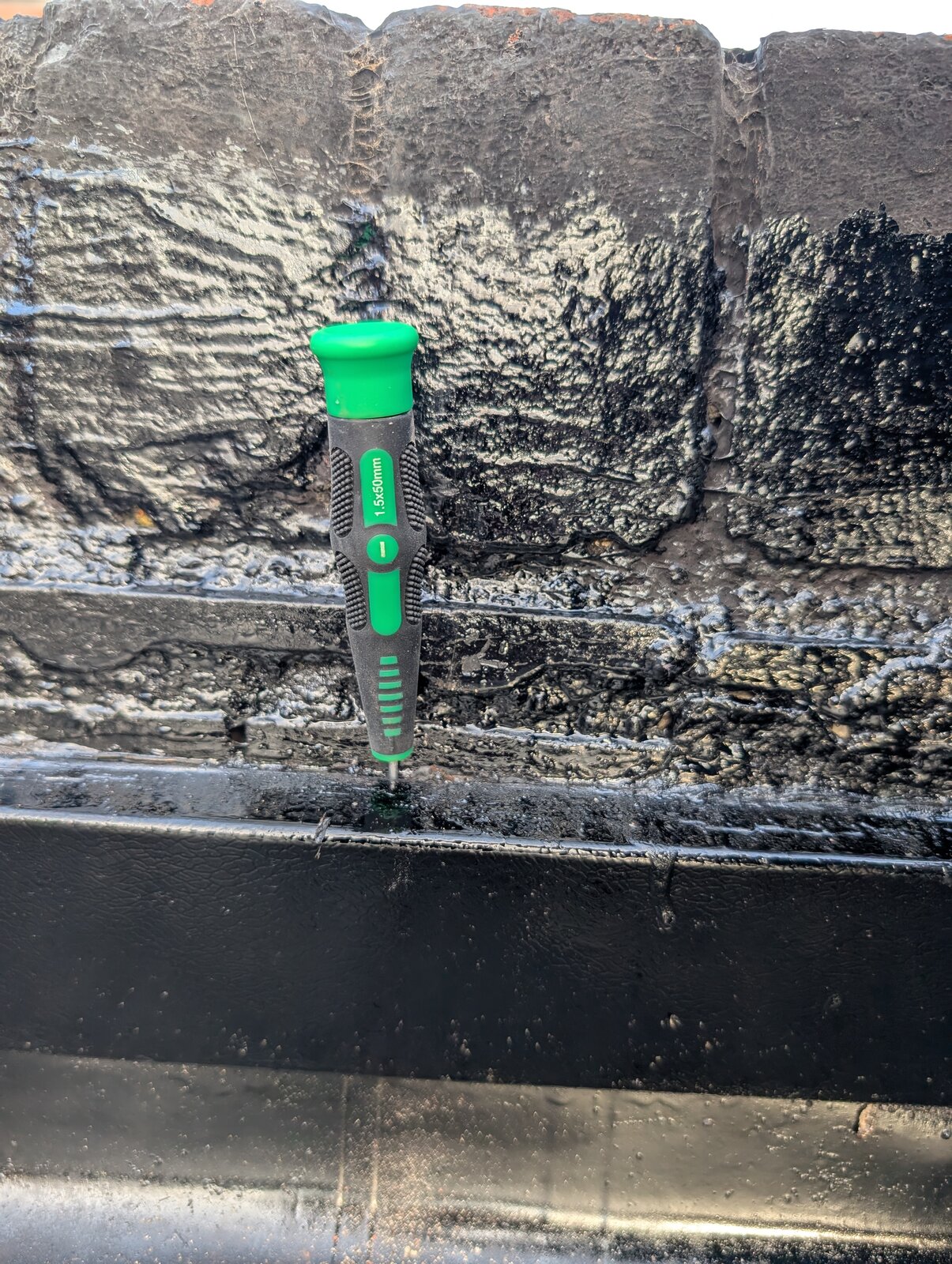

As an update I got onto the roof yesterday as the ice had finally started to break up. I decided to check the work done. I got a screw driver and pushed it down the back of the boxing and there was no resistance and the screw driver came out the bottom. So nothing has been chased into the wall.
Now I have two option:
Do with flash band and an angle grinder (need to get hold of an angle grinder).
Or just stick some flash band over the top and then paint over it with a polyurethane rubber paint.
Here's a photo showing the boxing and a screw driver pushed down the back of it. You can't see the end sticking out but it pretty much is touching it.
