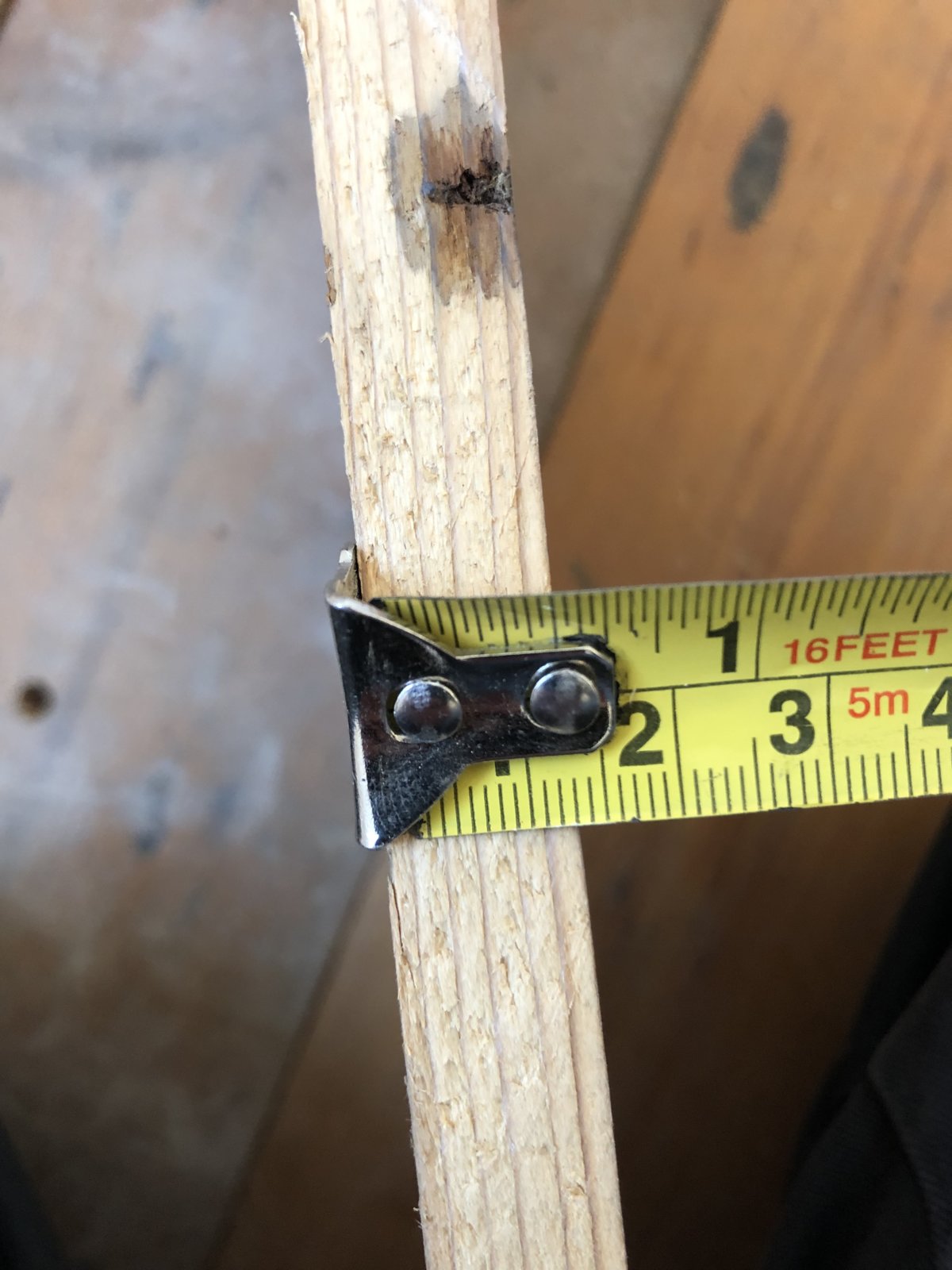

Hiya,

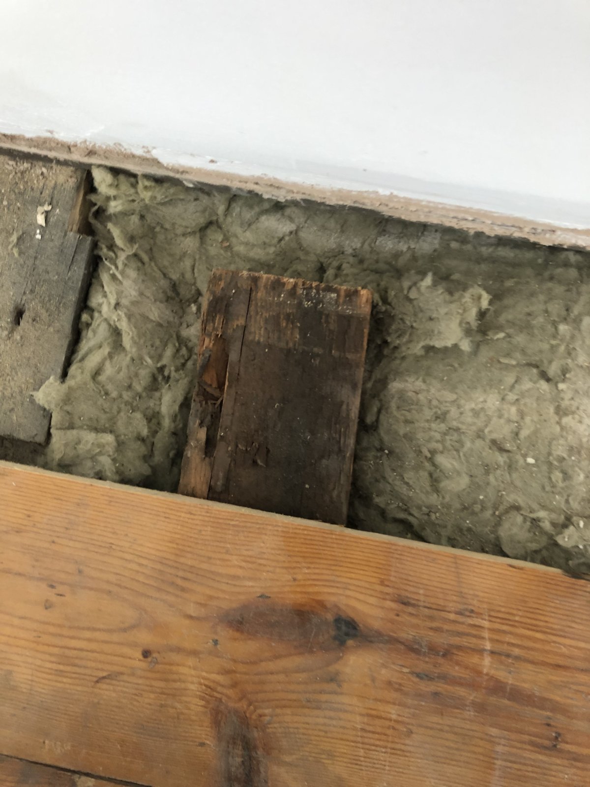

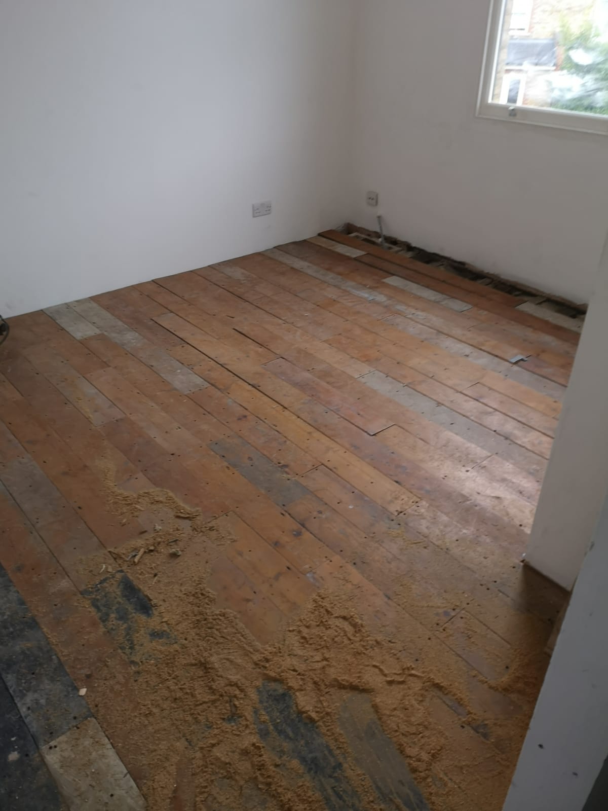

Just looking for a second opinion, have a floor expert renewing our 100 year old floorboards, across a few rooms in 1st floor of our house. taking them up, repairing and relaying and then they will be sanded down. All going well but a lot of the old boards were split and so they’ve supplied a bunch of reclaimed boards to use on one bedroom. Popped around today and some boards are not screwed down yet and I lifted couple up and noticed that some of the thicknesses are only 13-15mm. They’ve also laid some old timbers across rock wool insulation which I guess is to add a bit of support but the insulation is suspended on chicken wire and there will be downlights below. It seems a bit suspect to me but would love a second opinion. If the boards were 18mm or 20mm like the original ones then they should be fine spanning the 500-600mm gap between joists. On e sanded down 13mm will become 11-12mm. Thanks in advance . Ps al the boards in this backroom photo are ones they supplied.

Re-post it in a more appropriate forum but I wouldn't have boards that thin. 13mm is only good enough for cladding/furniture making IMHO, 600mm is a large span.
I guess they've found some reclaimed boards that are in such poor condition they've gone through the planer/thicknesser several times too many.
13mm is no good for a structural floor on 450mm centre joists.
it needs 20mm
also, might be more sensible to have them sanded before laying them - that will create a lot of dust.
I ordered new 20mm boards from my local timber merchants where I wasn't changing the whole floor. Obviously they don't look rustic, but they're under carpets in my house.

If that 13 mm "board" is one of the re-claimed pieces of timber then reject it. It is plywood and if cut into plank sizes then it is totally un-suitable for flooring.
OP,
as above, the section size of 13mm is ridiculous.

the odd blocks of free floating wood are useless, they support nothing.

good call bernardgreen - in section it sure looks like ply. and the nail head stains are too deep to be sanded out.
