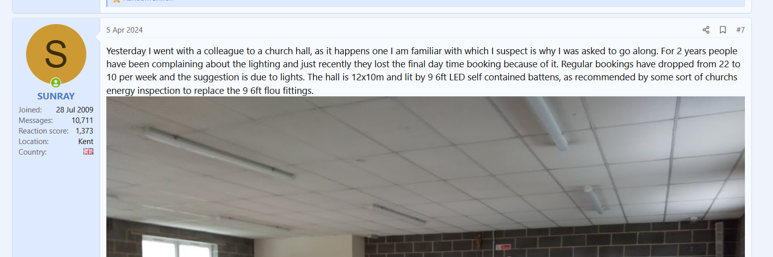

Try telling that to the owners of this church hall who lost all of their weekday daytime bookings:And 1850LM (Lumens ?) doesn't seem very bright although I have to admit I am totally out of my depth at tis stage !!!
It isn't.
It isn't.

Telling what - that 1850 lumens is not a replacement for a 6ft fluorescent tube?Try telling that to the owners of this church hall
Sadly I don't have any pre LED photos but the 9 6ft Fluo fittings were replaced with 9 1500mm LED integral fittings in exactly the same locations, the original screw holes in the ceiling grid have been covered with the new fittings, equally as sadly I can't find any makers name or model numbers on the new fittings but I can advise my 400A clamp meter with 100mA resolution shows 0.6A for each of the 3 circuits (I assume meaning 0.55 to 0.65/126 to 149W/42 to 50W each.Telling what - that 1850 lumens is not a replacement for a 6ft fluorescent tube?
If single 6ft fluorescents were to be replaced in the exact same locations with the same style of fixture, all of which assumes the original lighting design was correct and actually existed, then this https://www.toolstation.com/integral-led-lightspan-ip20-ik08-batten/p21780 would be a probable replacement, 5200 lumens.
If the lighting in that building is useless, it's entirely the fault of those who specified inappropriate fittings.
The fact they are LED or any other type of lighting is unrelated.
