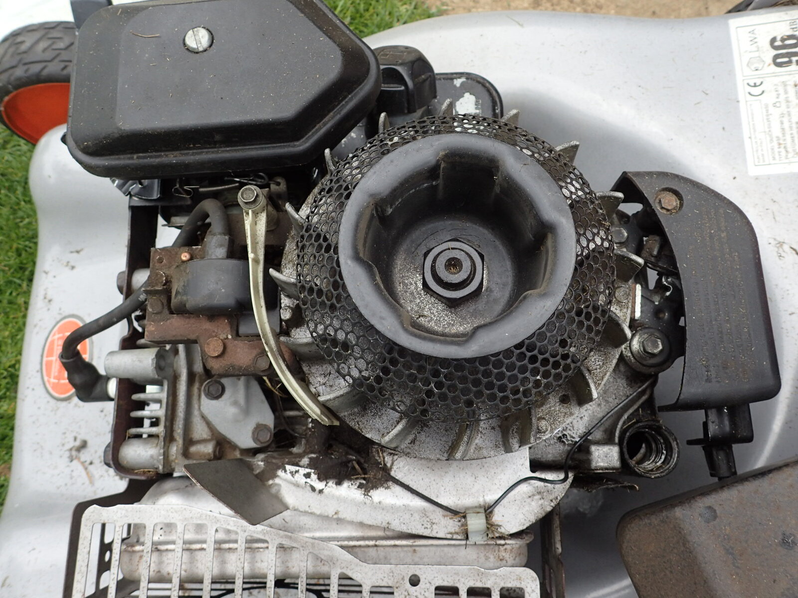

Please see picture of Flywheel cover, What size nut is this and procedure to remove ??
Put a lump of wood underneath to stop the blade turning.
Use a socket bar and I think its a 15/16" socket , tap it smartly with a hammer anti clock looking from above...unless you have an impact wrench? Oh, take the plug lead off first.
To release the flywheel taper, you should find some clearance when you pull the flywheel up a little.....put some wooden wedges under the flywheel and tap the crankshaft end (nut on but loose) nice and sharply. The flywheel will pop clear.

Hi John
Is this to remove the Flywheel cover ?
As I was going to give the flywheel a visual look first, don't know if this is a waste of time to put right my problem.
John
This is to remove the flywheel itself, once the cooling cowl has been removed, nicely visible from your last photo. There's nothing below the flywheel, you just need to inspect the key that keeps it on the crankshaft in one specific place.

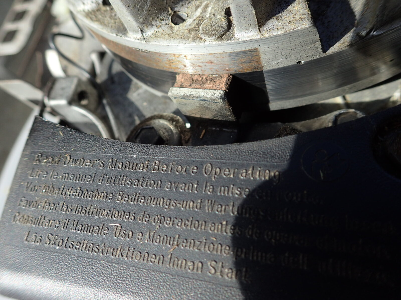

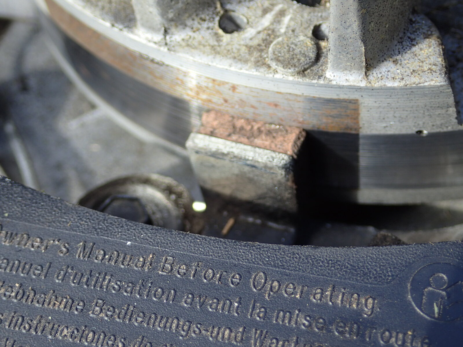

Thanks for the link. Helped noend, I have attached timing marks looks like flywheel key is the culprit.

This flywheel has no timing marks as the key locks the flywheel onto the crankshaft....it's only engines with no key (early Villiers) that were built that way.
See if you can shift the flywheel, details in my earlier post?
John :)

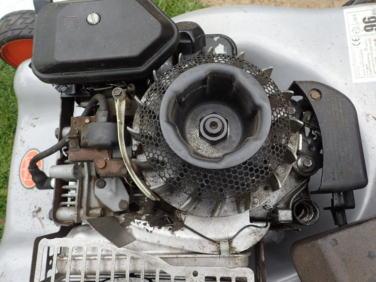

Managed to remove flywheel please see attached photo of key, it has the B/S sign so it looks like genuine one. no marks to show it's shared or distorted Flywheel looks OK where key fits as well.
Would you say this is the correct length having not see one before ?
But now I have it out will pop to local dealer Tuesday and buy a new as it wont cost much.
