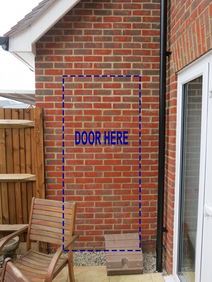

  • What sort of lintel would you recommend for adding a personal door where the gas meter box is in the picture (gas board on standby to move the meter separately)? The section where the door will go is single brick, measuring about 1.4m wide.

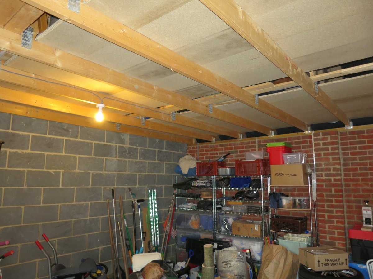

  • I have previously boarded out the roofspace, and I'm worried about adding any more weight up there, i.e. for insulating/cladding the ceiling. Do you think that it would be necessary to add some reinforcement (if so how), or would ultra thin 9mm plasterboard be alright?

To replicate your patio door, you'll need something like this: http://www.lintels.co.uk/catnic-lintel-ang-1350mm-10104-2804999
It won't be easy to replicate the other lintels, but with care it could be done. You'll need to place your strongman about five courses above where the lintel will be going.
I'd have thought that one strongman would be sufficient. For peace of mind, you could use two, but I suspect the roof trusses will be in the way of the strongmen on the inside, and you'll need to work from the outside, so they'll be in your way.
There's loads of threads on insulating garages. I'd use the p/b with insulation bonded to the back of it, and dot'n'dab. it has a vpm in the form of foil-backed. Position the boards about 25mm above the floor.
I can't answer your question about the ceiling, other than you shouldn't use 9mm board on the ceiling.
Lintel depends whether the wall is cavity or single skin?
Insulation; use thermal laminate board - e.g. kingspan k17 or k18. Which one depends whether you fix dot and dab or mechanical? Make sure you select correct one. 85mm thick should be ok.
Plasterboard depends on spacing of joists. 9mm is ok for 400 centres - 12.5mm for 600 centres.
