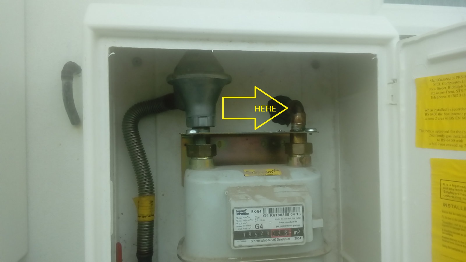

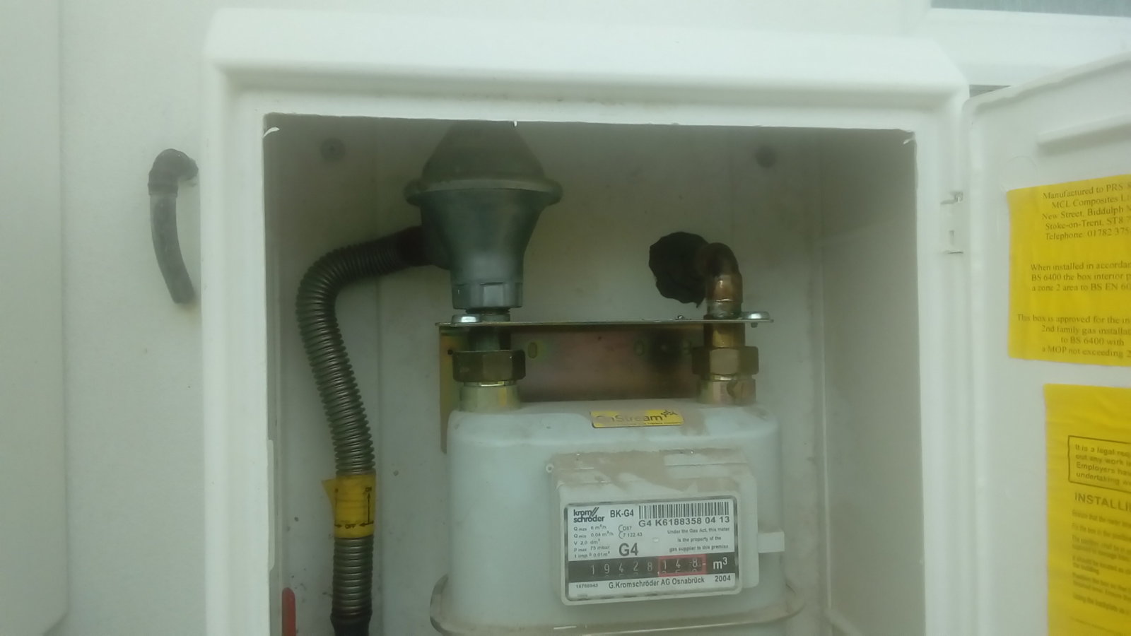

Where is the bonding cable to be attached to the gas pipe now that the gas meter has been moved? The old bonding was attached to a forged steel 90% elbow on the top of the meter but the new meter has 22mm copper going in to the meter top.

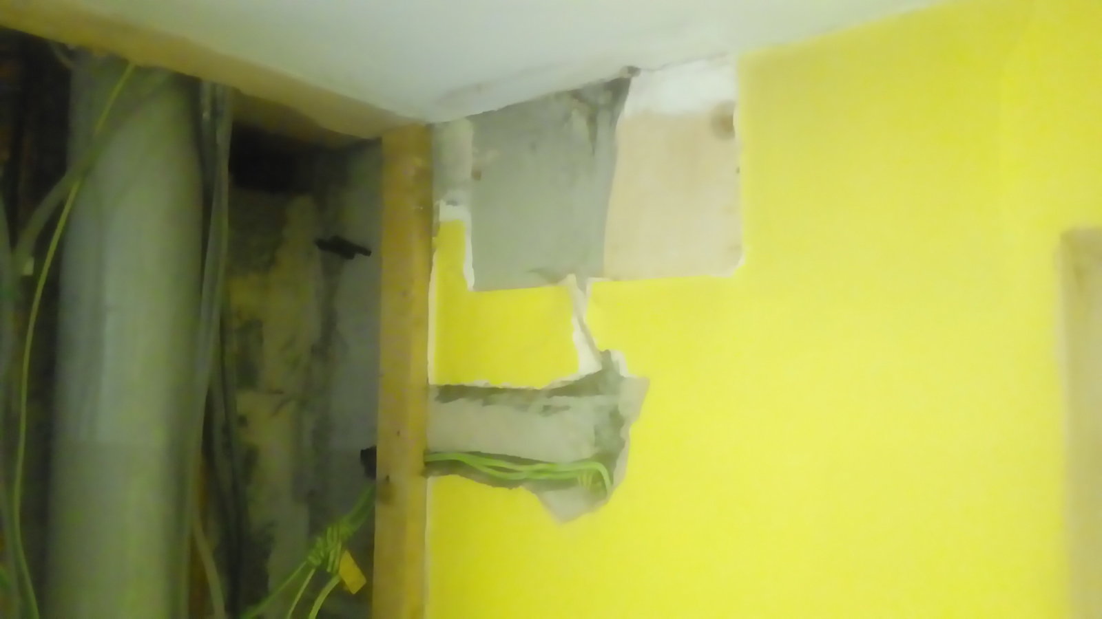

You can see where the olde worlde fuse box was sited and painted around in yellow.

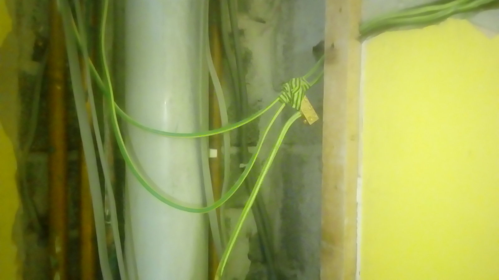

6mm O/D dia. earth tails drop down from new cu in the room above, to shared block. A new earth coming up from new electricity meter location (hole with expanded foam) I think one of the old earth tails went to the previous gas meter site, after vanishing in to the plaster, but think that both of that pair sunk in the wall are redundant now anyway.
It should be connected to the pipe at the point of entry to the premises [edit] where practicable.
You can see the olde worlde fuse box has gone, 2 new cu tails drop down to shared block with another coming up from new electricity meter location. I don't know where the old earth tails go but think that they're redundant?
Can't really make anything of the picture.
Does the bonding need to be attached in the meter box? Or can it be attached inside the house?
At the point of entry, which obviously can be inside or outside.

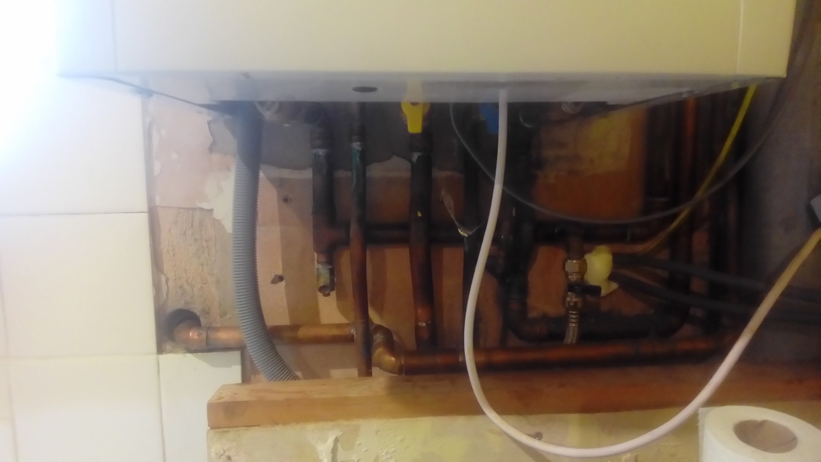

I need about 1.2m of 10mm² earth cable if the clamp is to go on the 22mm gas where it emerges from the wall, but there is a 15mm gas riser coming off the 22mm much closer to the MET.
It doesn't actually matter where on the pipe the connection is made but the regulations state at the point of entry - where practicable - so that that piece of pipe from outside the premises, which is the part which needs the connection, does not become disconnected from the MET by alterations within the building.
It does not apply to gas pipes but water pipes might be altered and some plastic pipe inserted between the point of entry and the actual connection.

So, do the 2 old earth tails that vanish in to the yellow wall need to remain, because the meters that were behind that wall have been moved? Or do the various earths eventually go to some copper earth rod and they're best left alone?
No, they are not Earths, they are Bonds which 'join electrically' the Earthed metal parts within your house to ensure that they all remain at the same potential(voltage) in the event of a fault.
You cannot get a shock by touching two things of the same voltage - obviously you must not be also be earthed yourself.
The gas pipe itself IS connected to Earth (the ground) and acts as an earth rod.
Only parts which are already Earthed require Bonding. It would be better if we could ensure NO parts were Earthed but we can't - some must be Earthed on purpose (e.g. washing machine metal case) to ensure the supply is disconnected by the fuse/MCB when a live wire touches it by mistake, otherwise it would remain live.
So I don't really need the 2 old bonds that vanish thru that yellow wall? With the meters they serviced having been moved they are now obsoloete, they could be disconnected from the MET, and even removed altogether?
