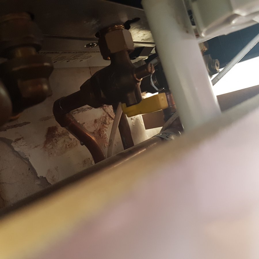

Hi we have moved into a new house snd one of the radiators needed bleeding.. i have bled the radiator but the the pressure has dropped to 0.4 , i have searched for a video or instructions on this model but ive had no joy. can any body shed some light .. i think its the black one but i wanted to be sure that is all
http://www.glow-worm.co.uk/glow-worm/betacom2-instn-serv-157121.pdf
If this is the boiler you have, page 10 states no filling loop is included so an external one is required.
Look for an external loop usually near the boiler with a flexible hose like this,
Most are left connected all the time despite the water regs :whistle: Some may have two valves but most have one non return valve on the boiler and a simple valve to control filling as shown.

Thank you for your reply i cannot see where the loop system would be attached im guessing i turn the black screw and maybe open the yellow one after??

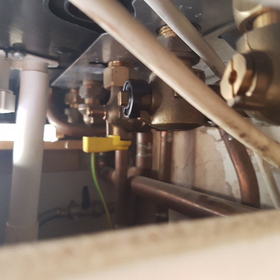

Here is a image from the other side
Don't touch the yellow My guess is it is the gas, on your first picture the valve with the black handle and braided pipe towards the bottom of the picture looks like the one you need.
Ive had a better look through the manual and that yellow one is the gas i should be ok at getting the pressure up i just need a screw driver the right size now but thank you very much for your help (y)
The black handle in the background is across the pipe in the off position should just turn by hand to lie along the pipe to fill the system I don't think you will need a screwdriver.
