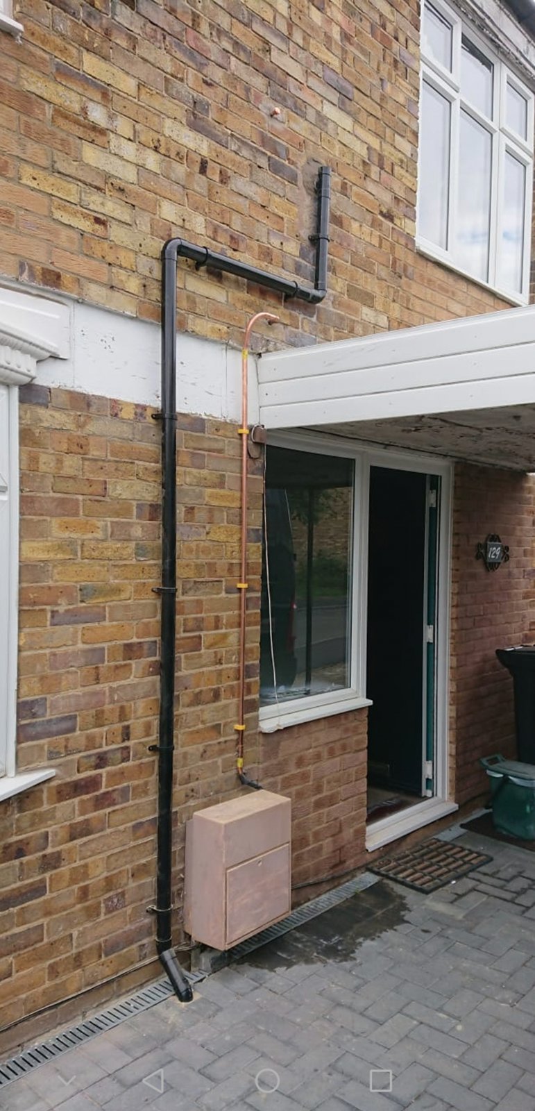

Nice, but what did you do with the condense? :LOL:;):whistle:
Took the bricks up put in a pit filled & surrounded with lime chippings 500mm from the wall.
Bricks went down as if they have never been up.

Sorry mate... You missed my joke...
Condence should be Condense :)
Condence done in 2 inch to pit with lime chippings 500mm from wall.
22mm gas supply
Is this yours?
The gas pipe bend is BAD. (Unless a weird camera angle, in which case I apologise). Is it sealed?
And why the ID tape? That I will never forgive. It looks cat. And not required.

Not mine but the pulled bend is perfect no ripples. I would have thought it is sealed one side and sleeved. The tape? My dozy mate being over the top. But I'd rather him be over the top than below the bottom. It's a simple instalation. But many will do a crap job. This ain't bad.!!!! Don't you think???
