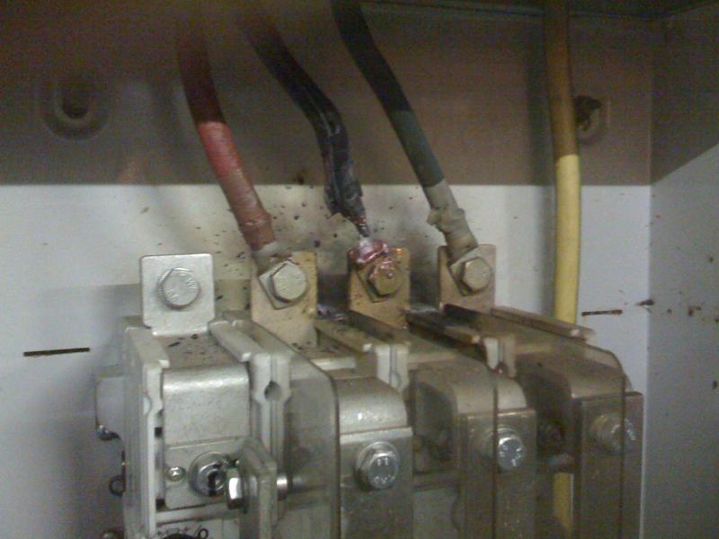

Hairy & Rob, you've almost got it, between you!
Here's what greeted me when I removed the CU cover:
Yes!!! The neutrals for the GF RF are in the earth busbar!!!!
The main earth to the CU was 6mm².
The Ze was 3.35 Ohms & Zs 3.71 on TN-S.
Then I realised the GF RF was on the incomer side of a 16th split board...
Hmmm. Maybe that's more than two faults, but how many contributed to the Volt Drop problem? Two, I think.
Any advance on two, anyone?
