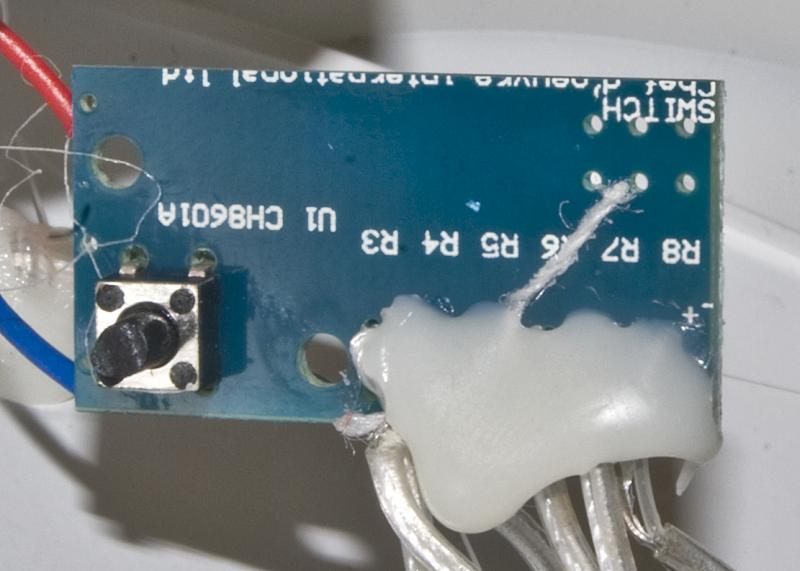

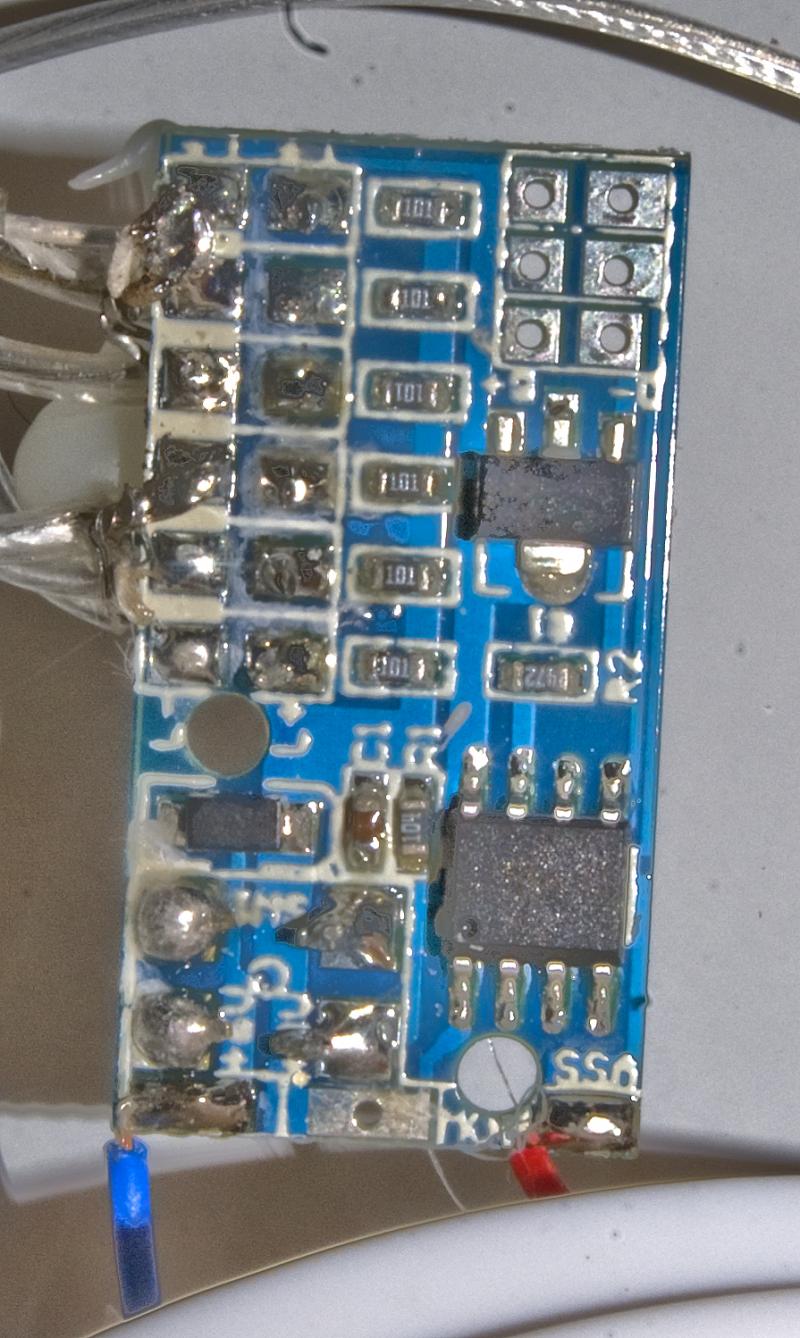

My wife wants me to mend the Christmas lights!
It's somewhere on that board which is about 1" by 1.5" each spot of solder is about half the size of pointed tip on soldering iron. Need to put on microscope to work on. I'll give you three guesses where it's going!
Surface mount components - tools of the devil.
Probably lead free solder as well which is ten times more difficult to use, being composed almost entirely of tin.
Almost as bad as 'lead free pewter' whatever that is supposed to be.
