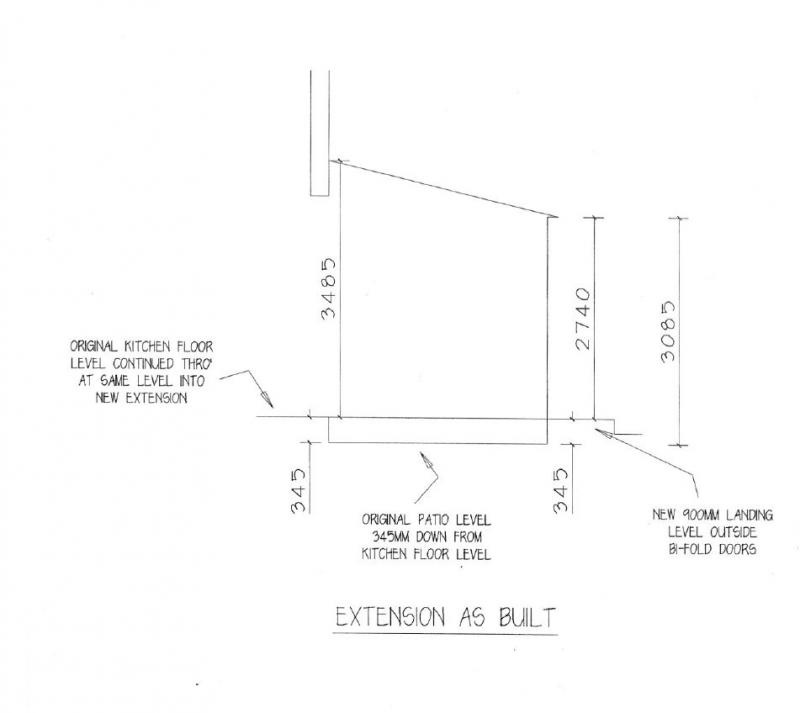

Doesn't that suggest your 3.4m is well under the Max they considered as OK which was 4m ?

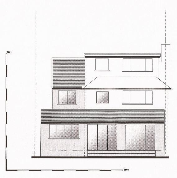

Star; have you tried scaling the measurement of the eaves-height off the drawing? The two steps shown suggest it could be higher than if the ground were level. If it scales at around 3.45m. and assuming the architect has NOT indicated any actual measurement for this, that would help your case a lot.
Get a scale out and check that eaves height.

star; has the srchitect drawn a section through the single-storey part showing details?
there is only the back view and the floor plan of the new ground level. is that what you are asking for.
also i just measured the architect scale. 1cm on the ruler is 9mm on their scale. grrrr...
i will also post on what we have actually built first image
[/img]
Your height to the eaves seems to be just under 3.1m. Where do they get 3.45m from?
i think using neighbours ground level (which was lower than ours in the first place) or from our foundation bricks perhaps. just doesn't make sense to me really.
If the enforcement officer measured height from the neighbour's side (which you say is lower than yours) then this should have been seen when the officer originally dealing with the application came round on the customary site visit.
Your drawings won't show the height in relation to the neighbour's ground, only your ground. If the height to the eaves as measured off the submitted drawing is more-or-less as built, then it's a bit late in the day for Planning to suddenly realize that it will be higher when seen from next doors.
