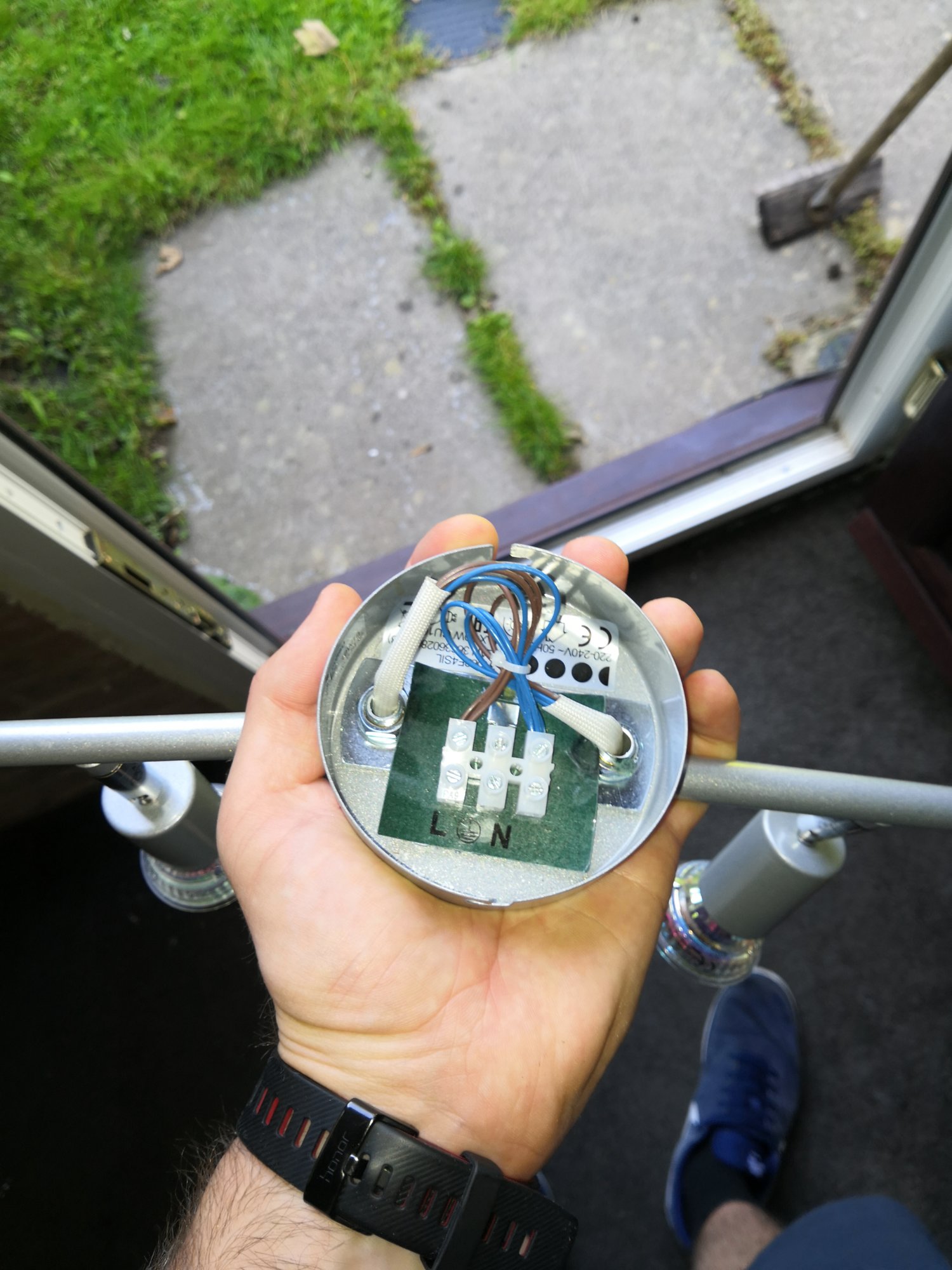

So this is my first post and I need some advice as I think this is probably an obvious mistake I'm making so I'm hoping someone should be able to help! I'll try and keep this as simple as possible and I've attached a few photos for clarity! In short this is the situation.
1) I'm replacing a standard Batten light in our garage with a 4 bulb living room style light fitting.
2) This light has previously been operated by one of two switches (one in the garage itself, and the other in the adjoining kitchen)
3) When I disconnected the old batten light and removed it I stupidly didn't take a picture of the wiring.
4) Out of the ceiling are two white cables (pictures attached) one has four wires inside it and the other 3. I think the cable with 3 core wires inside it goes on to operate the outside Pir light and the one with 4 wires opearates the garage light. I'm assuming at this stage that the additional 4th wire which is yellow is for the 2 way switch?
5) When replacing it I wound both live wires from each of the white cables together along with the yellow and screwed that into the Live terminal on the light fitting. Then wound both neutrals together and screwed them in and then wired both earth's and did the same.
6) When I turned the power back on the light was on and couldn't be turned off by either of the light switches. I've tried a few different combinations but can't get the switch to work??
With general DIY I've got a decent basic knowledge however as you can probably tell when it comes to electrics I'm a total amateur. Before I get to the stage where I'm calling an electrician to come round and show me the correct order to put the wires in and then charge me a small fortune I thought I'd see if anyone on here has a better understanding.

Guessing isn't really a good idea. I suspect that the three core and earth has the following conductors..
Permanent line (red)
Switched line ( yellow)
Neutral ( blue )
And of course the cpc ( bare earth conductor)
The twin and earth ,if you are correct ,supplying the outside pir.
Your light fitting was permanently on because you connected it to the permanent line , only the switched line ( yellow )should connect to the fittings L terminal ,and the neutrals both connected to the fittings N terminal. Both earths connect to the fittings earth terminal.
The permanent line ( red )should go in a separate connector block together with the red from the twin and earth ,and this should not connect to the light fitting ,but should be insulated from it.
Really the conductors need to be tested to establish which is which ,but with the info you have given above ,(and you made no mention of blowing fuses or tripping MCB' s ,so I ASSUME YOU DIDN'T) I Think the above is the way it should be wired.

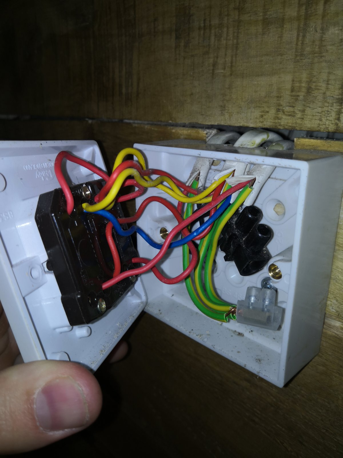

Can you post a pic of the wiring at the two switches?

The permanent line conductors can be within the light fitting ,but not connected to the fitting. ( So a separate connector block required )

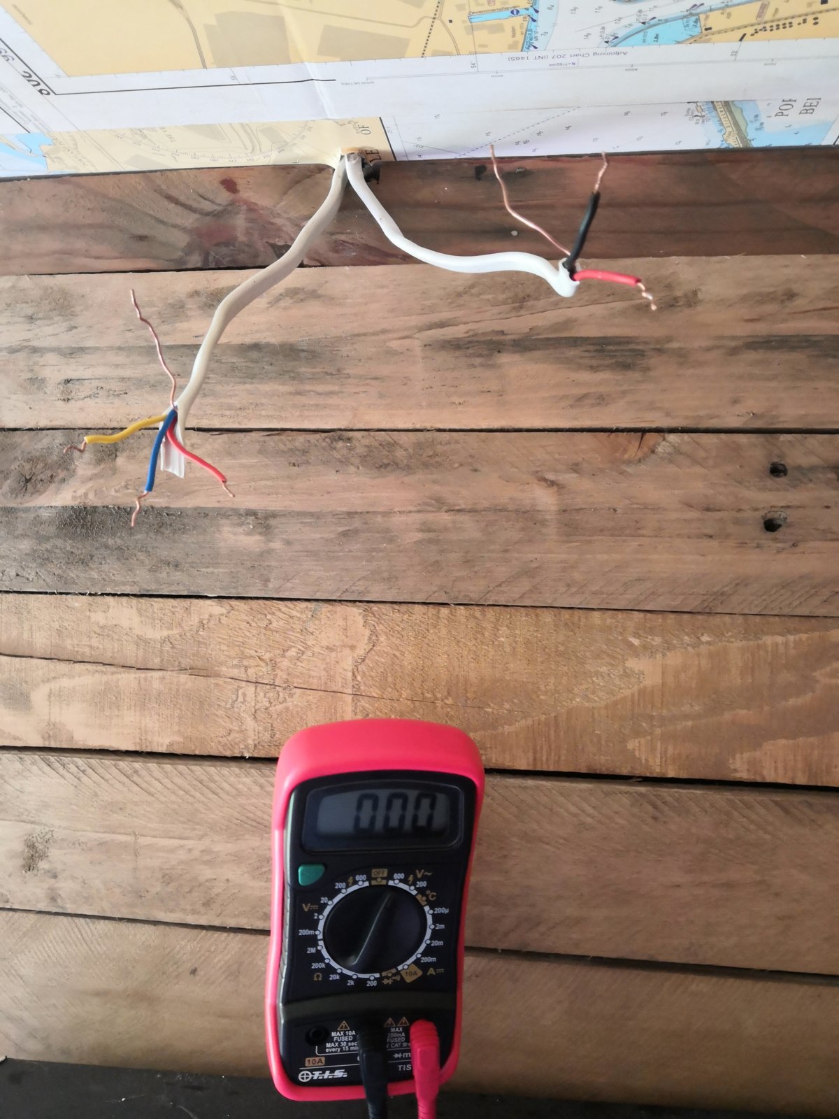

So update.......
Using the multi meter the 3 core cable on the right has about 230 volts passing through which is unaffected by any light switch combinations.
The 4 core cable on the other hand has nothing whatsoever. Neither the live neutral or switch live seem to have any volts passing through?
I know when I first started trying to wire in the light fitting and then tested it at one point the fuse tripped and power switched off immediately. I'm now wondering if I've blown something in the cable or burnt out a wire or something??
Any thoughts or ideas greatly received!!!

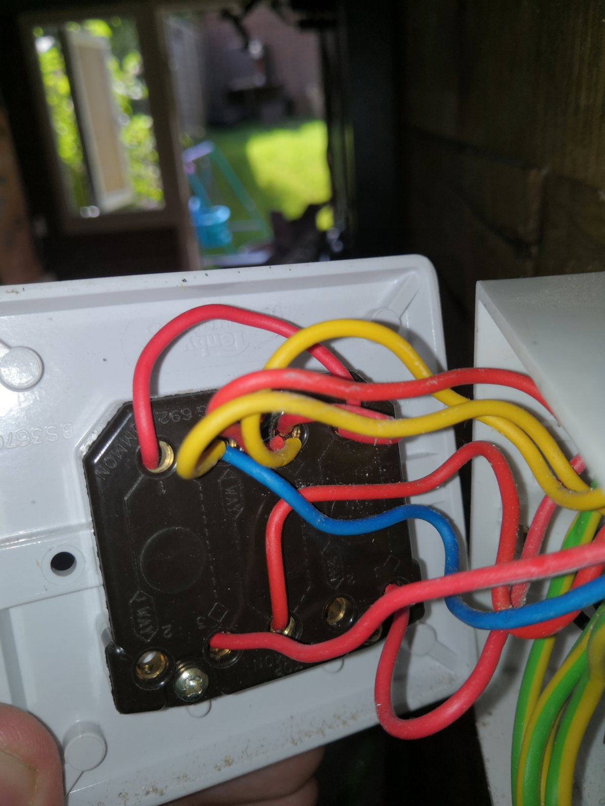

You keep saying "the switch in the garage" and it now turns out there are three.
Unless you can describe better how the system operated, then, I think, you will require an electrician.
Yep correct, three individual switches, when I say "the switch in the garage I'm referring to the individual switch (1 of 3) that operates the garage light, there's also a switch in the kitchen (3 individual switches to be precise) which operates the garage light too!
