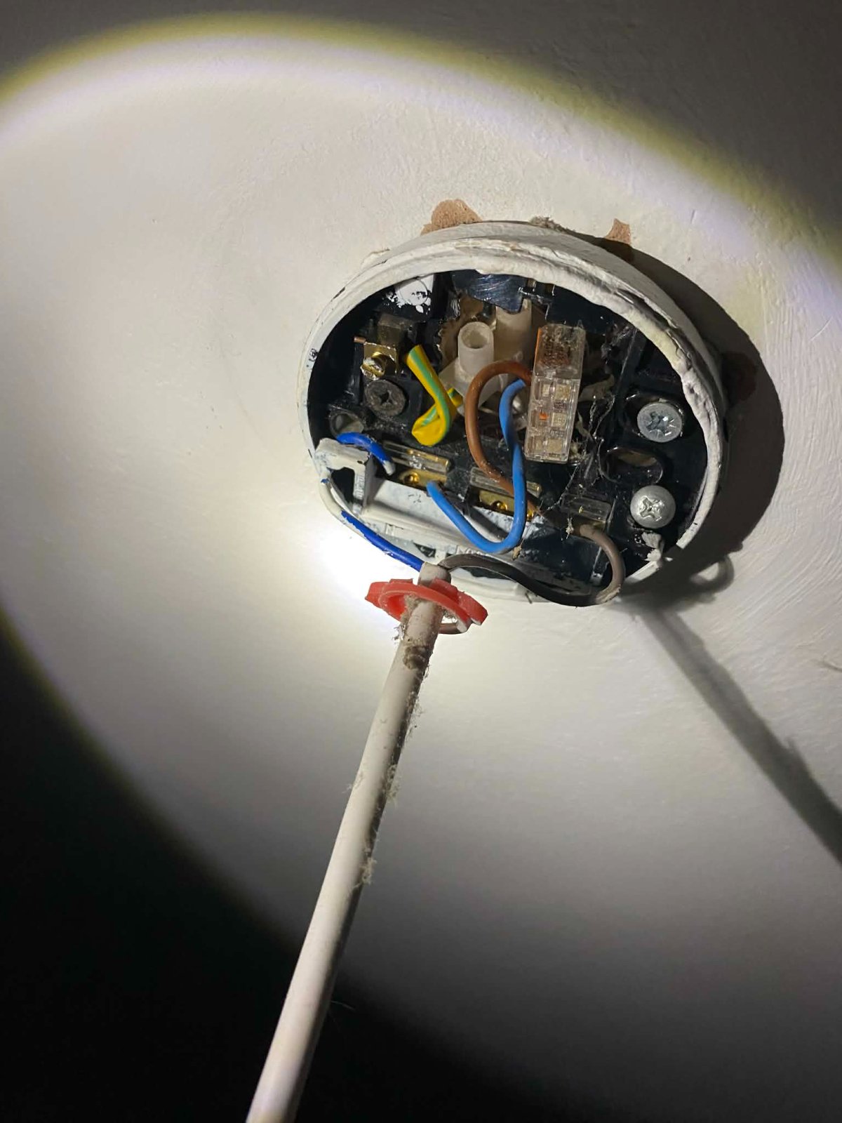

Hi,

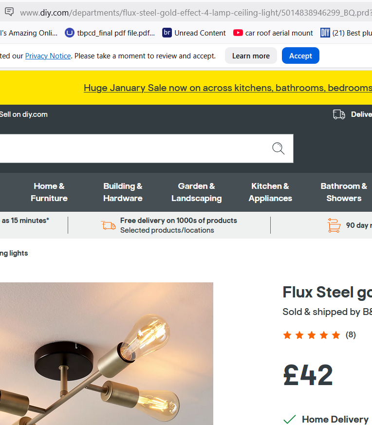

I'm trying to swap a regular single pendant bulb light fitting for a 4 bulb ceiling light, something like this - https://www.diy.com/departments/flux-steel-gold-effect-4-lamp-ceiling-light/5014838946299_BQ.prd
The wiring diagram with the new fixture shows I need the usual live, neutral and earth. I am aware of the FAQ for replacing a rosette, however when removing the fitting, instead of a rosette I see the below, and I'm not quite sure to proceed.
I'm guessing what I'm supposed to do is remove all the existing fitting and the terminal block. For the live and neutral, I'm assuming for the new light I want the two lengths that come out of the ceiling and enter the terminal block, and that the lengths coming out of the block and travelling down the white sleeve will just detach and become scrap wire.
For the Earth wire, I assume I just take the line attached to the serpent holder block and use that. As this is quite short and appears to be connected to an extender block anyway, I was going to remove the existing length and put in a longer piece of wire to make hooking the new light up easier.
Can anyone confirm if this approach is correct? Thanks!

Hopefully there will be slack cable in the ceiling and you won't need to extend the wires. Remove the screws and pull the rose dowm so that you can see what length you have to work with.
I think you will have some slack in the wires in the new fitting, can you post a pic of that too.

Your link is for B&Q app.
Sometimes, depending upon the fitting, it is possible just to remove the existing ceiling rose cover, perhaps slacken/temporarily remove the fixing screws and install the base of your new lamp. The connections for the old pendant flex being removed and used for connecting wires for N & L of your new lamp and perhaps an E link from the rose to the new fitting.
It is not usually necessary to refit the old rose cover before the new base is fitted.
That way makes it nice and easy to change and also has the advantage of making the old cover and pendant back and take your new fitting with you if you move home.
Oviously, whenever undertaking such electrical work then follow robust good isolation procedures and if you are not totally competant to do the job then get a pro to do it.
The existing rose only has L, N and E connected, nothing to go wrong there. Those Wagos and choc block are where it gets interesting. They shouldn‘t just be stuffed into the ceiling like that but if the new light only has a mounting bracket and cover it doesn’t really make a difference whether they’re against the ceiling or just inside a hole in the ceiling. The easiest way of wiring this would be connecting the short bits of wire to the new light.
Unless the new lights wires reach the connectors
Thanks guys! Sorry for the slow reply - got called out of the house for work. The new light has only slots in it's connector blocks for the wires coming in, so nothing to reach up to the existing Wagos. For the earth screw block, it felt like there wasn't a huge amount of play in the wire, so I think whoever ran it may have simply run out of length and put it in just to extend an inch or so for fitting the original light (seems odd, but I can't figure out what else it's doing).
Agree I think I'm going to aim to try and use the short pieces of wire heading into the existing rose block for the new light to make it easy (assuming they give me enough room to connect whilst holding the light up)!
Many thanks for the advice. I'll put a picture up once complete tomorrow and wait a while before turning on just in case anyone sees the post and spots any issues!

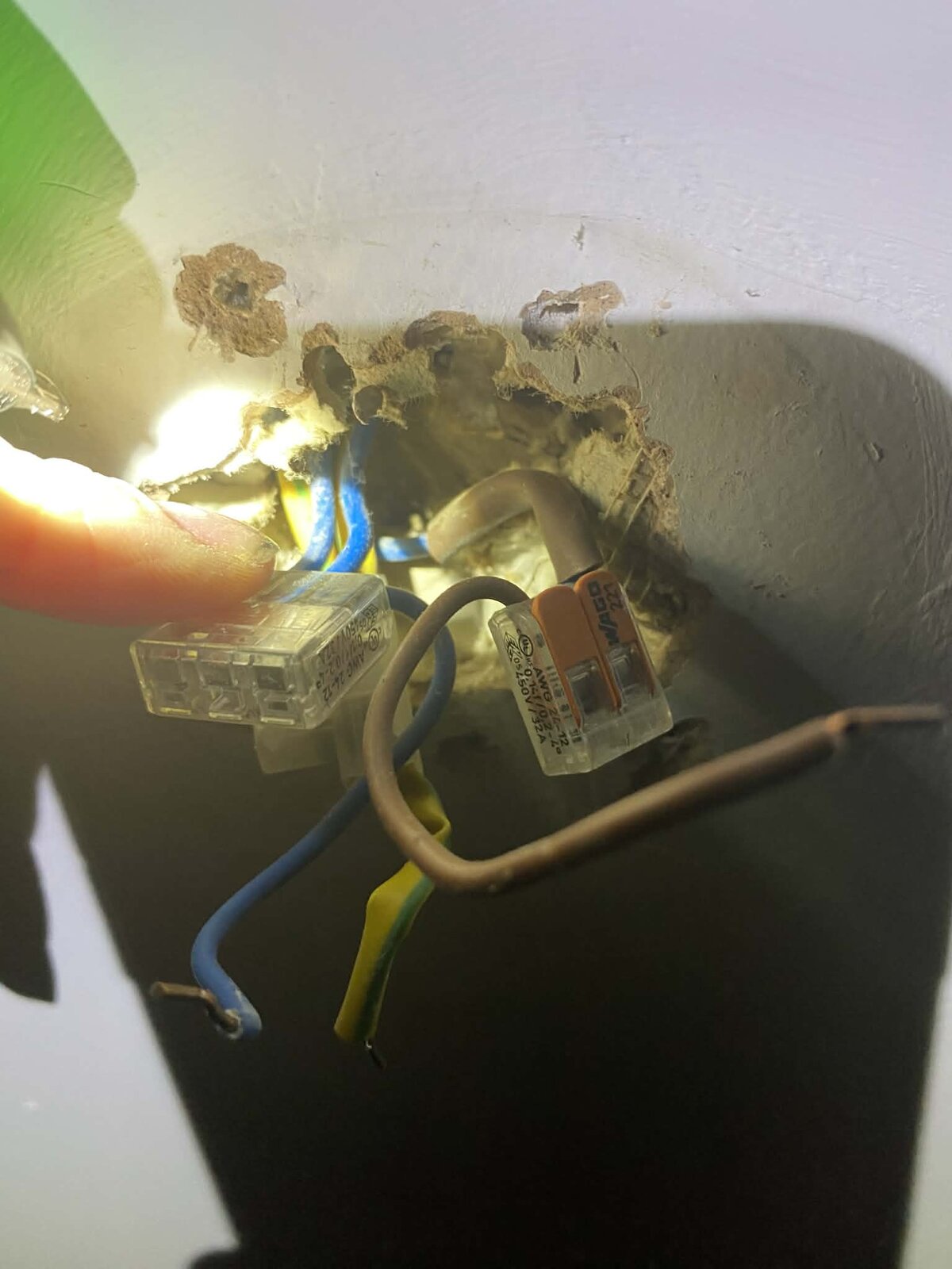

Hi all. All installed and working - thanks for the help.
For those curious, I pulled the wires down and found the rose had essentially been done in WAGOs and one screw block (for the earths) in the wiring in the ceiling itself.
One slightly concerning thing is that I noticed one of the screws on the original light fitting had actually pushed all the way through the plaster and could touch the cabling on the other side. I replaced with a shorter screw in a plug to avoid this problem, but at some point soon I'll likely revisit and replace the screw block for the earths with a WAGO for peace of mind and shift the orientation of the screws away from the cable hole for peace of mind. Ideally, I may also take a bit of ceiling out to check for any damage on the main cable, but although it touched I think the chance is very low.
Thanks all for the help!
If you’re going to open the ceiling get a maintenance-free junction box and get rid of all those loose connectors. Just run a short bit of T&E from the JB to the light.
