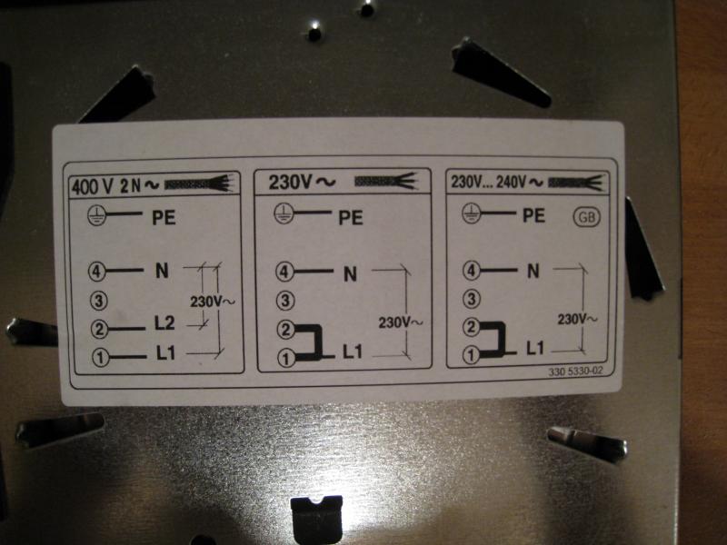

So does that mean that choosing a 0.5mm² cable for a 6.4kW appliance wasn't a stupid thing to do?
Does that mean that not having the gumption to wonder why cables come in different sizes, and why they have different current ratings quoted for them, and still think it would be OK to do electrical work wasn't a stupid decision?
Does that mean that repeatedly ignoring the advice she was given was not stupid behaviour?

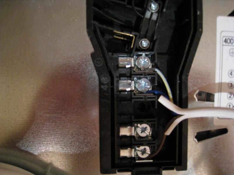

Surprised no one noticed the original 0.5mm flex was connected to: Brown to live 1; Blue to No Connection: Earth to Neutral.
There is no connection no 3 - it is just a vacant positon. You can just and so see the numbers to the left, she/he had Phase to 1, Neutral to 4 and Earth to the terminal marked with the earth symbol.
The earth looks a bit white to me.
I stand corrected. It looked like the earth terminals were further up. And yes, it does look white-wrong sleeving perhaps?
You can see it's yellow with green on the edges. The photo is just a bit washed out that's all.
