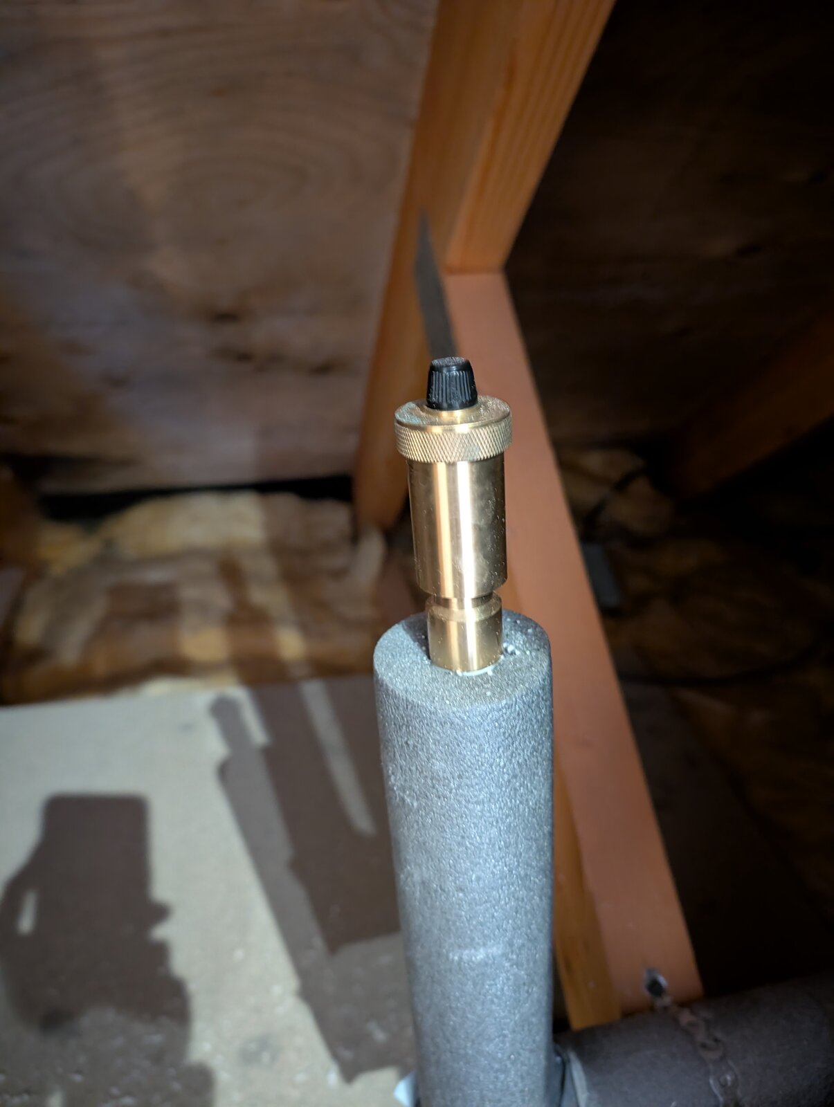

You got me thinking after you mentioned the AAV's Looking at the one at the boiler am i right that the AAV should be on the pressure side of the pump?? if that's the case its on the wrong side. I assume to close them its just a case of screwing the plastic cap in??? it appears that one is closed so whether he just fitted it to bleed the system I've no idea. kind off defeats the purpose of having it??
AAVs can admit air as well as vent it.
As mentioned by another poster.
High up ones are more likely to be worth investigating.
Negative pressure on suction side of pump can pull air in via them.
IIRC you mentioned getting lots of air in the system... It could well be via the AAVs.
I'll close it off but surely a plumber wouldn't fit it on the return line? rather than the pressure side.
I would say you shouldn't have any AAVs fitted to an open vented system full stop. In an unvented system it wouldn't matter if it was on the return.

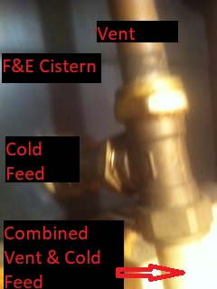

The dedicated vent and cold feed also seems a bit unique, wonder if the original set up was a gravity HW cylinder coil and CH only pumped, I've seen systems with the cold feed like the OPs but the vent was a continuation of the boiler flow pipe.

yep, originally was a gravity fed HW cylinder but that was converted about 15 yrs ago to non vented so we could get rid of the tank. The boilers been there for a good 30yrs. Pulled the hatch off to close the AAV. There is one on the return line but its closed off with the cap. Strangely enough the other one on the pressure side is right where the Tee goes across to the rad where the sound is emitting and its about 500mm up on a straight piece of pipe so I'll crawl in and screw the cap down. what are the chances thats the problem??? fingers crossed as you'll no doubt see they're push fit ones aswell. Those push fit AAV have a fair bit of movement on them. wish he'd used compression. knowing my luck that wont be the problem. Heating was on for 30 mins this morning and 30 mins + after cooldown the noise starts

Do that vent test with the container for a few hours including the cool down period, if nothing strange, suggest c/o the circ pump to PP III for a day or two.
Low head F&E systems are often problematic and should be ditched in favour of sealed system...is the boiler not approved for sealed systems? There must have been a very good reason to not seal it.
AAVs are plain trouble. Replace with manual vents...I use the 1/2 radiator type vent with a 1/2 BSP female coupler.

Below is my combined vent and cold feed, I moved the (new, then) cistern into the side when, in 2011, I installed a modest thermal solar system which required a 2 coil cylinder.
