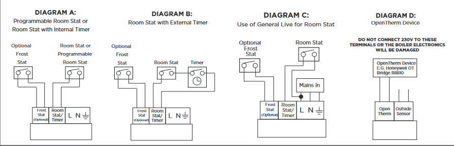

One select the correct installation manual I may have linked to right one? then look at the connections it does seem unless using OpenTherm it is 230 volt.
So all you need to do is put your voltage tester in the terminal
is the power switching on and off.

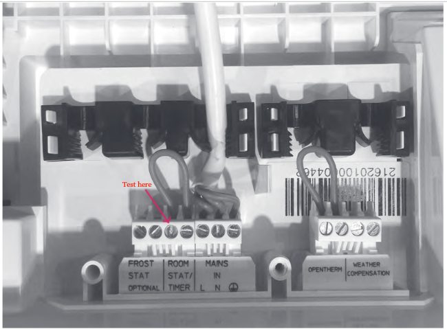

Yes that's correct I have removed the loop from the room stat / timer plug and wired from connection 1 & 3 on the receiver.
When turning the heating on the receivers green light comes on and I can hear the unit click, checking the volatge I get 230v at the indicated terminal when the heating is switched on.
Just to confirm as well, I am not using OpenTherm.
Where are you testing voltage, boiler or Hive?

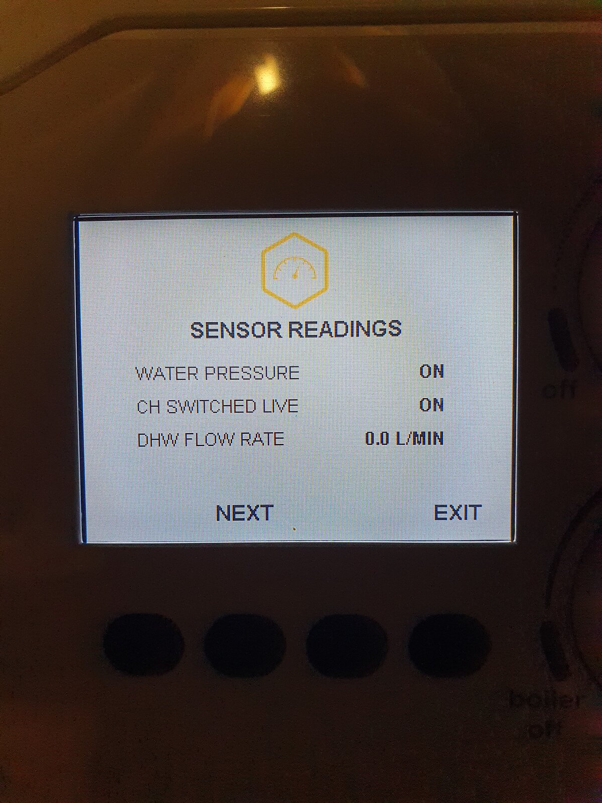

No errors, hot water side "preheat on" and CH side says the thermostat is off.
Looking at the sensor readings you can see the CH switched live is on and turns off when we turn the heating off, the boiler just doesn't seem to be doing anything with it.

Methinks there is confusion here, the diagrams posed of the Ideal Vogue are a combi boiler, and commensurate with that reference is made to a diverter inside the boiler. Now there is mention of systems that have an external hot water cylinder IE 'Y Plan' and even a 'W Plan' which are pretty rare these days....I'm confused....so I wouldn't be surprised if the OP isn't also. :confused:
