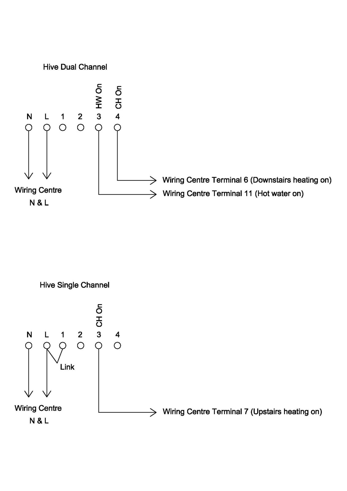

Hi
I have a system boiler with two heating zones, and I'm trying to install Hive
I have a Hive (version 1) controller, and a Hive Multizone unit
Can someone tell me whats the best way to wire it up?
Photos in album
Cables into connector unit (from left to right):
Boiler / Mains In / Downstairs 'stat / Upstairs 'stat / Downstairs valve / Upstairs valve / Hot water valve / Controller / Cylinder
Any help would be greatly appreciated

Thanks. that was very helpful. I assume that you will use a dual channel hive for downstairs and hot water control, and a single channel hive for upstairs.
If so, you need to remove the following cables from the wiring centre [Make sure to leave any other wires going into the same terminals in place]
1) Remove the cable going to T4000 Room Thermostat downstairs
2) Remove the cable going to T4000 Room Thermostat upstairs
3) Remove cable to Timeswitch 715Si
Then run new cables to connect the two Hive receivers to the wiring centre in their place as below:

Thank you that's spot on, I'll give it a whirl tomorrow morning

So long as the live and neutral are permanent, and supplied from the same fused spur as the rest of the heating system, it doesn't actually matter where they are connected in. So linking both receivers is fine.
The dual channel Hive would be used for one of the heating zones (usually downstairs) and hot water, and the single channel Hive used for the second heating zone. (usually upstairs)
Thanks Stem, that’s really helpful to have confirmed and yes the dual receiver will look after downstairs and hit water with the single channel looking after the upstairs zone only. I was just wondering why live and ‘1’ are linked together in the wiring diagram on the second receiver terminals. Is this necessary?
Yes, it's necessary. The Hive is basically just a switch. With the single channel version, terminals 1 (common) and 3 (heating on) are wired straight to the switching contacts, so just like any switch. A light switch for example, you need one connection for the live supply, and another connection to supply the device being switched. In the case of Hive, terminal 1 has the the live supply to one side of the switch, and terminal 3 connects the other side of the switch to (in your case) the motorised valve.
The dual channel version needs extra terminals for controlling the hot water, so the common contact of the switch is wired internally to the live terminal instead of being connected to an external terminal, meaning no link is required as it is already there inside the Hive.
Why doesn't the single channel Hive have the link made internally? Some combi boilers use 24v for their control, and connecting this to 230V would be disastrous, so in this case, the boiler provides the 24v which is wired to the contacts and there would not be a link made to the L.
Hello, thanks for the comprehensive and very useful response. I had no idea there was a difference between the dual and single receiver units and would have been there all day trying to work get one out!. I will ensure I bridge across the live and 3 terminals. Really appreciate the input Stem. Good of them to cover all this in the instructions!
Sorry I meant live to common terminal!
All good, can see the differences now.
