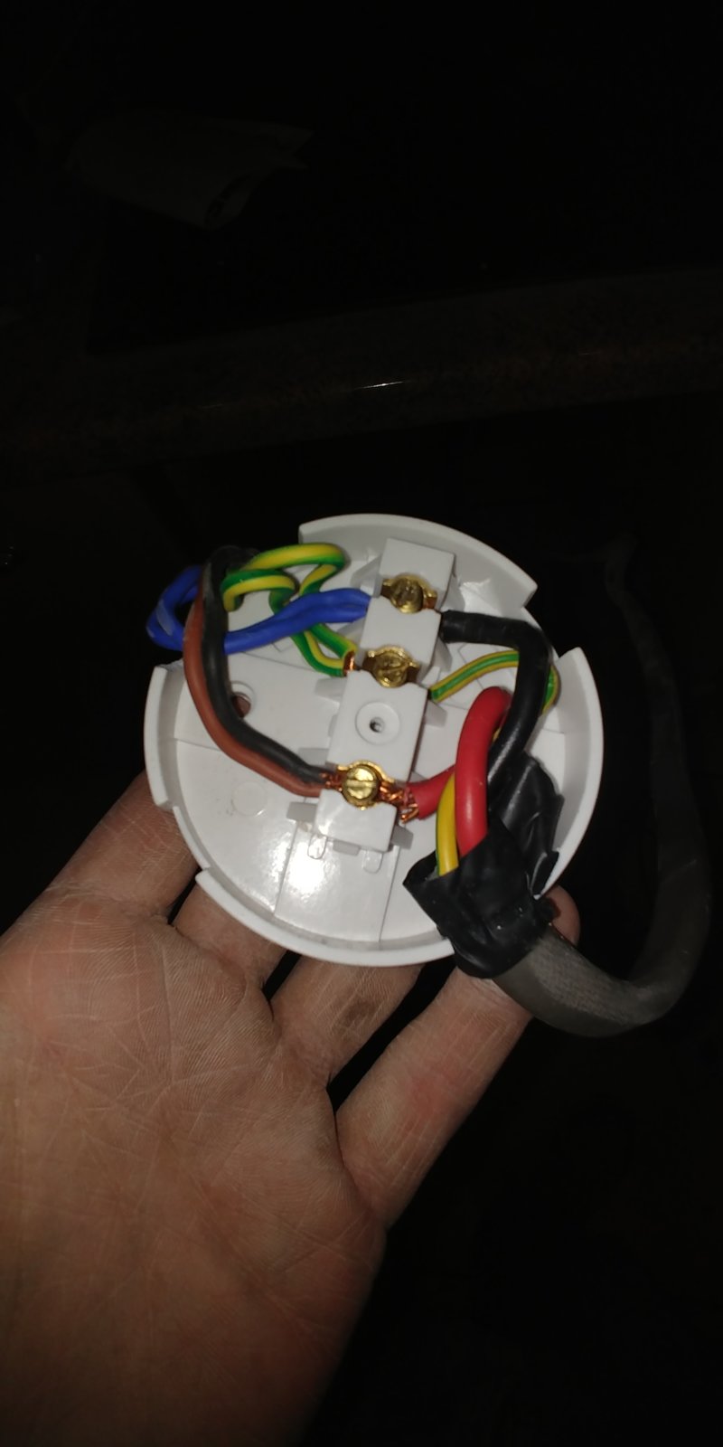

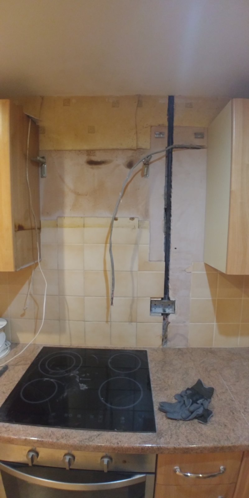

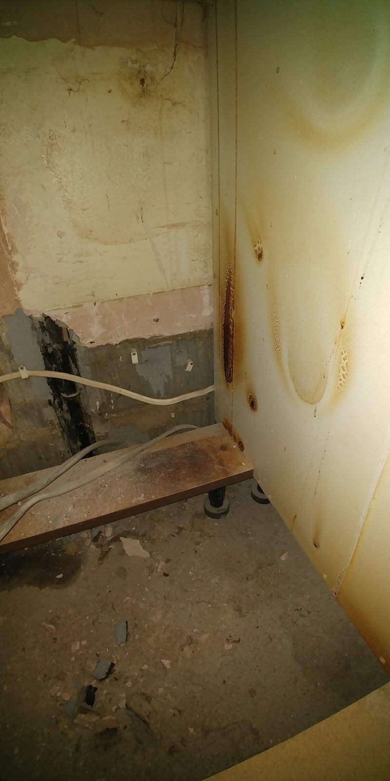

Pictures of existing wiring of which all of it is being removed or replaced.
JB to cooker. (Not sure but it might only be a 20A JB...)
Oven socket
Another JB is hidden behind back of cupboard.
3 cables are fridge socket, oven cable/ socket, to hob JB.
1 10mm cable goes up to the cooker isolator.
New chase with old cable off to the right outside of zone. I could put an FCU to the right of the 2g ba k box.

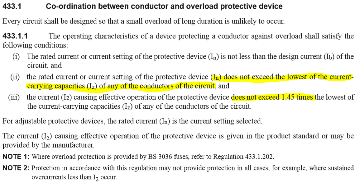

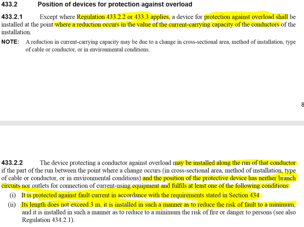

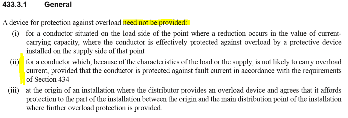

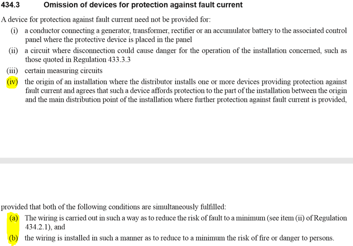

So i've extracted snippets of the regulations in an effort confirm some of the suggestions above.
EFLImpudence suggestion does not meet 433.1.1(ii) and does not meet 433.1.1(iii).
2.5mm2 cable Ref Method B = 24A. * 1.45 = 34.8A. MCB = 40A
433.3 doesn't apply here. 433.2.2 does.
EFLImpudence suggestion of wiring a socket to a CCB is inline does not meet 433.2.2, would probably meet 433.2.2(i) and (<6 inches) does meet 433.2.2(ii).
EFLImpudence suggestion of wiring a socket to a CCB is would meet 433.3.1(ii)

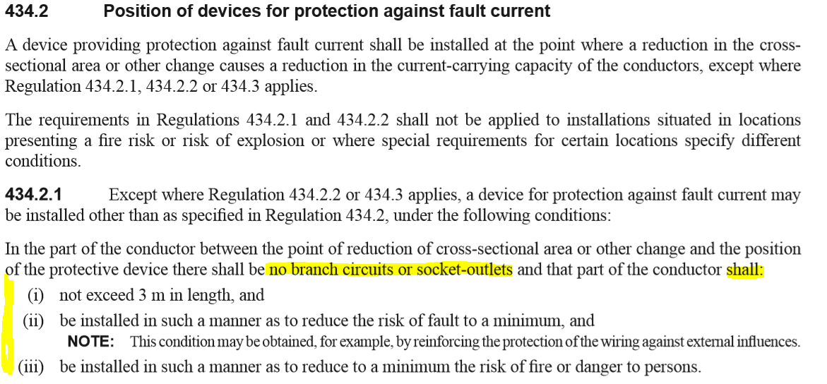

And for fault protection:
EFLImpudence suggestion does not meet 434.2.1
Not sure if 434.3(iv) would apply here or not.
Based on these extracts, it would appear:
  • 2.5mm2 spurred socket is not permissible
  • 2.5mm2 socket from CCU is not permissible
  • socket in 2.5mm2 from 13A FCU wired from cooker isolator switch in 2.5mm2 or from CCU in 2.5mm2 is permissible
have I missed something?

I think this is not permitted by 434.2.1 but an FCU before the socket would be permitted.

Yes I suppose you could argue that the fuse being downstream is sufficient, and the cable being in a fixed installation is sufficiently protected, and of a short length but it would be ignoring 434.2.1 "shall be no branch circuits or socket outlets"
