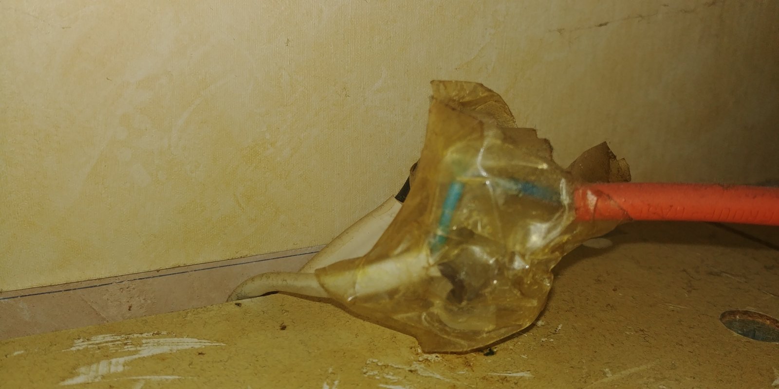

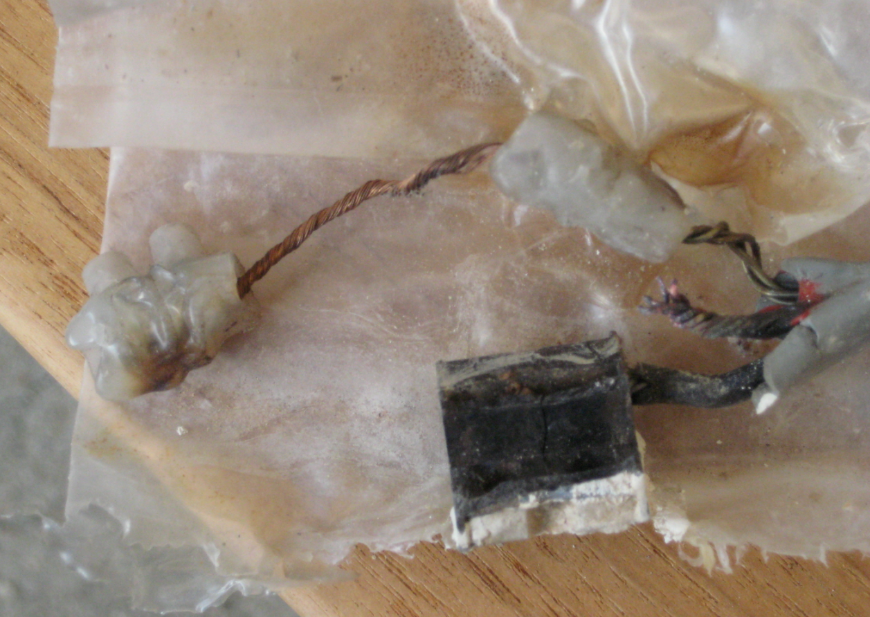

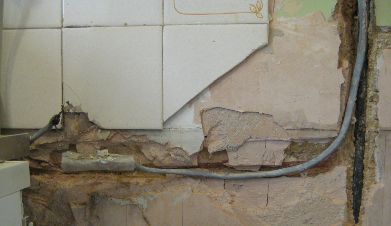

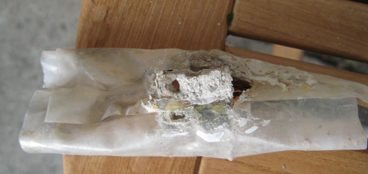

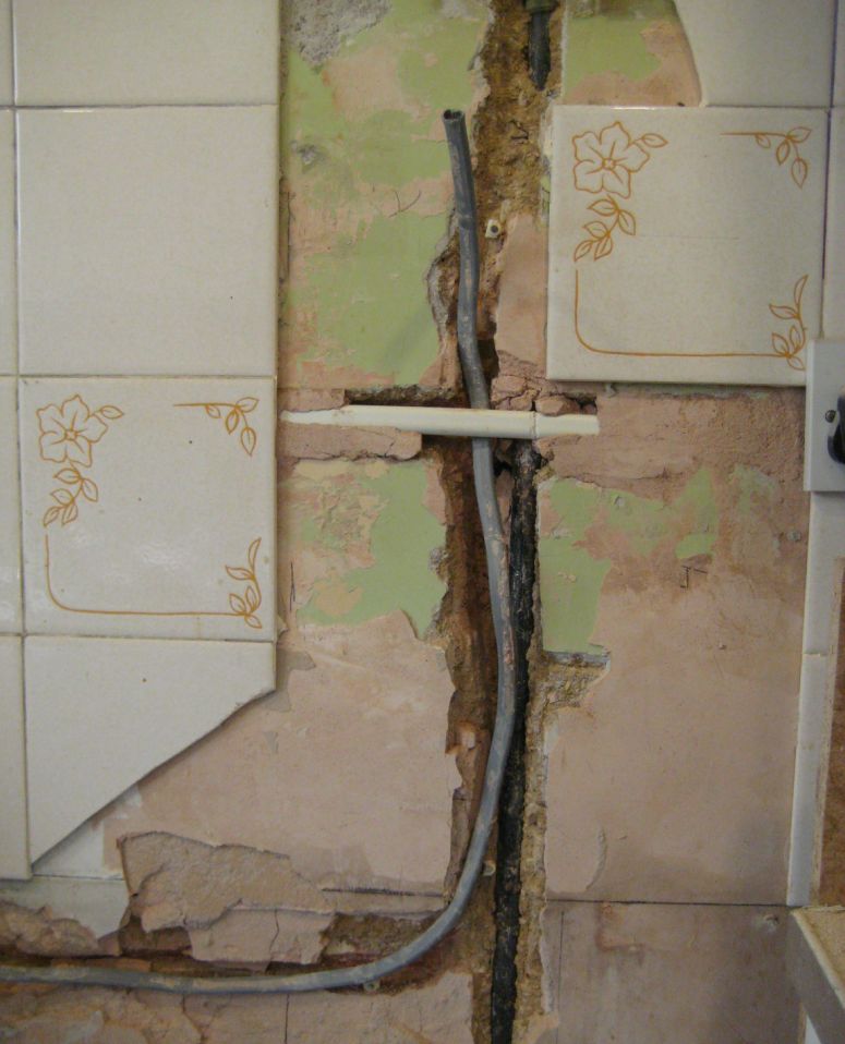

Maybe i should start a separate thread for your enjoyment to share the wide range of attrocities that i have been uncovering recently.
This is one of the better ones - sellotape!
