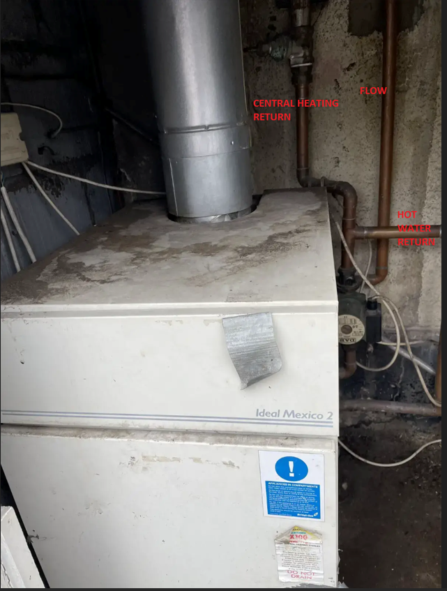

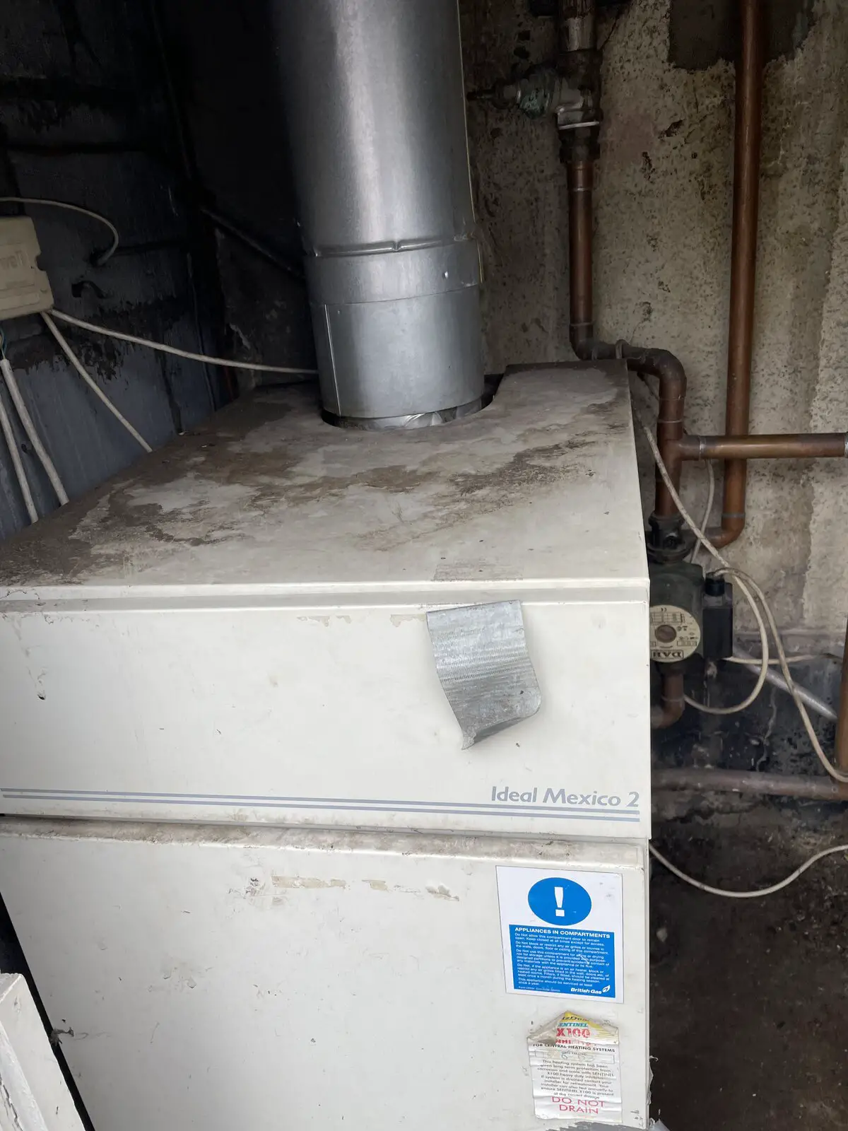

I was looking for an old post of mine and I found this photo. Are you saying that the pipe joining the pump from the right is the hot water cylinder return. And the pipe joining the pump from above is the central heating return.

It would seem the pump is on the return and both heating and HW zones are fully pumped. You will have two dedicated pipe runs like two railway lines on the sleepers ( sleepers being the radiators), One pipe takes hot water to the cylinder and radiators, second returns the water to the boiler, water that has given up the heat to be heated in the boiler. If you closed all the radiator valves and cylinder lockshield, pump could burn out as it would be pumping into a stopped system
Jacks system has a single pipe, larger diameter, that takes the heated water from the boiler. This pipe goes round the property and same pipe returns to the boiler. In essence we have a say 50mm pipe loop and boiler and pump are inserted into the loop
Any radiator or the cylinder will have the inlet or the outlet pipes connected to the loop. The radiator pipes will never be 8mm or, 10, hardly ever 15mm even- the inlet pipe often will be connected to top of the radiator and outlet to lower tapping
DP is almost correct
There is one flow pipe (28mm copper far right which then connects into 2 inch / 3 inch steel pipe) for the whole house and hot water. Pump is on return - The magnafilter only cleans half the return sadly
There is one dedicated return for the hot water cylinder which you can see in the picture
At the back of the boiler is another return for the radiator return (I think this is because of pump issue that DP pointed out to allow bypass if all closed)
I have to say the level of knowledge on this forum is far superior to many gas engineers some of whom are manufacturer preferred installers so I am very lucky to have come across this site

Apols if I have totally got the wrong end of the stick!
But, I think I might have confused things terribly here! Really, really sorry if so. What I meant was that I was looking for an old post of mine on one of Jack's threads. The system in the photo is Jack's system, not mine.

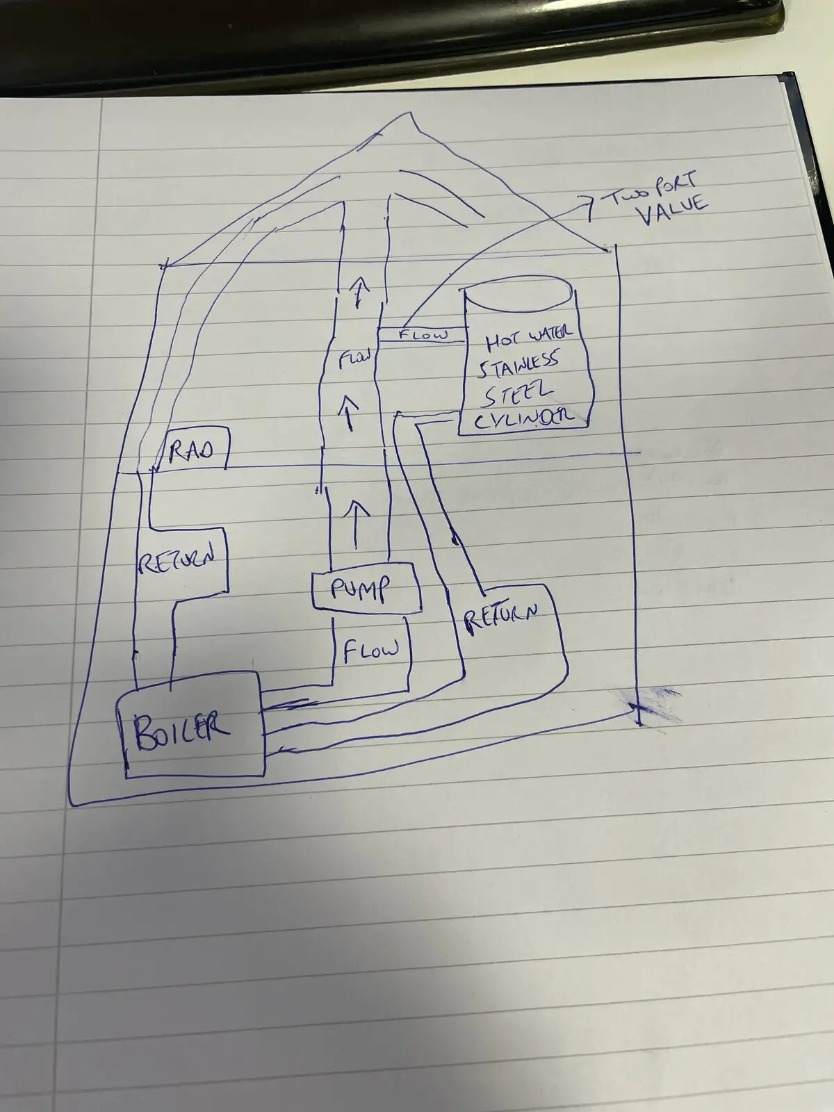

@JackK Is this what you are saying? Like in this drawing you did which I've just found.
Yes that is my system - I tried to lay it out as best as I could
1 flow and two returns
Like this annotated photo? Basically, a one pipe system with one flow and two returns.
MNW67 - Yes that is my picture...Wish I could repipe it but cant at the moment afford to​
@JackK
I was just hoping to clarify for everyone exactly what you have, so you get the best advice. A picture paints a thousand words!
