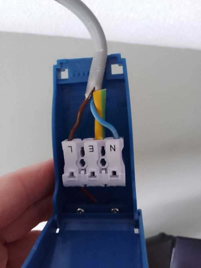

How do I get the wires out of this terminal block?
27 Jan 2024
7
How are the wires supposed to come out of this terminal block? I've lifted the tabs and I can't see/find any screws. I'm pulling on the wires but they're not coming out. How do I get them out?
if you rotate them slightly from side to side whilst pulling gently they sometimes come out of that style of push in connector
I would agree - you ought to be able just to push down (hard) on each tab and pull out the wire, do one tab at a time.
How high are you lifting the tabs?
Yes Push the levers down and hold them there in the pushed down position whilst you withdraw the conductors with minimal effort. Once they are disconnected you can release the levers.
To put a new conductor in you push down and hold down the lever then gently push the conductor fully in, then release the lever.
Hey presto.

I think that there actually are some levers that pull upwards whilst other levers push downwards so you could actually have either type, hope that helps.
Hey presto.!
If the conductors are solid you can just push them straight in, without touching the levers.
