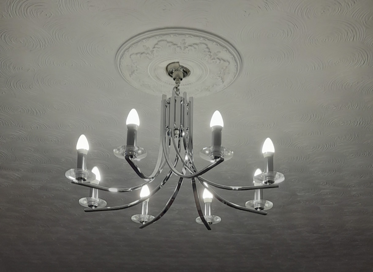

My ceiling roses state "Maximum safe working load using hook provided 5Kg" not sure I would want to lift a 5 kg chandelier into place 20220415_000328_1.jpg this one is hard enough. For me if not plug in would be impossible. But at £21.85 at toolstation they are not cheap.
My ceiling roses state "Maximum safe working load using hook provided 5Kg" not sure I would want to lift a 5 kg chandelier into place this one is hard enough. For me if not plug in would be impossible.
I have many of those, but I don't really understand what they say about 'weight'. I'm sure that these (solid brass) things themselves could hold up an awful lot more than 5kg - it's surely its attachment to the ceiling that is the potential 'weak point', isn't it?
Anyway, returning to context, as I said/asked, have you ever seen anything remotely as heavy as that chandelier which is supported only by a B22 'plug'/lamp holder?
