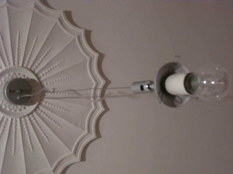

Hello all, a quick query that I haven't found elsewhere (probably because it's so obvious). I've just had a ceiling/rise and fall pendant light installed but I wasn't at home at the time so I didn't know at what height it was done. Can someone please explain how I adjust the height of the cord? Do I have to get inside the cover plate to fix the slack of the card once I've chosen the right height? Any help would be much appreciated! Thanks. Marc

There's a sprung loaded coil for the spare string, and inside the 'rose' (just a cover that slides up the wire), there's a friction adjustment in case the luminaire doesn't stay where you put it, or is too stiff.
no such German efficiency for mine unfortunately, the cord doesn't budge when I try and push it up.
When you take the ceiling rose down what is attaching the cord to the rose?
Is there a screw pressed against the cord or something?
that would be the tiny screw clearly visible on the right hand side of the cone shaped bit in the photo..

The light in the photo - if the steel wire was made shorter, I'd have concerns about the length of the electrical wire. Unless there is space to accomodate it within the dome of the fitting.
Weird. Do you have a link to the place it was bought from? The photo looked like there was a second support cable, but I suppose that's a shadow. If it really does rise and fall, the support cable has to disappear into either the top or bottom fitting. Looks like more room in the top one. It it were me, I'd undo those knurled screws and look inside.

That looks like it's a fixed light fitting.
Unless the mechanism is in the lampholder end, which I doubt.

It looks like an Ikea fitting.

thanks for all the responses - I'll try and unscrew the knurled screws at the top. As for instructions, they're minimal and don't talk about it. Link to the site where I bought it from is below - it refers to the max drop which suggests you can reduce the drop (I hope.....)
http://dwell.co.uk/107329/Sliced-plate-pendant-light-silver
That site appears to refer to rise and fall lighting as 'adjustable height' and only one of their products is called that. I don't think that what you have bought is a rise and fall light. :(
