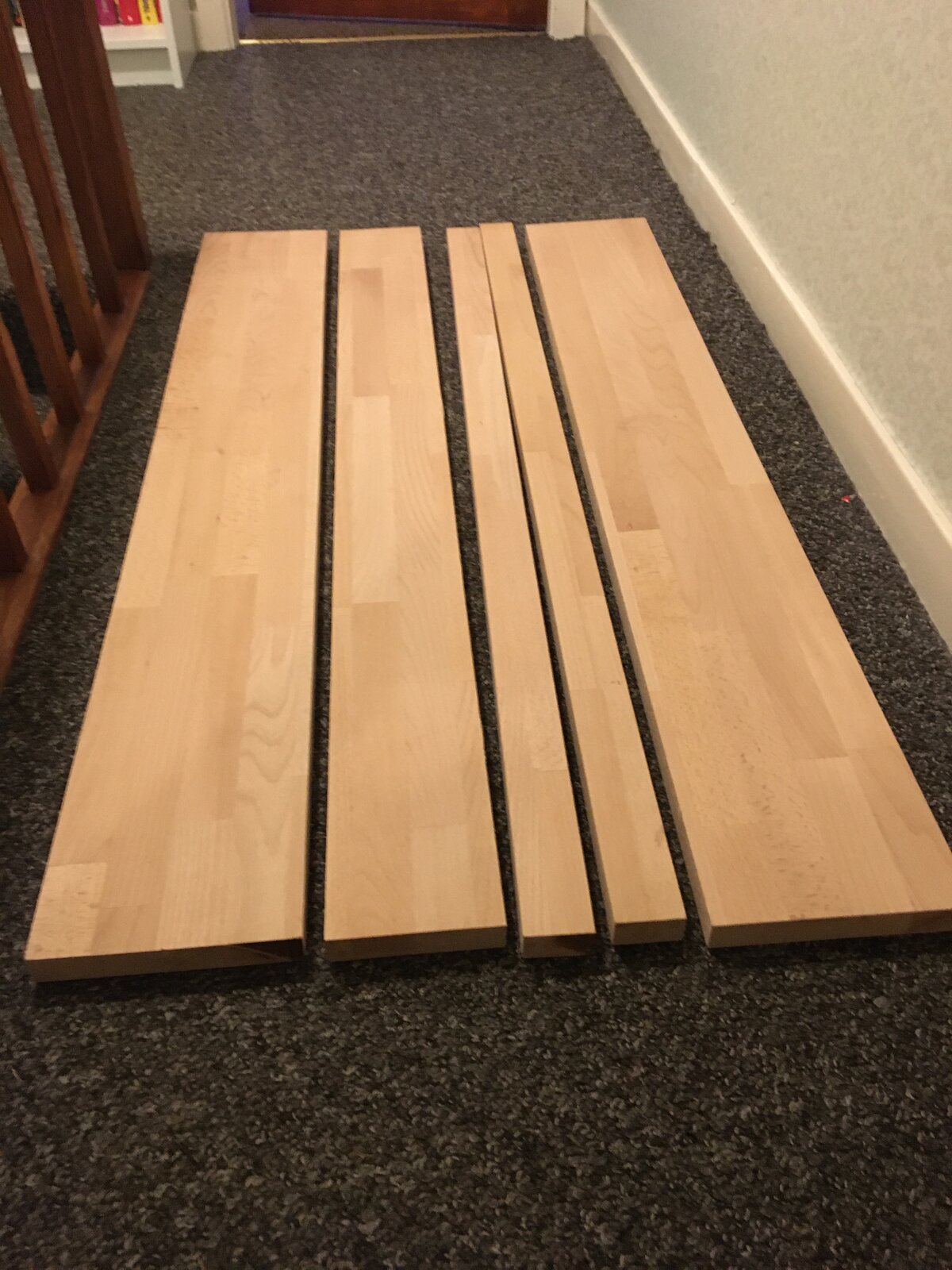

I would like to join some solid wood pieces together to make a desktop.
I have some left over pieces of solid oak wood top which had previously been cut into pieces (don't ask). I would now like to use the wood to make a desk. My question is what is the best way to join the pieces together to create a solid desktop which I can attached legs/frame to to make a desk?
My first obvious thought was glue but assume this would not be strong enough. What is the best way to create the solid desktop? I have very limited woodcrafting skills and tools.

One way is to joint the edges of the boards with a "Biscuit Joint System" + a decent wood glue.
Can I also suggest you organise your boards as Wide, Narrow, Wide Narrow, Wide.
You will also need some method [there are several] of "Cramping" the boards up tight together.

Wood glue is immensely strong, and biscuits are more for alignment than being required for strength. Clamping them up properly (having evenly spread the glue) is the most important thing.
I would stain the narrow strips before assembly to give it some visual interest, and make a feature of the fact that it's 5 strips of wood rather than trying to pretend it isn't.
one other small thing is try not to get the glue on to the face of the timber, it may stain the surface, OK not a lot but??

You'll be needing a set of sash clamps for this. You can buy just the heads and then bolt them on to some basic sawn timber and they'll come in handy for other jobs too. (They can also be mounted 'back to front' for pushing apart rather than clamping together). They used to sell these in machine mart, but I can't see them right now.

The easiest thing to do is to put a couple of strips of wood underneath and screw the planks on it.
Using the correct length screws from under what it will be the desk, it will all look neat.
Then of course biscuit joining would make it perfect, dowels not so much.
I would look at something like cascomite cleaning it of the face immediately. Also a plywood patress, drill holes (about 8) and countersunk either side of a centre line at right angles to each other in which to draw the two sides together once jointed.

I've got three 36" clamps which should do the trick
This was my initial line of thought. Glue and then a strip of wood on the undside keeping in together.
Why do you not recommend dowels ? I have very little experience with woodwork so assumed biscuit joining requires an expensive router? I just saw you can buy kits like these https://www.screwfix.com/p/erbauer-biscuit-jointing-kit-47mm-4-pcs/65290 I'm wondering if these are as easy to use as the hand dowel jigs
I should have looked at the photo woops yes as someone already said clamp and glue and you can tap the joint with a block and hammer to get it just right

Dowel joining is never perfect, so better to have a more rustic look and let the planks fall wherever they fall, but it's a matter of preference.
Biscuit joining makes them perfectly aligned, but for one project i wouldn't spend money.
Unless you want to return the tool after using it which i strongly disagree with as it is immoral and maybe illegal...
