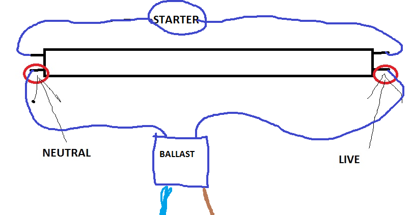

The 3 photos show the wiring pretty much.
Lets follow live on its path through the circuit.
Wires come in from power cable and into terminal-block-1.
Live goes into another terminal-block-2 and into the magnetic ballast. (brown wire)
Then out of ballast and back into terminal-block-2 (brown wire)
Then to the right end tube pins (blue wire)
Then to the left end tube pins (blue wire)
Then to the starter (blue wire)
Then through terminal-block1 and back up to power cable. (blue wire)
Not all tubes are like that though. Some have L & N at one end and disconnected pins at the other. So you may need to check if there is a diagram on the tube itself.
If the OP's tube works with the starter removed, then it suggests the connections are at each end of the lamp, not both at the one end.

No, this is what you have right now....
That's not how its wired now, the neutral goes straight to the fluro lamp pin, only the live passes through the ballast.
All this is irrelevant anyway just join the two browns together and remove the starter wiring completely - job done!
Yes, I stand corrected, was rushing to send a reply.
Thanks guys, I managed to bypass the ballast last night as explained by connecting the two brown wires that were going in/out of it.
Seems to work.
I have no idea why this was necessary, I guess it reduces power consumption slightly at least.
