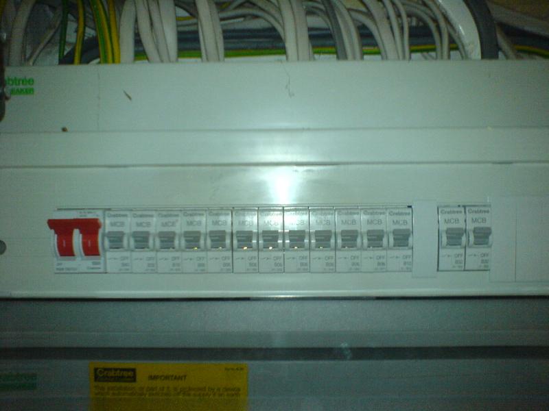

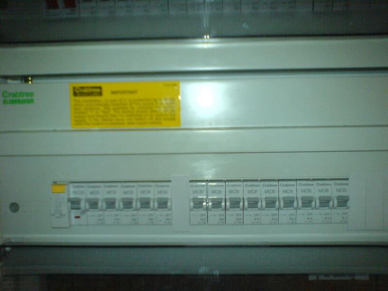

here are some photos of what I've got.
This is the CU with what I think are the RCD circuits:
And this is the other one with the main switch (and no yellow test switch):
They are.

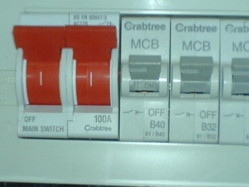

They aren't.

Take a look at the diagrams here: //www.diynot.com/wiki/electrics:bathroom-zones and tell us where the light and the switch are....
