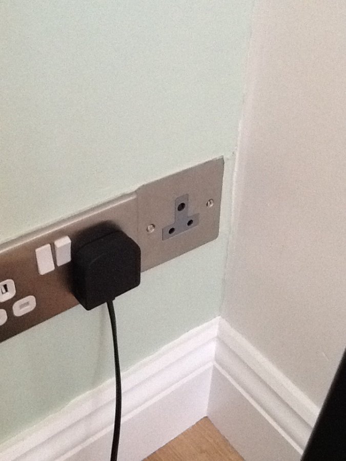

As explained in the earlier posts, and shown in photo above, my initial intention was to remove the 3 pin round sockets, but I decided against it and replaced the original tatty white ones with brushed steel ones to match the other power sockets I've changed.
I'm now in a position to start using the round pin sockets, and have bought some round pin plugs from screwfix - 5amp, no fuse.
The two lamps I want to use have 3 pin fused plugs on - do I simply cut these off and replace with the round pin none-fused plugs? Why do the round pin plugs not need fuses?
Photo above shows the current set up, with the lamp plugged into a normal power outlet, which I'll free up by using then round pin socket.
Any help greatly appreciated! :)

Because round pin sockets are normally protected by the MCB/Fuse for the lighting circuit from what they are fed off. Otherwise the round pin sockets should be protected by a FCU with a fuse ratting no higher than 5 Amp.
You may also be able to get a 5 amp round pin plug what is fused, but I have never seen one myself and don't know if they even exist.
Because they (should) be on circuits that are adequately fused not on 32 amp ring finals. Plugs in most other countries don't have fuses for the same reason.
They are available - I think they are used in hospitals, though I'm not sure what for. However note that they are made to an earlier BS spec. dating from the 1950's and don't have sleeved pins so would not be compliant with the regs for domestic use:
