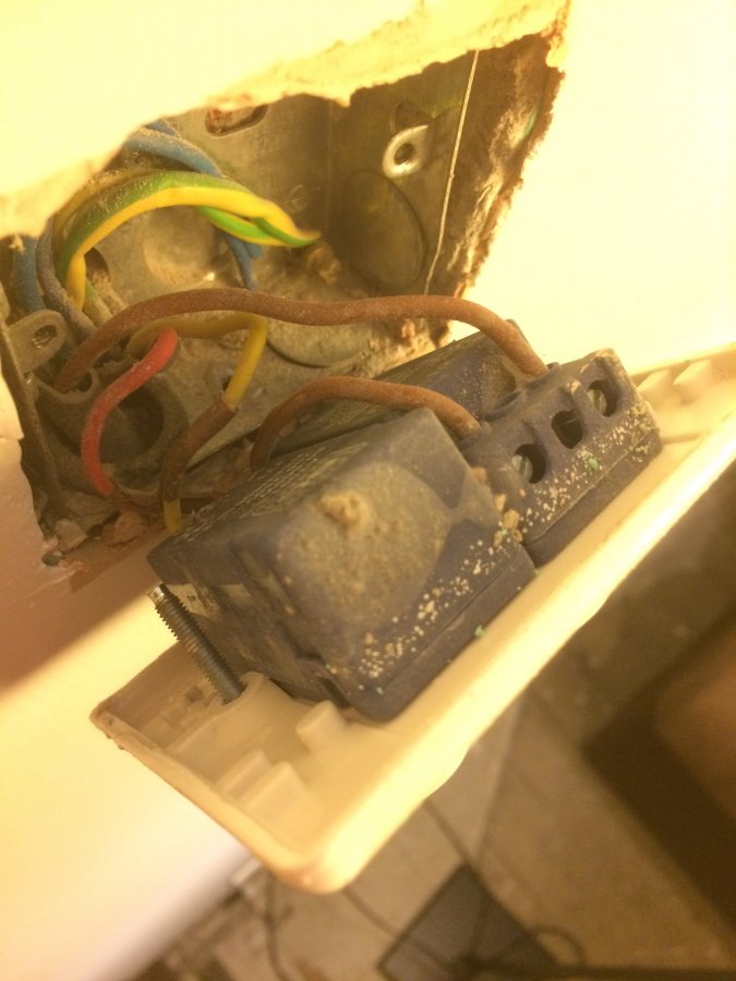

Just had a look and they do run off the other switch, picture attached.
Can anyone explain how this is wired up to me? It seems there is a switched live (red brown sleeve) and also a yellow wire with a brown sleeve coming in on it too? I presume the two brown wires take the live to the other switch to run the lighting sockets.
Sorry for the terminology I'm still a novice in the DIY game! :)
