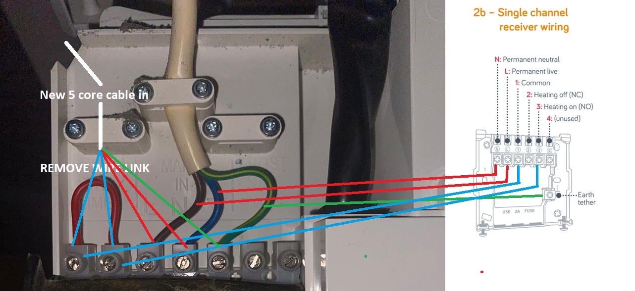

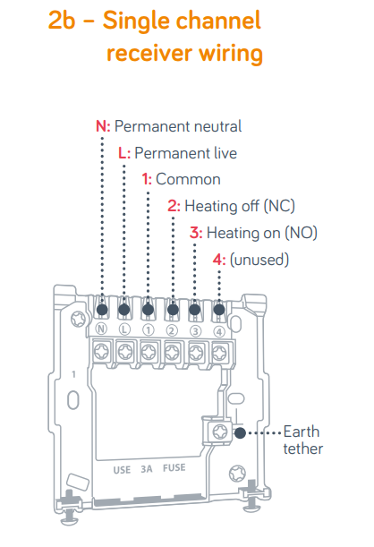

Hi Guys.
I have seen few posts on here and other places but could not fit one to my system .
The house doesnt currently have any thermostat or heating control system connected , so its a fresh instal of a Hive Receiver which I have purchased and althought I have some DIY experience and this seems straight and forward I wanted to ask for some advice to let me know how to connect it. I have 5 core cable ready and the image of the boiler wiring is attached. Im aware I need to remove red link wire .
Thanks for all help !

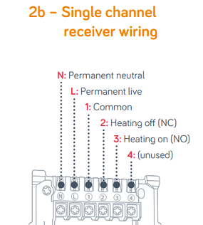

Thats exackly why I wanted to post new thread as I have seen people making links between common and live and I wasnt sure why
I understand that earth wire also goes to Hive earth connection so will have following : Neutral , Live and Earth going to coresponding connections on Hive plate + 2 cables from room stat slots on the boiler connected to 1 & 3 on Hive plate. Does this makes sense ?
So I have done a simple wiring diagram I want to complete , can I have some advice please if thats correct or not ?
Hopefuly its self explanatory , 5 wires goes in to boiler connection slots and to hive plate on the other side
Thanks a lot for all help
You can do if you want but it is not doing anything, it is simply somewhere to park an existing earth wire, the hive is not earthed, wont do any harm connecting it though and yes the rest looks fine

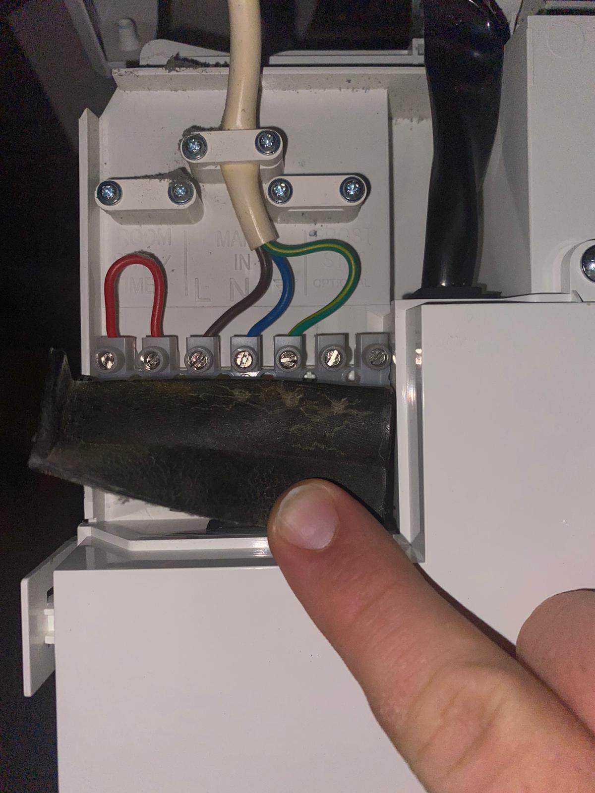

Hi, is the boiler your using an ideal Logic Combi ESP1 35 ?
On your pic the existing wires are the ones for the existing stat which get removed, correct ?

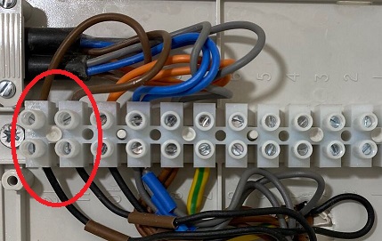

Hi guys, I have been to my sons apartment and it definitely has 2 zones with 1 controlling the master bedroom and the other the rest of the apartment.
I have looked at the wiring centre which is in the utility cupboard and the boiler is in the kitchen area.
Anyone able to work out which wires are the ones I need for the Hive please?
Thank you.

The highlighted black wires below are the switched live connections from the two room thermostats.
The two sheathed cables that include the black wires in the highlighted terminals above should be disconnected completely. These should be the two cables that go to the room thermostats. But please check to make sure.
The third cable connected to the bottom set of terminals ( 10, 9 & 8 ) goes to the boiler, that should be left in place.
Once the existing thermostat cables are removed. The Hives (single channel versions) are connected as follows:
Hive Receiver for Zone 1
Hive N = Terminal 9 with the blue and grey wires in
Hive L = Terminal 8 with the grey and brown wires in
Hive 3 = Terminal 11 with the brown wire to the motorised valve marked Zone 1
Link together Hive terminals L and 1
Hive Receiver for Zone 2
Hive 3 = Terminal 12 with the brown wire to motorised valve marked Zone 2
The above is based on the top left hand cable that leaves the wiring centre going to the valve marked Zone 1, and the cable below it to the valve marked Zone 2. That's the way it looks to be to me in the photo, if it's the other way around simply transpose the above.
Earths go to terminal 7 as now.

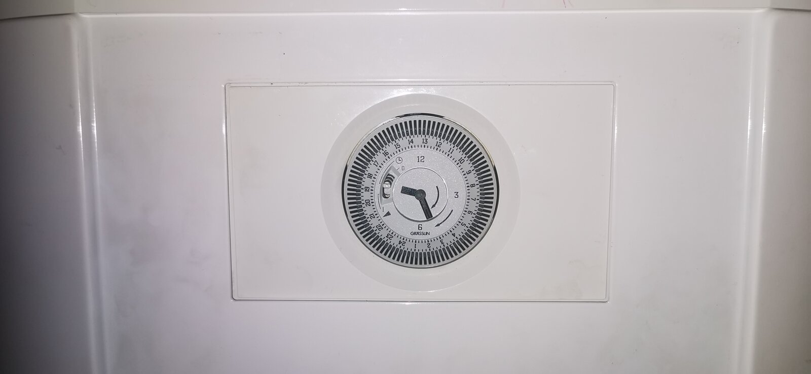

Hi Guys
I have finally found time to connect it all , although the hive is connected and all devices work the boiler doesnt start the heating and the message is displayed: Timer or Room Stat off . Is it because I have the analog timer in front of the boiler connected ?
The heating works when operating the manual timer just not by Hive
Any ideas ? Should I disconnect the manual timer or do I need any link wires in the hive plate ?
Thanks in advance
