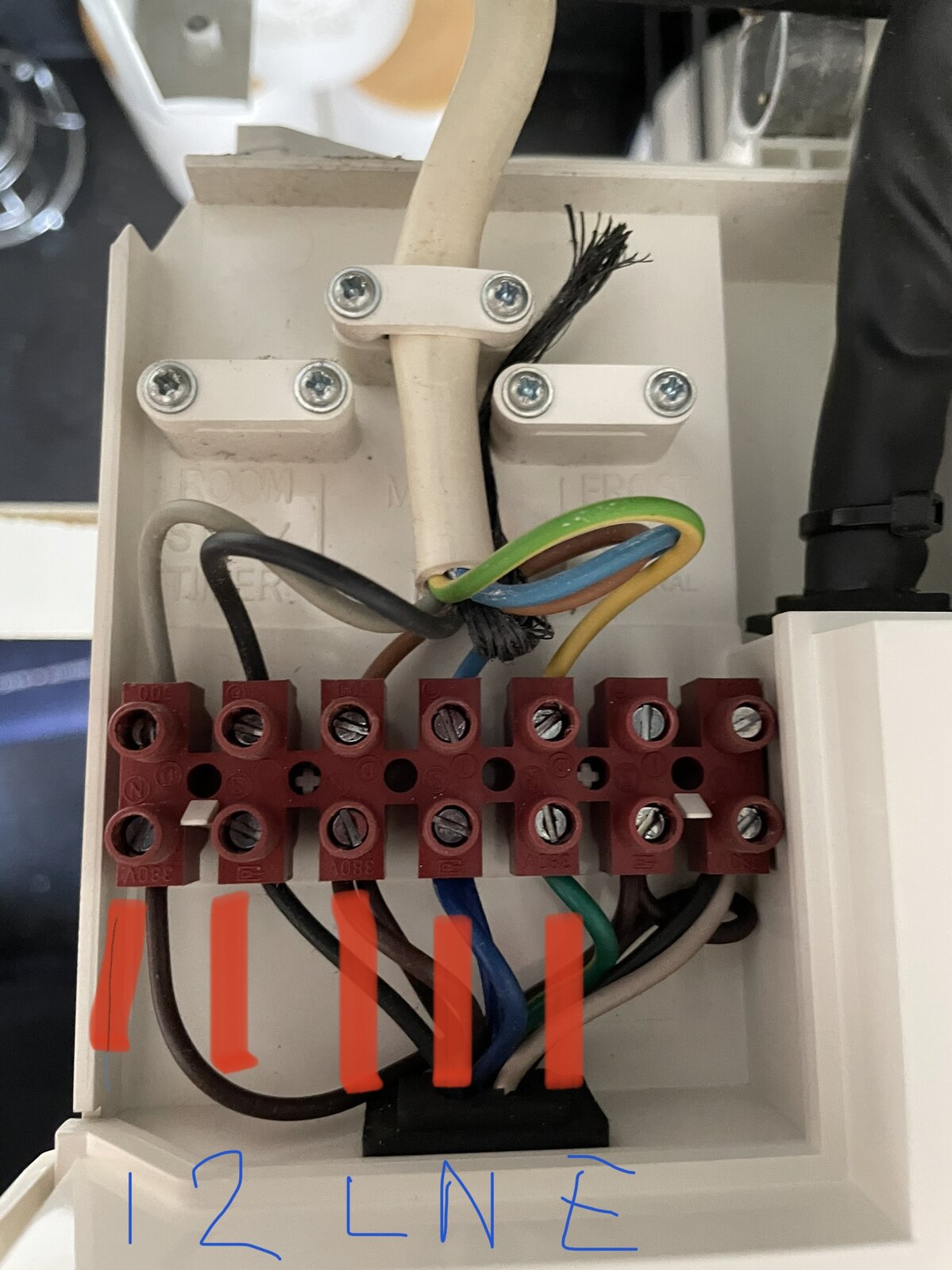

Sorry to jump on this thread but I have a combi logic boiler with 2 off (two zones, lounge and rest of house) honeywell cm707 controllers and I want to convert to hive, I'm assuming it's pretty much straight forward if not similar to the original thread from Szemko. Question is the cables that are connected to the honeywell controllers do i just link them out and push back into the cavity?
Many thanks for any help
The cables that are connected to the Honeywell controllers do I just link them out and push back into the cavity?
You don't link them out, you completely disconnect them, and then run new wires from where the thermostat cables originated from to the new Hive receivers, plus a new 230V mains supply [CM707's are battery operated]
Ideally unused cables should be removed, but this isn't always possible. Once they cables are completely disconnected at both ends, you can push them back into the cavity
Thanks for the reply. To be clear I was going to run a 5c flex 1.5mm from the hive box to the boiler (see attached photo) LN + E and use the black and grey cables from the hive until and put them into 1 and 2 on my photo,I’m assuming the current wires connected need to be disconnected?
many Thanks

As per your other thread. With a multizone system there are usually motorised valves controlling the two zones and the Hives open and close the motorised valves, so they are not connected to the boiler. It's the motorised valves that control the boiler, so in a multizone system the wiring at the boiler doesn't change when Hive is installed. I suggest going forward, that you add any further posts to your other thread, and not this one. Having two threads going on the same topic can get very confusing.
