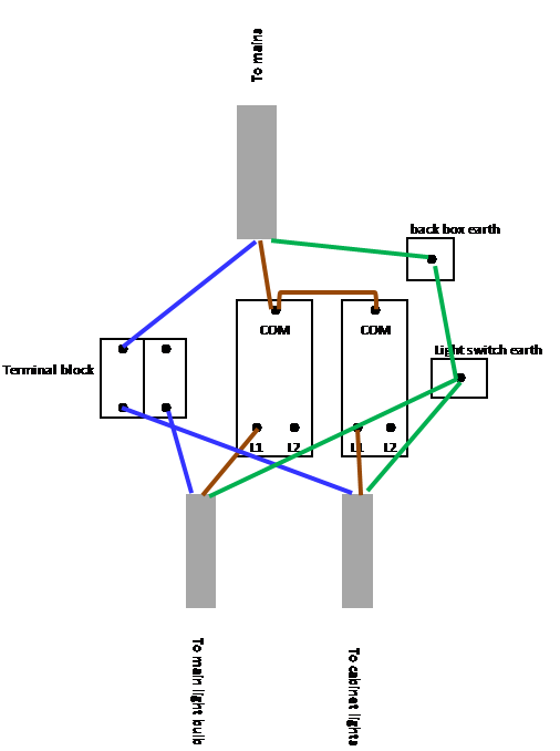

This is how I have set up the wiring:
Are all three neutrals joined together? Your picture makes it look as if the neutral to the main light is not connected to anything.
Nothing wrong with the supply to the LED though, if the other wires do what you think they do.
No, to be fair the neutrals are not joined together, but the main light bulb is working fine. Only the mains neutral and LED neutral are in the same terminal. I can change that.
When you say, "if the other wires do what you think they do", can you please explain? The transformer only has live and neutral and they connect to the light switch (above) via a junction box, live to live and neutral to neutral. So it is a like for like linkage.
As regards the lighting circuit (mains wire to breaker) it is per the picture above and feeds into the lighting circuit loop as per normal.
It shouldn't be working if its neutral is not connected to anything.
The fact that it is working suggests that it is not actually wired as you've described.
How do you know that the cables you've described as "to mains" and "to main light bulb" do go there?
The wiring to the switch is exactly as described.
The wiring to the main light bulb is old, which is perhaps where your doubt is. But it does work as described. We could not re-wire the main bulb due to access to that wiring. Instead we linked it via another junction box from old light switch (now boxed in and isolated), again like for like. But to be honest that is not relevant to the LED set-up, which is the issue of this thread.
The mains lighting circuit loop is as described because that is 'new'. It is a spur from the lighting circuit. Which is new wiring set up (certified under building regs when we did extension)
So in conclusion we have new wiring running from switch to mains lighting circuit (spur). We then have new wiring going to the LED transformer via a junction box. Lastly we have new wiring going to junction box for main light bulb, joining old wiring set up.
