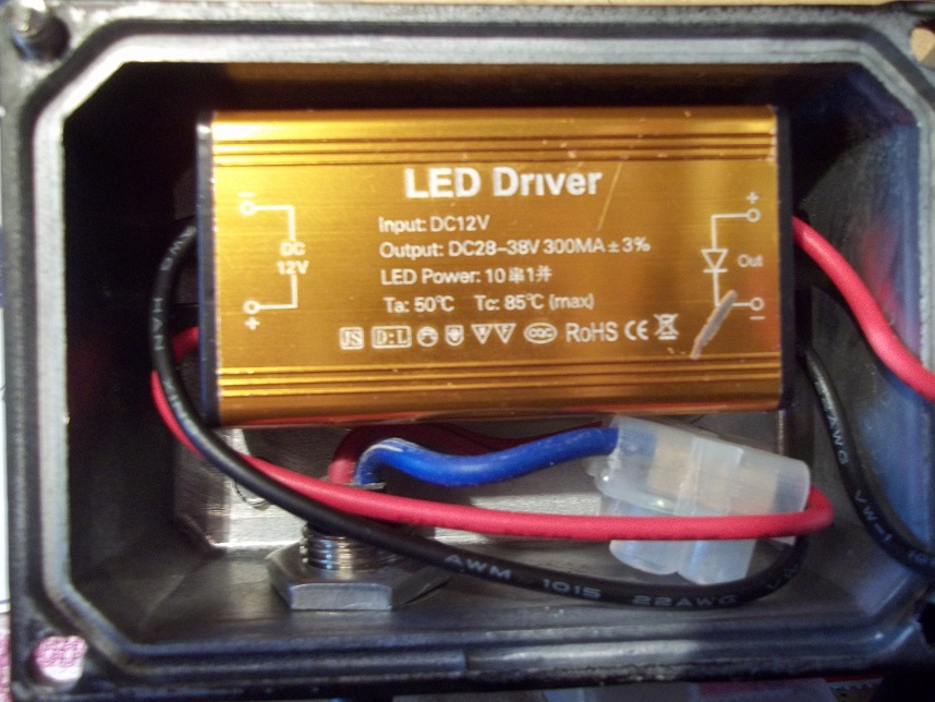

The current source ( The LED driver ) is an OEM product used in 12volt 10watt LED floodights. as in picture
The dodgy 12 volt power supply is a metal box 70mm diameter and 55 mm long. Appears to be completely filled with potting compound. Not worth the effort to take it apart.The 4 leads mains in and ELV out come out through the same hole so I suspect isolation mains to ELV is less than adequate. Not bought in the UK so no point in taking it any further other than crush and recycle.

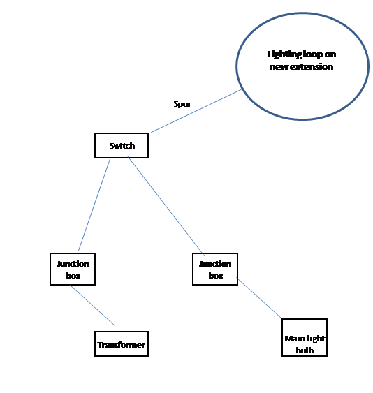

It shouldn't be working if its neutral is not connected to anything.
The fact that it is working suggests that it is not actually wired as you've described.
How do you know that the cables you've described as "to mains" and "to main light bulb" do go there?
Please see basic drawing below for wiring
Your main light shouldn't work without a neutral. The fact it is "old" doesn't change that.
So something weird is going on there.
Try putting a plug back on your transformer and see if that works.
