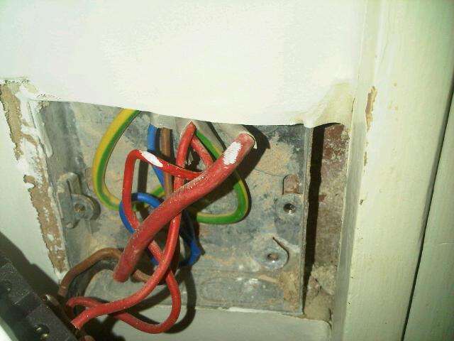

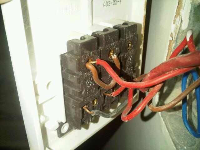

For the UC lights he has run T+E to the switch. He has only connected up the live, the switched live is unconnected as yet (cables of lights are in position and taped up).
So is there a neutral at the switch?
I have only just reached the stage of attaching the under cupboard lights and therefore only recently taken the face plate off the triple gang switch. I found that the two (old) feeds for the ceiling lights comprise: one cable with three cores (red, red + yellow/green) and one single core (red, sheathed in black); he has linked the COMS for the two switches. I'm now worried about this arrangement that it may not be compliant/safe.
That's one bit you can almost certainly stop panicking about !
If you refer to the wiki on lighting circuits you'll see that it's a common wiring arrangement to use either a junction box or the ceiling rose for the main connections, drop a live from there to the switch, and a switched live back up. Thus for a single circuit, you need a two core (normally + earth but always so in the past) cable for the drop to the switch. Where you have a double gang switch, you only need one extra core (for the second switched live).
In this case, the original electrician has used twin red cable which is unusual - most just use normal "T&E" and apply red sleeving over the black neutral core (current colours are brown and blue respectively). Some don't bother with the red (brown) sleeving even though this makes it non-compliant.
For the third core, the original electrician has used a sheathed single which is even less common that using twin red.
IMO, this probably indicates that the original wiring was done by someone who took proper pride in doing things "just right".
Having got your three cores down to the switch, the feed will be split to both switches (the link between the C terminals you mentioned. Then a switched feed from each switch goes back up to the rose or JB.
Hope that helps for that little bit. Pity the current sparky is a cowboy.

Hi
Thanks for your replies.
I have attached some photos of the cables at the switch:
[Note the switched live for the under cupboard lights (blue wire) has not yet been connected].
Securespark - sorry perhaps I wasn't clear (or perhaps worrying unnecessarily) but no there isn't a neutral at the switch (or at least I don't think there is). I guess I was concerned that the two switches for the ceiling lights may link back to different circuits (but on the same RCD) but take a live feed from the same circuit.
I feel reassured by SimonH2's comment about the cable arrangement (allbeit not about their placement) with a single feed and the two COMs linked.
