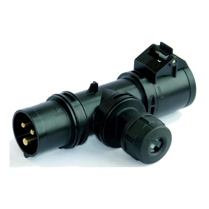

Blue and red types are increasingly being made in black for entertainment use.
Well, sort of, yeah..... its only the end caps, where the cable exists, that are black - the shroud around the pins is still the 'proper' colour. The idea is to help them become less obtrusive when used on lighting trusses and the like were the red or blue caps stand out from a mass of otherwise black cabling.

No, I mean ALL black, there's a few on here: https://www.bing.com/images/search?...56D409C8F07EFA27A3739C482FFE4472A&FORM=IQFRBA
No, I mean ALL black, there's a few on here: ...
Several of them have 'blue bits' - which I suppose might (I don't know) just about make them 60309-compliant for use on'blue' voltage ranges. However, if they're all black, depending on the earth pin position, they should be for:

I can promise I have handled hundreds of all black connectors which mate with blue and red connectors, some have blue or red inserts but not all.

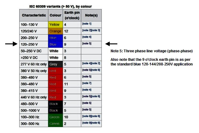

There are, per 60309, not meant to be any blue connectors which have the same earth pin positions as the black ones - the latter being 150°/"5 o'clock" or 210°/"7 o'clock".
Kind Regards, John
Kind Regards, John
I think the pic is clear enough where the earth pin is!
and on these two too although it looks like a red label which is likely to disappear soon.
I think the pic is clear enough where the earth pin is! and on these two too although it looks like a red label
All three of those appear to have the earth pin in the 180° ("6 o'clock") position, which means that they should be (as I think you have confirmed) mechanically compatible with the common 3-pin blue ones and 4/5-pin red ones - but that earth pin position is wrong (per 60309) for any black connector.
Kind Regards, John
Kind Regards, John
Indeed they are all in the same position, which is the reason I have taken the time to join this thread. As mentioned earlier I have handled a great many of the all black connectors and they have all, without exception, mated perfectly with reds and blues [and possibly some yellows too]. If this means they are non-conformist then perhaps the plug police need to be informed :)
Additionally I recall installing loads of blue connectors in a factory and they had about 6 different layouts to prevent them being plugged up incorrectly. IIRC the inserts in early plugs and sockets were adjustable and had a ring labelled 1H to 12H.

Fair enough. I'm just the messenger ... all I'm doing is stating what IEC 60309 says, and there should be no black connectors with an earth pin in the same position as blue or red ones - so one can but speculate about what that means in terms of all the black ones you have come across - can you recall if they actually claimed to be to IEC 60309 (rather than just 'similar' or 'compatible')?
