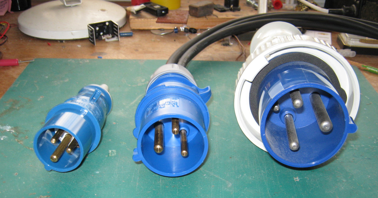

    Regarding those big industrial round plugs, are 16 A plugs/outlets the same size as 32 A plugs/outlets (i.e. would it be possible to plug a 32 A machine into a 16 A socket or are they incompatible)?

    No, they are incompatible although I have seen home made converters

    Different size, ISTR the 32A ones are larger than the 16A ones.

    Also there are same ampage but different keyed plugs/sockets for special applications

    Each current rating is a different size. So if you need to interconnect different sizes you will need to make or an adapter.
    Clearly when doing so you should consider whether the supply is adequate and whether overcurrent protection should be provided as part of your adapter.

    Examples of each:

    Mustn't leave out big brother!
