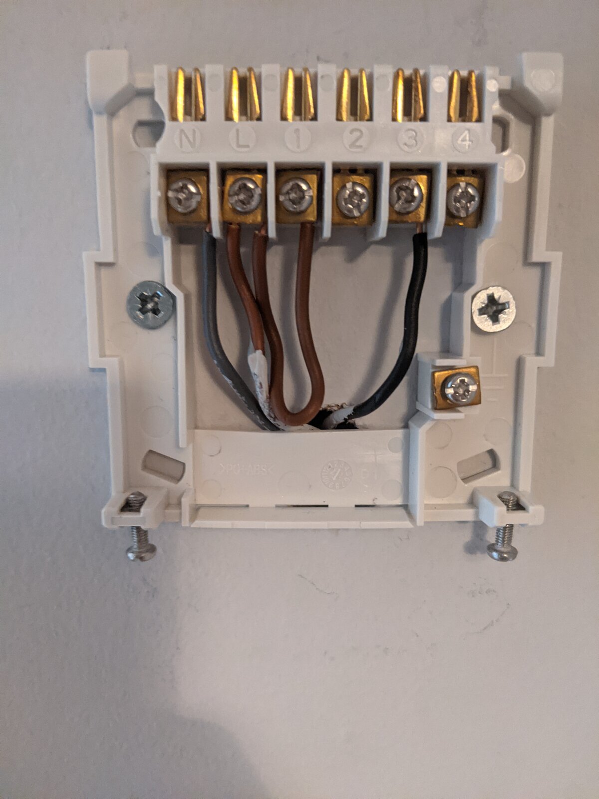

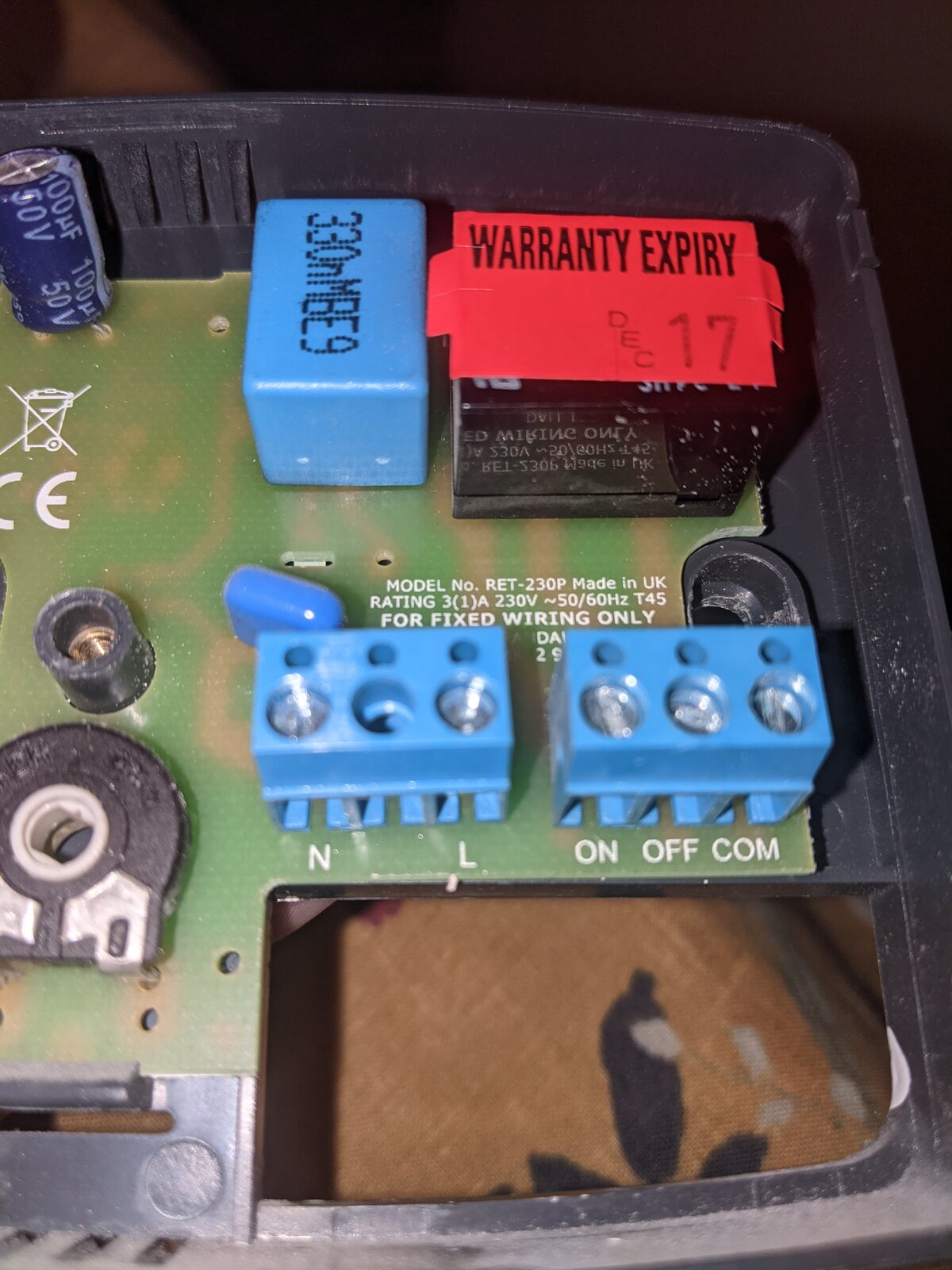

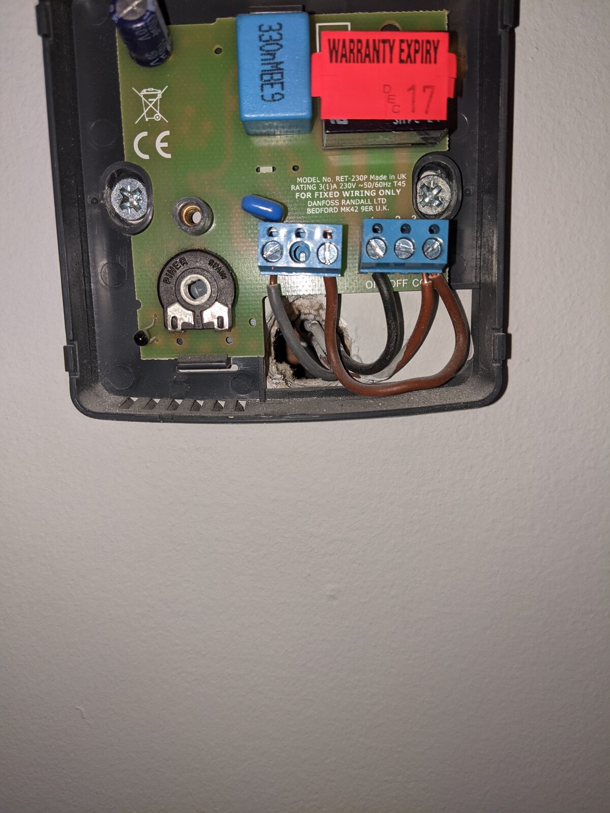

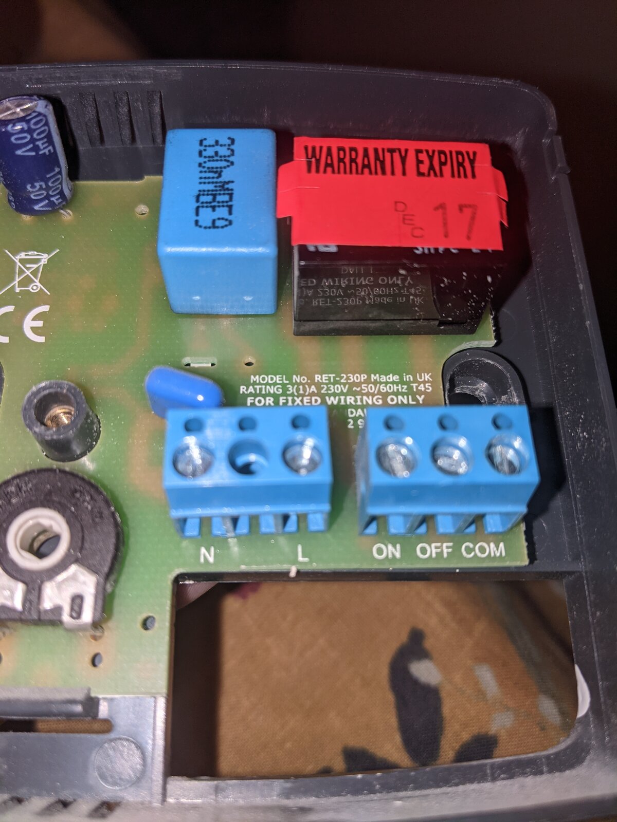

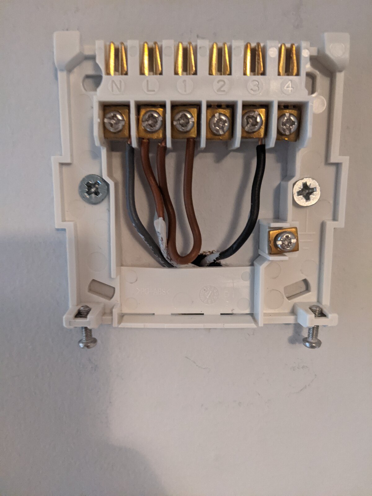

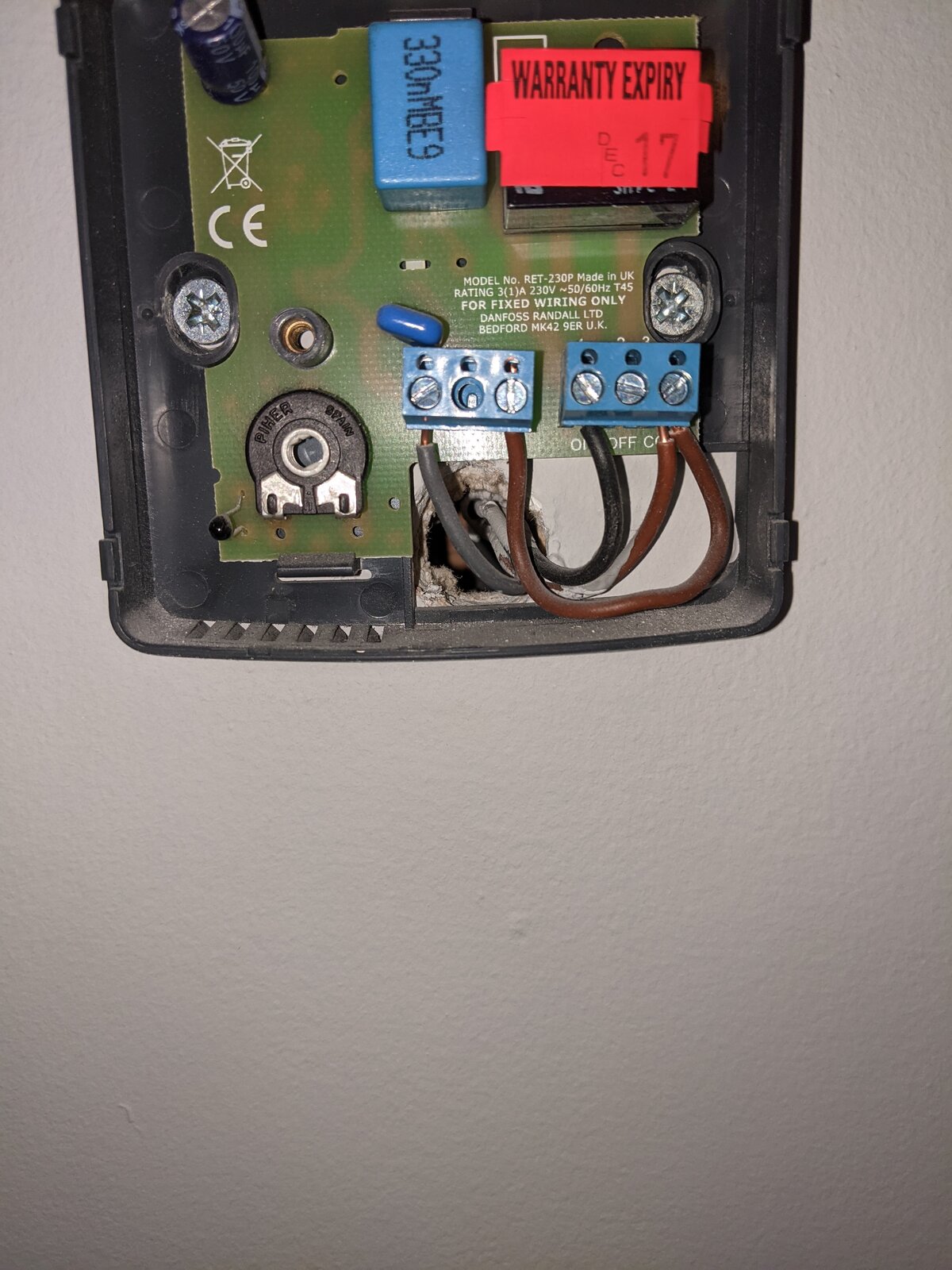

Alright! Making progress thanks guys. So I took the receiver out from the boiler and connected the wires back to the old thermostats.
They worked, heating on and off as usual.
Then I opened up the old thermostat and took a picture of the wiring to try and mimic it with the receiver.
This is how I hooked up the receiver and it didn't quite work. Boiler light didn't stay on, got a C for a while when I had the hive activated then turned it off and on and it got stuck on 0.
