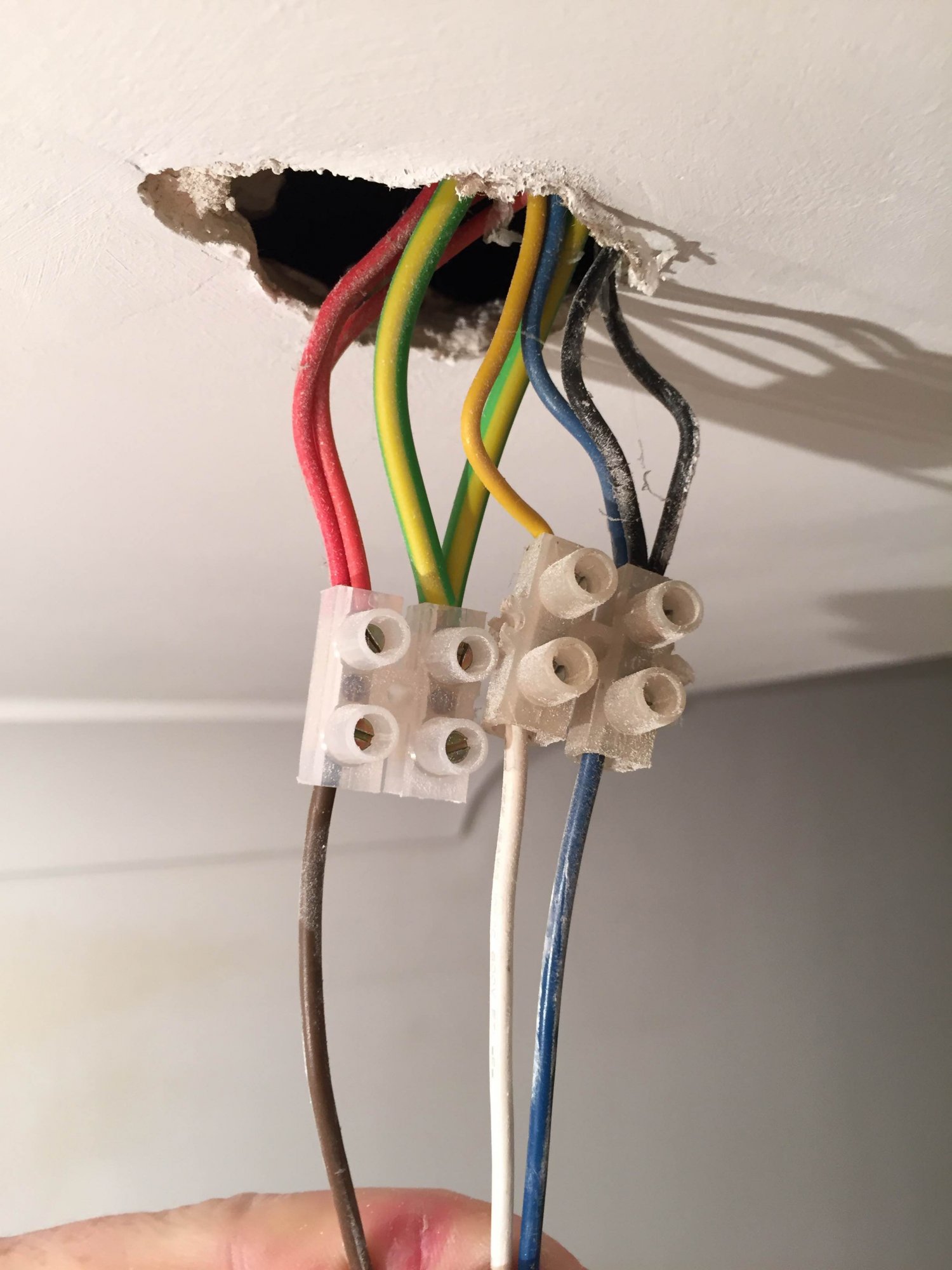

Hi,
I'm replacing 3 smoke alarms in my property, mains ones. The documentation for the new alarm says the I might have up to 4 cables coming into the alarm housing: Live, Neutral, Earth and Link. It says the 'Link' cable if installed is normally black.
I only have three cables going into the existing detector, brown (assuming live), blue (assuming neutral). The third is white! Logic would dictate that this is the Link cable, as you'd expect any earth connection to be properly marked and the old detector was all plastic so probably didn't need earthing.
If I disconnect the white cables from all three alarms, is there a quick multimeter test I can do to see if the white cables are connected to Earth or not?
Thanks!

Could do with pictures really!

Some smoke alarms were/are supplied with a socket connected to 3 wires, which were blue, brown and white. The idea being that the alarm has pins on the back which connect to the socket, and the wires would be connected to fixed wiring within the ceiling.
Other than that, not clear how such a wire colour combination could be obtained.
Good point - I was thinking about the fixed cabling, but perhaps that is what is being seen here.
It would appear you are correct! There were no pins, but I pulled the blue/brown/white cable out even further and look what followed. 2c+e coming in, and 3c+e going out with the extra conductor acting as the link. Seem like its good to go for a straight replacement.
