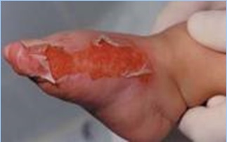

    This was NOT from an Intergas or combi boiler set too high but simply the burn you said didn't exist as you've not seen it.
    Hot water damage to human tissue; the regs were tightened regarding hot water supply a few years ago after two deaths of children and some serious eventually fatal burns to the elderly who cannot react quickly enough to get their bodies out of seriously hot water.
