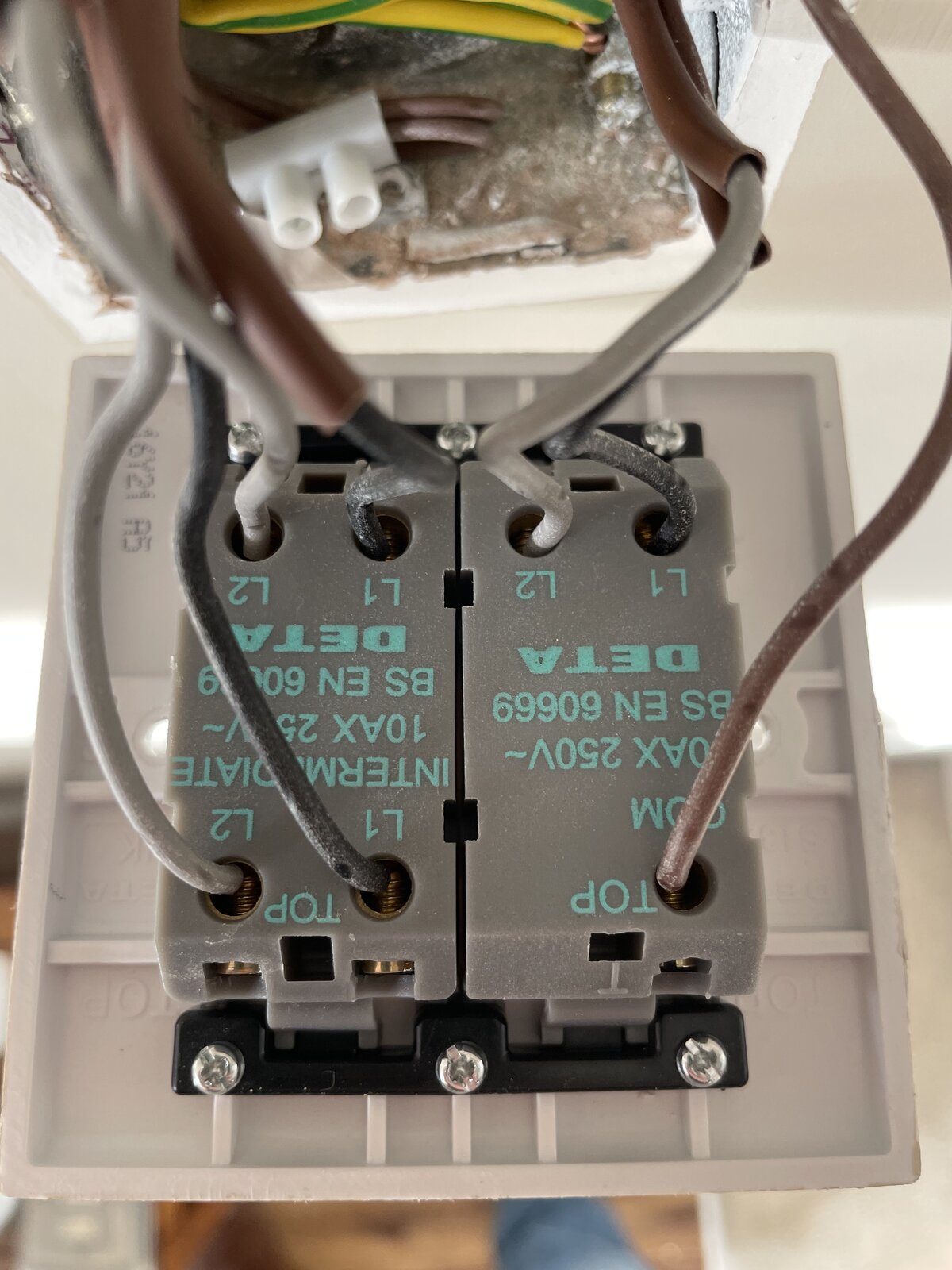

I have this switch as part of a 3 switch system for a lounge light . I’m keen to understand which contacts are made/broken with the operation of the switch. I will use a tester if needs be but wondered if anyone knew from the photo.
Also I’m thinking of changing the switches and doing away with one of the 2 way switches keeping the one at the location where the intermediate is and one other.
From the photo is it possible to identify what wiring I do away with to convert the intermediate to a 2 way paired to the remaining switch and what I may need to do with the abandoned switch

Right hand switch - Common to L1/L2. Left hand switch - Straight top to bottom / diagonal top to bottom
Without being technical, if you wanted to use the intermediate as a 2 way only, you would:
place the common brown into one of the top terminals, and put the grey in one of the bottom terminals, and the black remaining bottom terminal.
There are variations, I have tried to keep it simple.
Firstly though, you need to check that there aren't any cables you need to keep in the switch that you wish to remove.
Before offering advice can we have pics of the other 2 switches wiring, clearly indicating which one you wish to keep and which to 'abandon' and do you have any test kit to identify the cables at the intermediate.

Use the "Ohms Scale" on the multimeter (which you must have) to check the connections between each of the four terminals when the Intermediate/Crossover switch is in either of its TWO positions.
The switch either connects the contacts top to bottom. Or when switched it connects the contacts diagonally. (As per pic)
