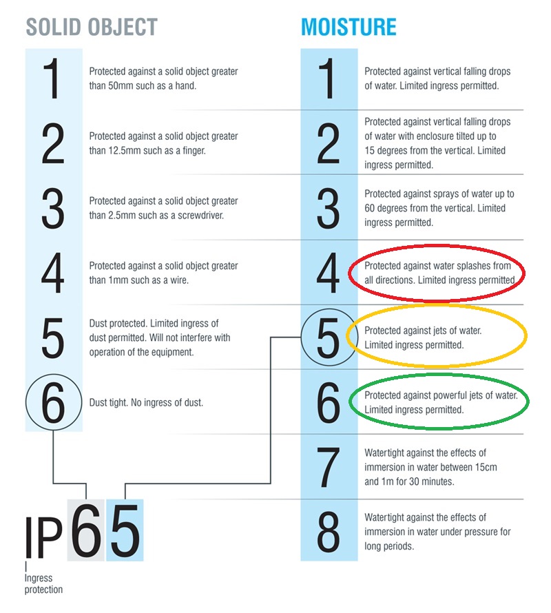

I disgree that IPx4 fittings are safe in Zone 1 where a shower spray head could jet water onto a lamp. IPx5 should be the minimum there.
IP 44 might be OK if it was only water splashes that could reach the lamp and the lamp can sustain limited ingress of water .
It's a ceiling light though, so you'd have to go nuts to start spraying the ceiling with the shower.
