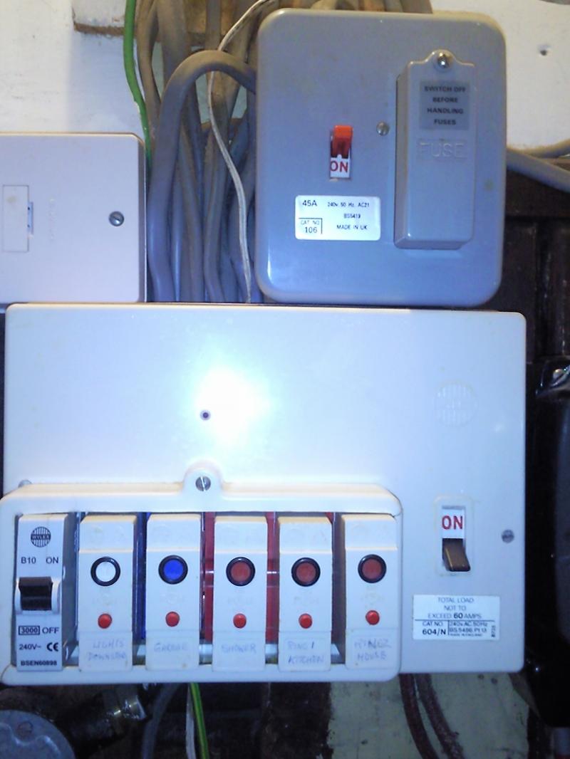

Am currently doing up my kitchen and wish to ensure the electric supply to my hob are is ok.
Currently, the 6mm gets to my hob via grey box above CU (45a). It powers only a hob at the moment via an isolation switch located in an inaccesable place below worktop.
What i would like to do ideally, is move the switch up to above the worktop and also use it to power a cooker which is a plug and play 13a single fan.

If the grey box is supplied from one of the 30A MCBs below, then you can replace the grey box with an RCD, and use the double outlet plate and socket arrangement behind the cooker, with an isolation switch above the worktop.
Does the 'shower' MCB just supply this cooker circuit, or is there a shower as well?
Theres a shower in upstairs bathroom. The 30a MCB trips the shower.
Im assuming that power to the 45a cooker radial has been supplied via the same outlet on the CU?
That to me sounds somewhat not right or even possibly dangerous?
I have noticed , on the odd occasion, that if the shower is in use upstairs and for example, the missus is using the hob to do sunday dinner with all the pans on it etc - the shower MCB has been known to open and cut the shower off.
It wasnt till this morning that i twigged that the current setup may not be quite right.
IMHO, (and i dunno how it would be done) but the hob feed should somehow be run seperate....i mean direct to the grey box and not via the shower MCB on the CU.
The shower and cooker should be on separate MCBs.
There is no space left in the consumer unit and even if there was, it would be no use since it would be overloaded.
One option is to fit a smaller CU for the cooker only, but you will then need an isolator fitted between the meter and the 2 consumer units to provide a single main switch.
What you have is no good, since both circuits must be at least 6mm, and there is NO way anyone could get 2x6mm into the terminals on a Wylex board like that. Probably find that the wires have been trimmed down to fit. Also possible that the contacts have been damaged by the excessive load.

Just had a look at the CU. Looks to me like there is two 6mm running from the shower MCB.
Obviously, one goes up to the shower and the other must go to the 45a fused switch box used to power the hob?
Yes that looks like it
I'll also point out the earthing conductors are not sleeved and also why are there two cables in the garage MCB (blue)?, one of which is black-all phase (live) conductors are red/brown!
If you look carefully at the main Neutral tail insulation (right hand side of picture) it looks as though it may be burnt/melted, although it may be just the picture quality.
Could you post another picture of the main switch area? Be careful round here and DONT touch anything since it is still live around at the top of the main switch even when off.

I noticed that too - regarding the garage MCB....dont ask me why its like that as its been like that since i moved in. What i do have in the garage is an old metal box with a metal lever on it to shut it off whilst inside the garage....perhaps its own little CU although rather old and i must say a bot rusty..its ok inside mind....big old fashioned fuse about 4 times the size of a plug fuse!
The tails themselves are old too.....they are covered in a kind of woven mesh orange looking in colour - presume 25+ years ago, thats how they were covered instead of PVC.
Yup, noticed too that none of the earths had sleeves, just bare! (good ole fashioned box this ya know! :LOL: )
What exactly dya wanna pic of? CU wiring with cover off? if your specific i can try get a better pic for ya's.
