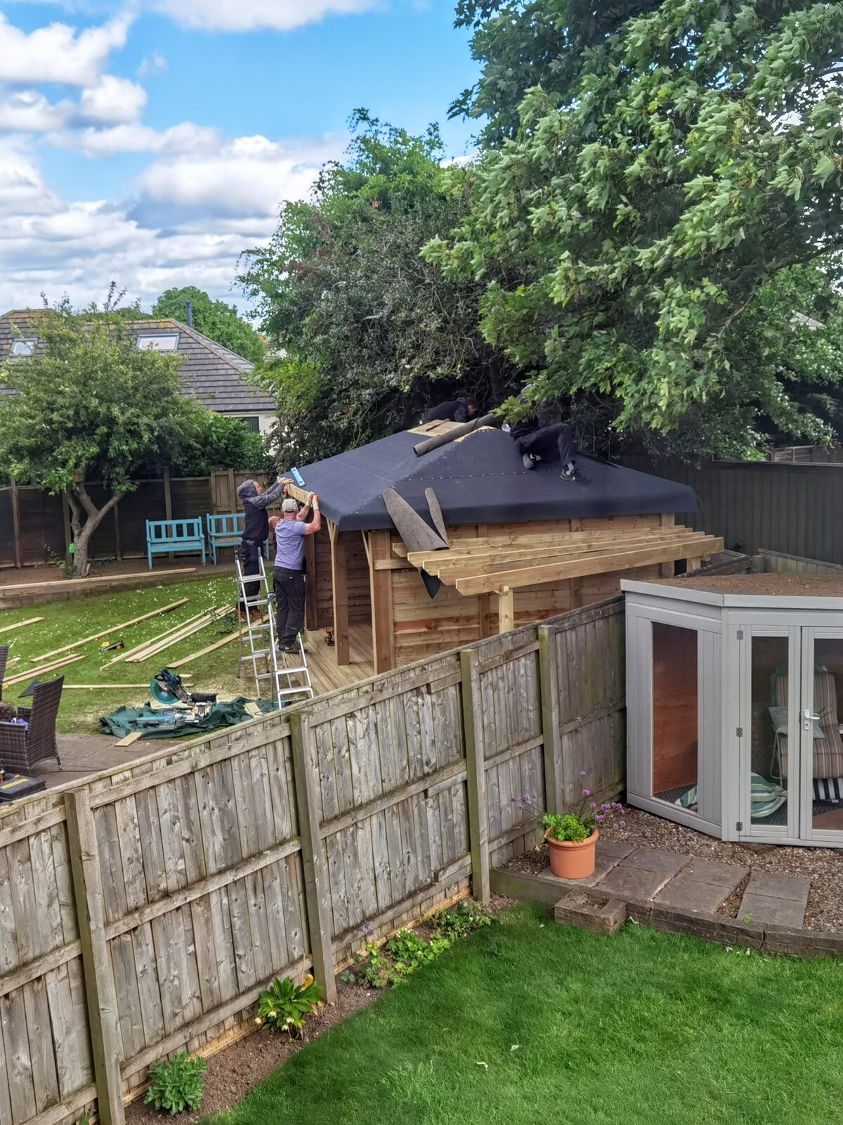

Woke up to this eyesore being built close to my boundary. From checking planning regs, it seems to say that structures should not be built on a platform, whereas this is, and if within 2 metres of the boundary, should not be higher than 2.5 meters. Not measure yet but to my eye it does look taller. Bit ****ed off as neighbour did not even consult me. What do people think?

IMHO it could be debatable position wise, there are rules concerning distance from the boundary and height.
It looks to be a good 3M? the guy is half a metre up on a ladder, and if he's 6 foot there's a long way to the apex.
The good news? is that the front looks to me to be intended as being left open.

It looks high, which is why I'm posting. Took elevated image to show how near to boundary
No, I don't think they are. Looks like the site is sloping so height will be measured from highest adjacent ground - looks like far corner. Bloke is prob about 1.8m, so looks like the ridge is ~2.5m. Looks like a fair bit is external floor area, so as long as internal floor area is <15sqm they can build within 1m of boundary in timber. It looks like it is within PD regs to me.
