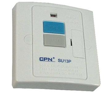

*My solution would be if it is a ring final and not a spur arrangement or a radial circuit, but has no RCD protection, would be to fit a 13A 30mA RCD protected fused connection unit at the existing blanked of box, then connect a new socket to that.
*If it is a whole ring (not spurred) or radial with 30mA RCD protection, you could either connect to it using a blank plate or even a 13A fused connection unit, the latter would allow for more than one socket outlet to be connected.

13A fused connection with 30mA RCD
