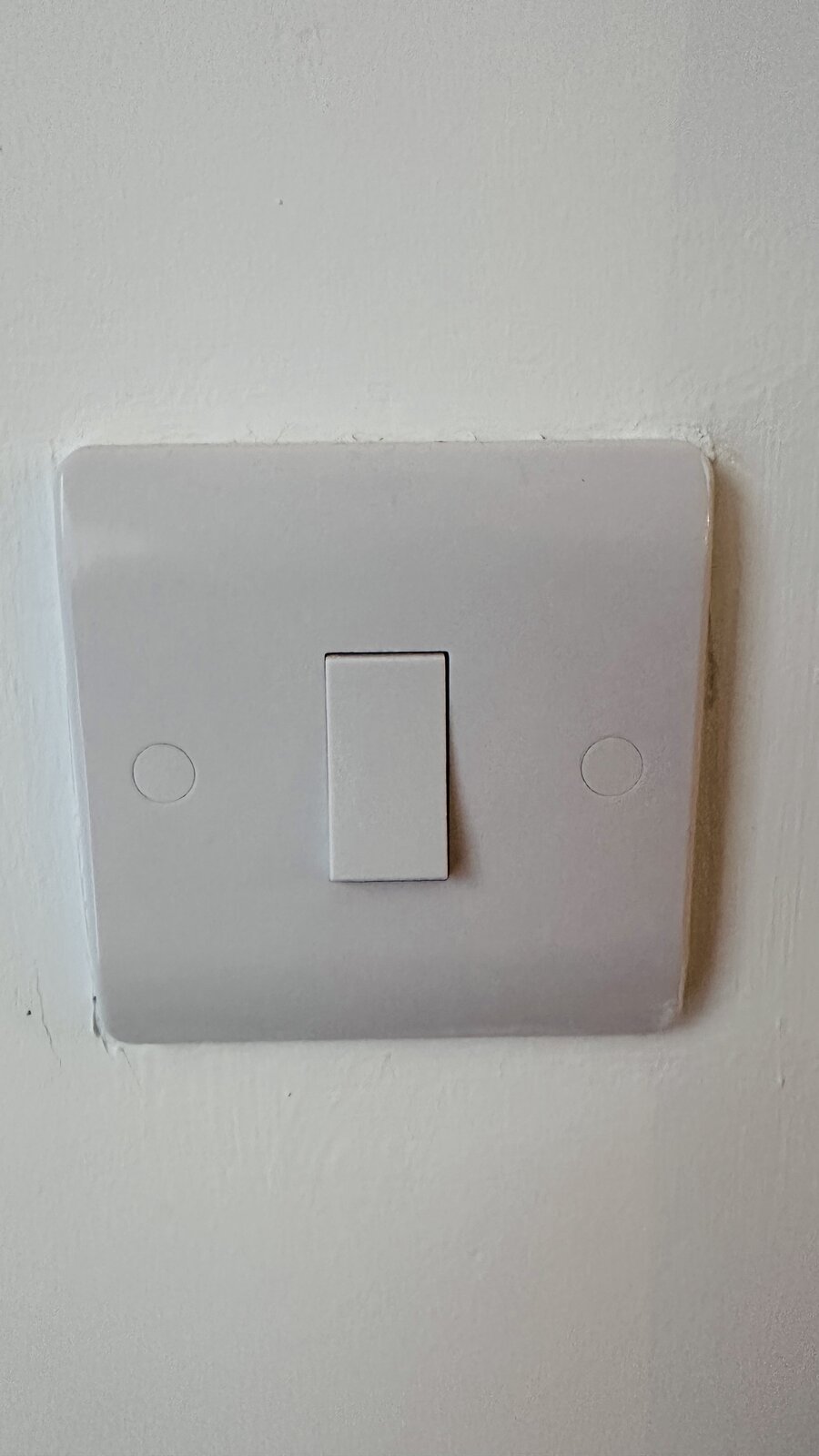

Hi guys, an age old problem of mine. It’s over way to remove the screw blanks without destroying them?
Insulation tape or blue tack sometimes works but not every time
Cheers Pete, I’ll give those a try
Yea that’s been my goto but it tends to kill the edges. Bluetac seems like the way to go.
If that is a click scolmore switch, give scolmore a ring and they will send you new covers for free. I hoook them out with the tip of a corkscrew and then fit new covers.
Good sticky gaffer tape would surely work.

If nothing else works, a little silicone on a nail head and leave overnight.
Then pull.
Although a good go with gaffa tape works 99% of the times.
